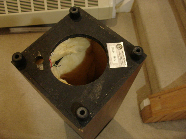

Hello planet10:
Do you mean adding ERT26 tweeters? If that's what you mean what value cap. should I use? I want to add better wire and remove the fibreglass. By removing the fibreglass can I replace it with the acoustic stuffing adding the same amount and located in the same area?

Hello planet10:
yes
- sorta depends on how low you want to roll them in - I'd suggest starting around 6K or so, and cause I'm lazy, I'd use something like this calcuator:If that's what you mean what value cap. should I use?

Hello planet10:
Have I asked too many questions?
Yes.
You'd have to play around a bit. I can't recall where EPI xoed in the MT2, i'd guess you want to look at 1-4 uF. I'm going to start with 2 on our CHP70.3 microTowers (after i coax Chris to rebate for them)
You can use well fluffed out polyfluff or UltraTouch or similar. You'll need to play a bit.As they are with the fiberglass they are probably a little underdamped.

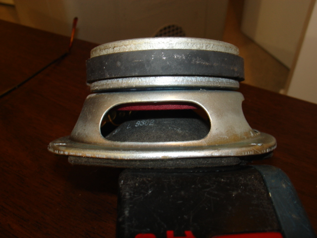

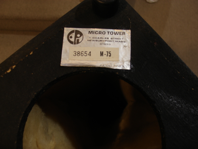

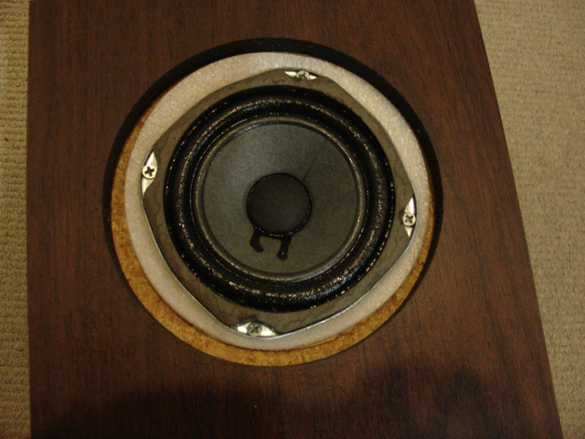

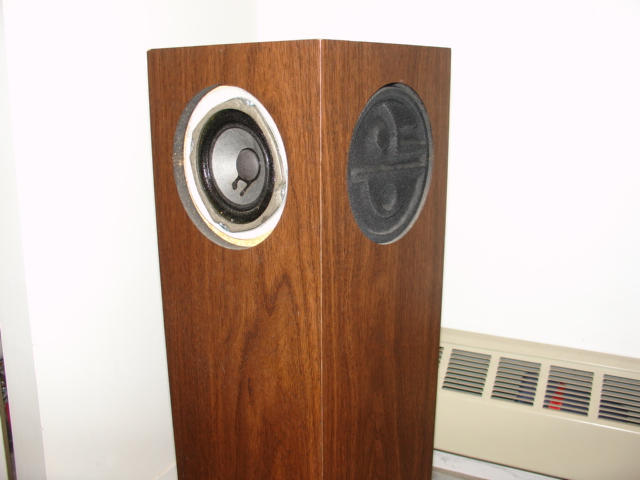

Here are the pic's of the EPI M-75
Peter C.
Numbers on the driver magnet? Square or round magnet slug?
dave
