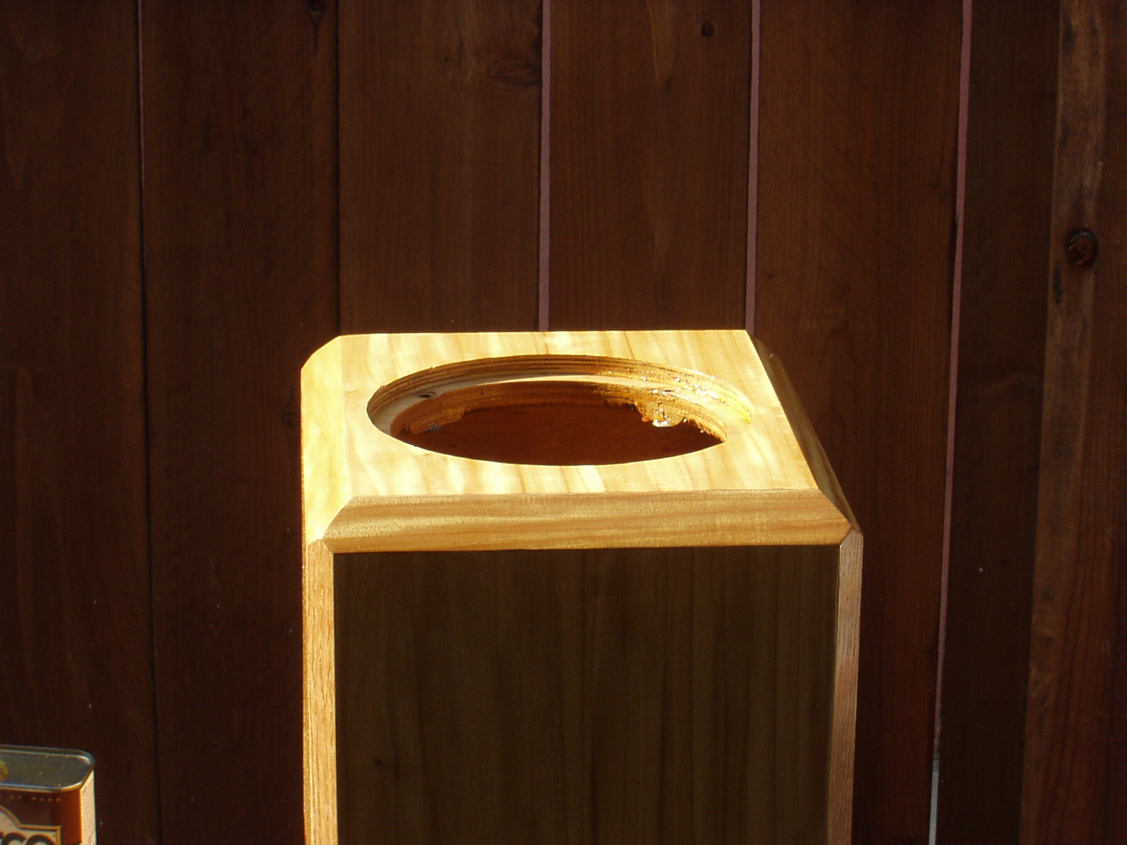

Where's the edge roundovers or bevels fellas? Are we operating on the premise that skinny baffles don't need them as much? Or that they're too much effort for the return? Or both?
Neither, actually - our first were quick proof of concept prototypes that "we" were pressed for time to complete, along with about a dozen other boxes,for the little event at Dave's last week.
Veneering or inlaying solid in the chamfered edges takes a fair bit of time, and I just took a chance that the sound would merit the resources expended on the rough finish. Since I'd already planned where I'd be using my pair (the Cinammon Cherry castle-tops) if they didn't sound hurtful, they would definitely need grilles, and the fancy edges wouldn't even be seen.
But you're right, this certainly merits building another few pairs for comparison purposes.
Feel free to add them. They should help. As a tribute to the original, the starting point is as faithful as possible.
dave
dave
Shame that "snarky" doesn't come through on the internet. Tone is often lost in translation. I phrased it as a lightweight potshot in good fun. While I'm at it, why don't I make some hockey and Mountie jokes?
My point was simply that future builders should consider bevels and roundovers. Some people ignore them because "The baffle's so skinny that the driver's directional before any frequencies of concern". This is a common fallacy (the logical extension) as people often think of speaker behavior in terms of brick-wall filters, when there's no such thing. You still have diffraction artifacts in the instance of a tiny baffle, they're just suppressed by however much directionality loss the driver has at the frequency and distance. There's also the issue of ray length. On a skinny floorstander, you still have some significant path lengths from driver to edge, the further down from the driver you go, the lower in frequency this gets.
Audibility of edge diffraction problems is sometimes questionable, but I'm of the school that says that you fix known problems when you can, and certainly a bevel or roundover is easy enough for a competent maker of sawdust.
I got that and it is a very good point. I'm trying to encourage people to have fun with mutations on these, and bevels or roundovers are a very good one.
