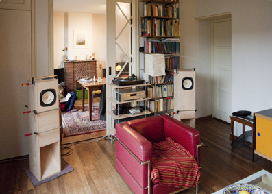

Hello,
I received the two pairs of El70's yesterday, so its time for building enclosures.
After reading different threads on bipolair speakers it became clear to me that they
should be positioned quite a bit away from walls.
Where my speakers wil be standing is where the half changs are in the picture.
I am aware that the situation is far from ideal with an open space behind one and books behind the other speaker, but listening to the half changs and
other speakers before that has always been satisfactory.
I have a few enclosures in mind; bipole microtower, offset bipole mltl (jim
griffin's design), bipole metronome and the ml voigt.
Back of the speaker will be about 2 feet from wall and books.
Could anybody please give me some advise?
Leo
