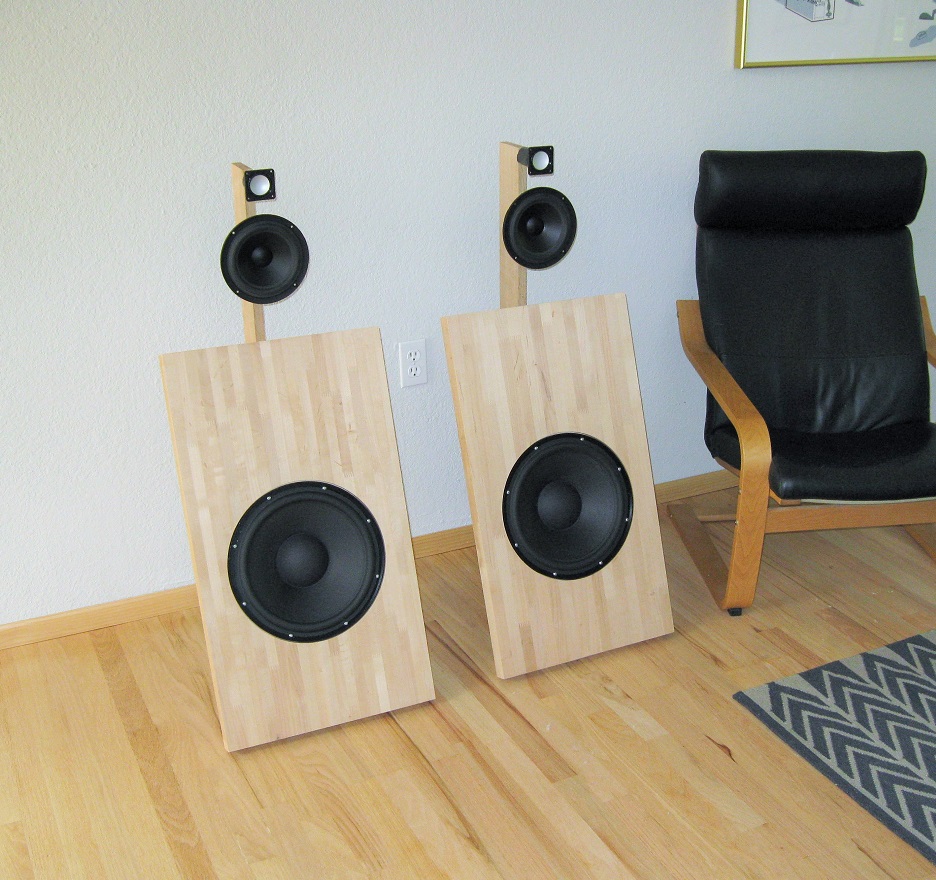

The speaker is a three-way (plus subwoofer(s) not shown) open-baffle/nude design using a novel mounting method for the midrange and fullrange/tweeter that I am referring to as a "fin". I machined holes in the edge of the fin into which I sank tapped tubes. The drivers are mounted to the tapped ends, the midwoofer by its frame and the tweeter using a small adapter that attaches to its magnet. The fin is bolted on to the frame that supports the lower baffle. A 12" woofer located in the tilted-back baffle is "aimed up" at the listening position. Overall the construction provides a very clean and minimal visual profile.
I will post more info and measurements when I have them. For now here is a picture (attached) of the prototype.

Not sure what you mean. There isn't anything that is adjustable per se. Moving the drivers relative to each other would effect the frequency response around the crossover point(s).Make the mids adjust relative to the base?

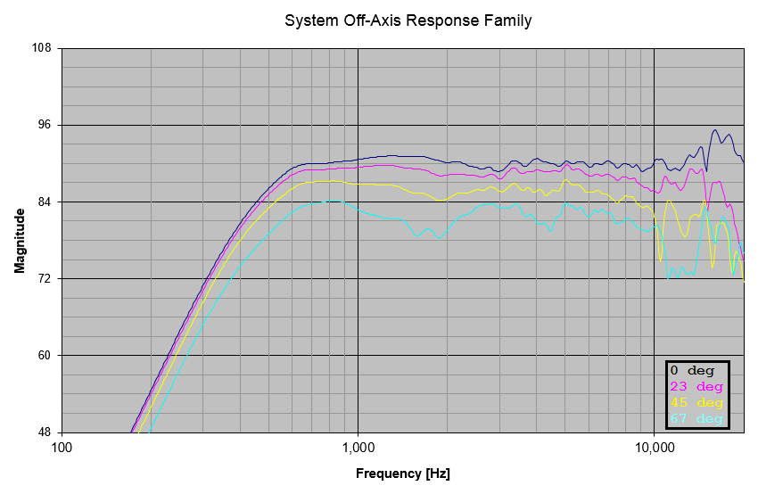

I've started to do the crossover development. I can simulate on and off axis responses using my ACD tools and some (yet unreleased) extensions and see how the family of responses change as I tweak the crossover filters and EQ. See the attached pic for a preview of the frequency response on axis, and at 23, 45, and 67 degrees off axis (in the horizontal plane).
This would normally mean I have to measure the drivers on multiple axes. Luckily this is not the case with the "nude" mounting since I already did lots of measurements when I was selecting these particular drivers, and did them in the "nude" mounting style. I'm assuming that the response will be the same here, and it should. I also had done a bunch of preliminary crossover and EQ development on each driver separately many months ago. All of this data is still valid, and I only needed to play with the digital delay on one of the drivers to bring them into phase alignment around the crossover point.
The results look pretty good - there is a general constant directivity trend with some slight widening (1kHz-2kHz) and narrowing (3kHz) of the pattern. In general this looks like a good balanced response, and I can easily shape the overall trend using global EQ once I have the full system up and running and can take some measurements on it.

Very nice Charlie! There seen to be some widening of response around 3kHz but it is very smooth. (Response widening = less spl attenuation off-axis, in graphics lines are closer to each other)
In my Ainos I had lots of trouble in that region, but it was obviously the tweeter-waveguide being too near. I have measured a 3" mid's off-axis response without a baffle in my hand and then it is smooth up to dipole null around 6kHz.
Where are your xo-points now, what configuration?

The midrange rolls off at around 500Hz, 4-5th order with sort of a Butterworth type of character and at around 2kHz with more of a Linkwitz-Riley character, 4th order. The tweeter comes in around 2kHz, 4-5th order. All slopes mentioned are the combined acoustic slope.
Thanks for the correction on "widening" and "narrowing". I had that backwards I guess.

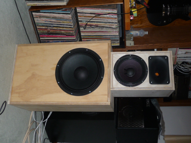

A quick pic is attached. The thumbnail is horizontal but it opens vertical on my computer, I hope it does for others!
Bill
Bill
