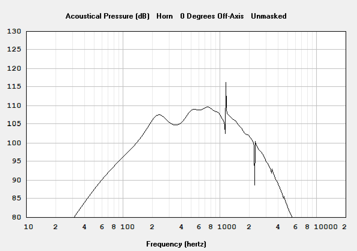

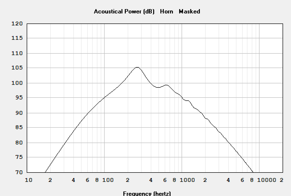

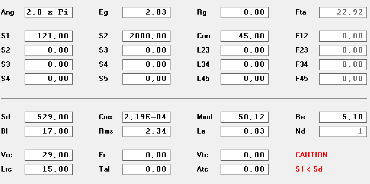

Attached is a full size expo horn on axis in half space (shaded design) required to yield max efficiency and a 250 - 2 kHz mid horn on axis and in half space.
Sure it does, look at the picture, for whatever reason the shaded plot is very faint and need to go to 'Tools/Directivity/Response' to get the on axis (zero axis angle) plot.
It can be square or rectangular, just needs to be expanding from the throat. Yes or I wouldn't have posted it.
Yes, the dip isn't nearly as bad as HR predicts, but our hearing acuity isn't good enough even if it was and the 3-400 Hz dip is < +/- 3 dB which again won't be this bad in reality + is most folks threshold, so likely won't be an audible issue.
Note too that virtually all horn designs benefit from 'critically' damping its terminus to quell reflections back to the throat like at ~1 kHz, modulating the driver unless heavily rounded over or at least has a 'flip out' like the B&C horn except it needs to be greater for best performance. I ran out of time to sim this version.
