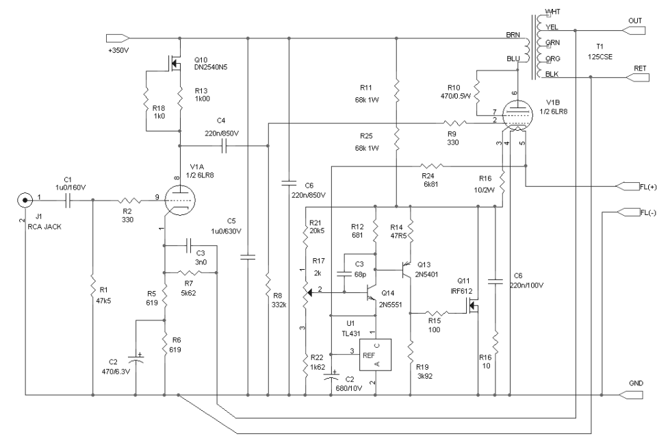

Attached is a schematic of the second of a series of compact single-ended tube amplifiers with switching power supplies. This amp uses a pair of 6LR8 triode/pentode vertical deflection tubes (with pentodes triode strapped) for what should be somewhere between 3-4 W output, The circuit shown uses the triode tube as the input amp with a current source load consisting of a DN2540N5 depletion mode MOSFET. The power pentode is triode strapped and cathode biased using an amplified zener voltage source (components R12,13,15-17,19,22, Q11,13,14, U1, C2,3,6). This voltage source is proposed as an alternative to the LED array used by SY in his "Red Light District " push -pull amplifier. The voltage source receives additional bias from the plate supply through resistors R11 and R25 so that it is never cut off, even if the output tube is cut off. Additional bias is provided for voltage reference U1 through resistor R24 to swamp out voltage variations due to curent variation in Q14.
This circuit was brought up on the bench this afternoon using external DC sources for the filament and HV supplies, and bias in the output stage was adjusted to ~45mA. Bias is stable, and no magic smoke was released. The next step is to finish mounting the input and output jacks on the rear panel and mating the amp with its switching power supply, which is already thouroughly wrung out.

R11 and 25 are to keep bias current going through the cathode shunt regulator under all conditions. The cathode is biased at ~45V, set via experiment on the bench, as I was too lazy to plot a series of triode-connected curves for the 6LR8 pentode section. The plate of the input triode is at ~160V, with bias set at ~2mA by Q10.. DC coupling would not be a good idea..
wrenchone said:
The cathode is biased at ~45V....The plate of the input triode is at ~160V..
OK, gotcha.
As a side note, have you noticed a "sweet spot" too with vertical deflection tube high gain triode sections @ 2mA with 160-200V on the anodes? I did a comparison of sound between several and found that to be a common trait among the ones I tested 😕
Cheers!
The rationale I used was to set the plate voltage on the input triode to about 1/2 the B+ voltage for max symmetric swing. I also wanted some decent current through the input triode so it wouldn't be like some starved, puking 12AX7. At ~160V Vp, this is ~2 mA.. If this turns out to be a sweet spot, all the better...

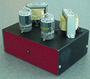

Here's some pics of the finished project. The case is an old Radio Shack enclosure I had banging around. After Burning Amp, I plan to take the thing apart and have another go at applying the crackle finish, as it is uneven this time around.

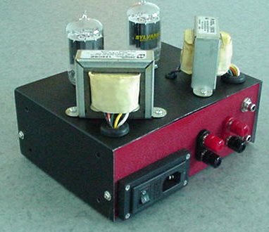

Here's a rear view of the amp. Today I auditioned it with a pair of Paradigm towers that live in the audio testing room at work. The Paradigms are much more sensitive than the Infinity speakers I was using last night, so this little amp really kicked butt. I'll be very pleased and proud to present it at BA - it may open a few eyes.

Just as a statement of purpose, the aim of this amp was to test an alternate approach to biasing the final stage. The standard approach of cathode biasing using a resistor shunted by a large cap would have been a minimum parts solution, and would've worked ok. The purpose here was to present a biasing scheme that would be less compromised during large transient excursions. Another approach would have been to use an LED array like SY did in his "Red Light District" amp, but I didn't want all the gaudy lights and we'd sort of tossed the gauntlet down in a friendly fashion at the last Burning Amp when I mentioned this particular idea. So, here it is - an amp biased with a fast semiconductor-based voltage source. I look forward to some listening tests with sensitive, well-articulated speakers. There was certainly some "slam" using the Paradigms.
