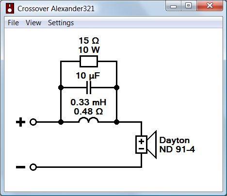

I don't know how the Dayton performs in the double chamber cabinet, but it goes quite low in a single chamber of the same size (internal volume 2.1 liters). Vent dimensions would be 21 x 120 mm. Don't expect much treble above 8 kHz.:sad:

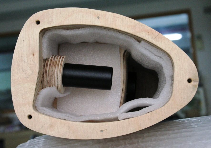

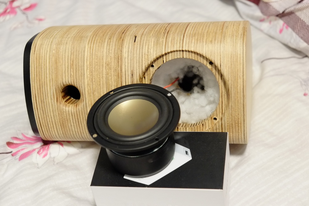

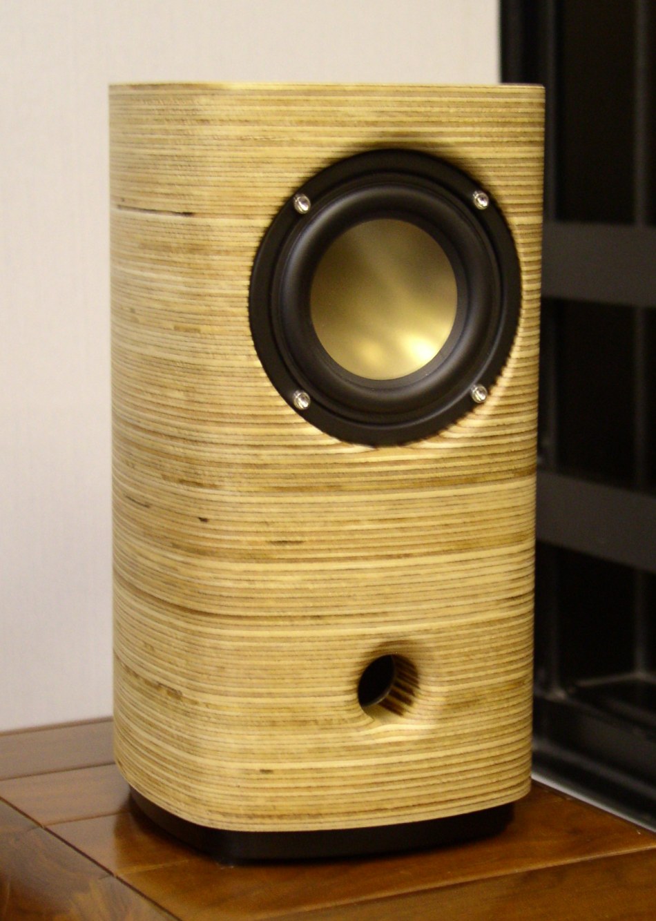

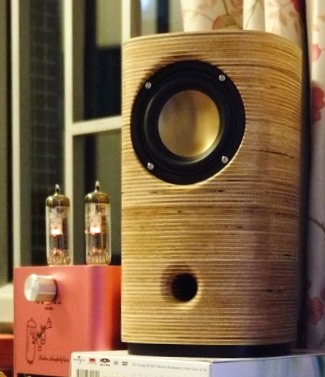

> Can you give me more info on the project?
Same as the original DCAAV in volume and pipe size.
Just different shapes.
Frequency response is as flat as you can get from a wide band.
Sounds great, so no need to change anything.
(We tried using the original Italian software; did not make it any better with our changes.)
A picture is worth more than a thousand words.
So here are a few thousand.

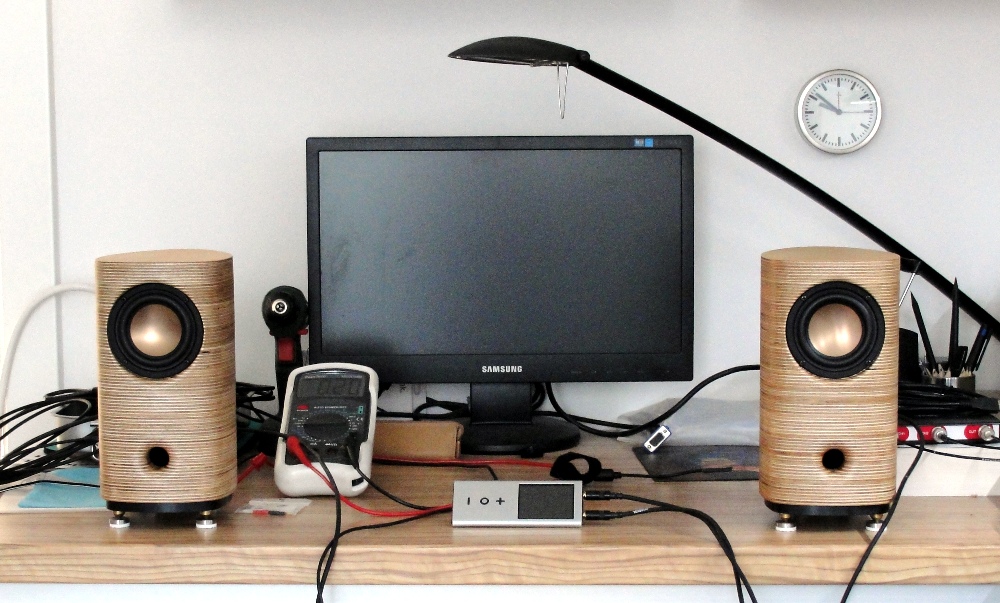

This is part of the XEN Audio team project for a PC speaker.
Source is a USB DAC using ES9023 in balanced mode.
The bottom plate of the speaker is milled from solid aluminium, with a LM1876 inside, also in balanced mode.
http://www.diyaudio.com/forums/head...nheiser-hd650-vs-akg-q701-qj.html#post3297365
Patrick

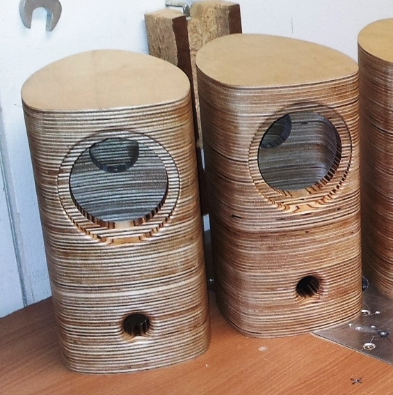

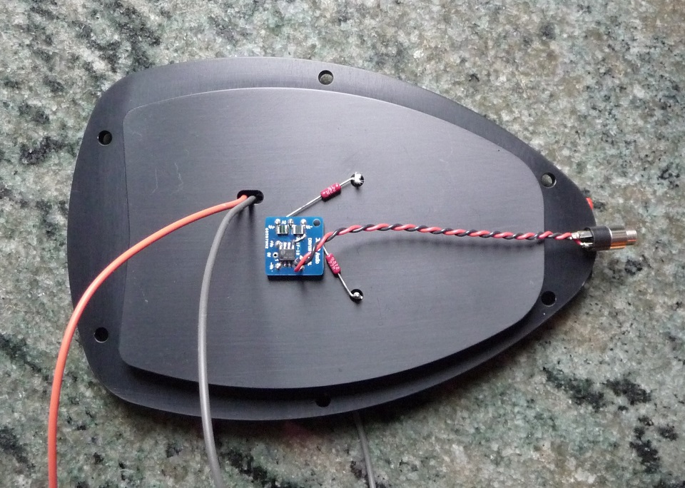

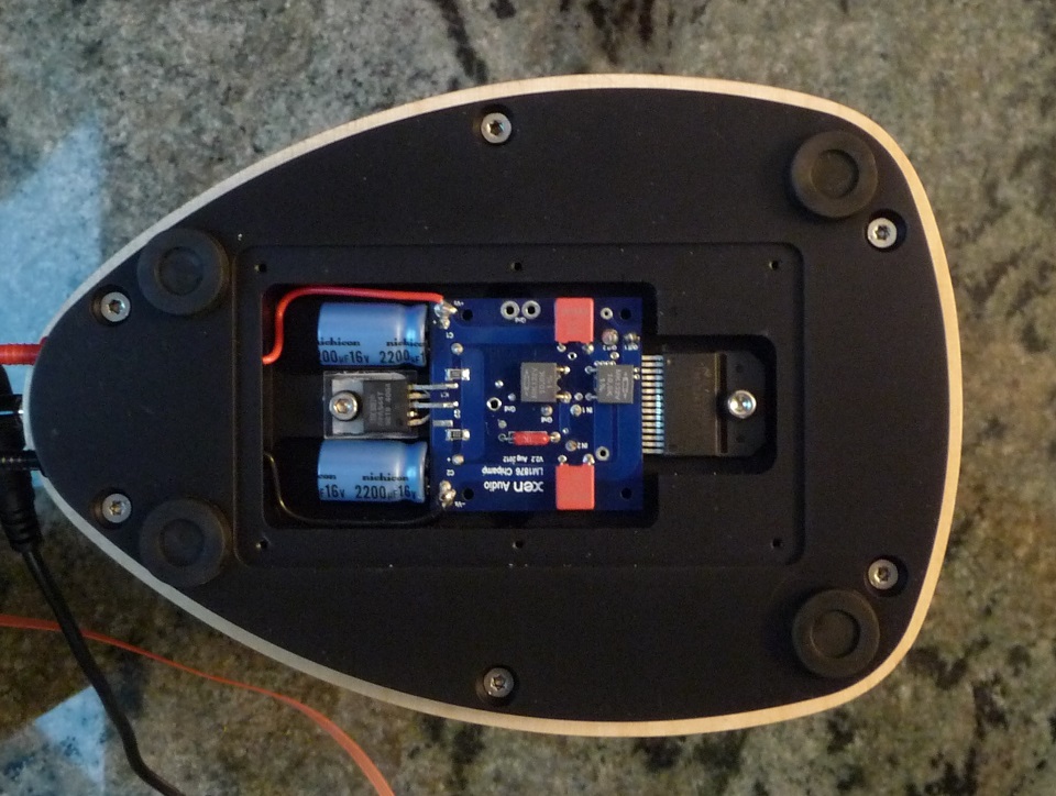

We finished another 10 pieces this years.
These have inside their base plates a LM1876 chipamp driven in balanced mode.
For single ended source, balanced conversion is done by a THAT1646.
Make very nice desk top computer active speakers.
Power is supplied by a 19V 45W laptop SMPS, with BUF634 rail splitter.
Patrick

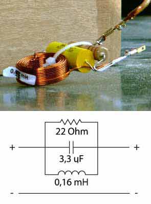

Original design notch filter schematics?
I realise that this is an old thread but I'm hoping to build the original design using B3N's.
However the site appears to gone (and the original author uncontactable - I tried).
While the dimensions are readily available, I haven't been able to find the values/schematic for the notch filter.
Would anyone have saved this? If so would really appreciate a copy!

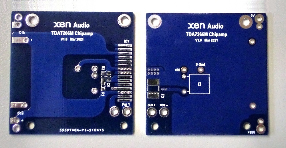

Some of us still have not finished theirs after 5 years.
And some now want a simpler solution for single-ended input.

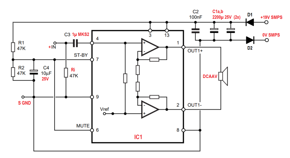

So instead of LM1876 bridged with a THAT1646, we found another solution after much searching.
The TDA7266M (mono) will do everything we want with very few external components.
And will work at a wide supply voltage range.
We intend to use 12V and 18V from notebook SMPS, as before.
Patrick
