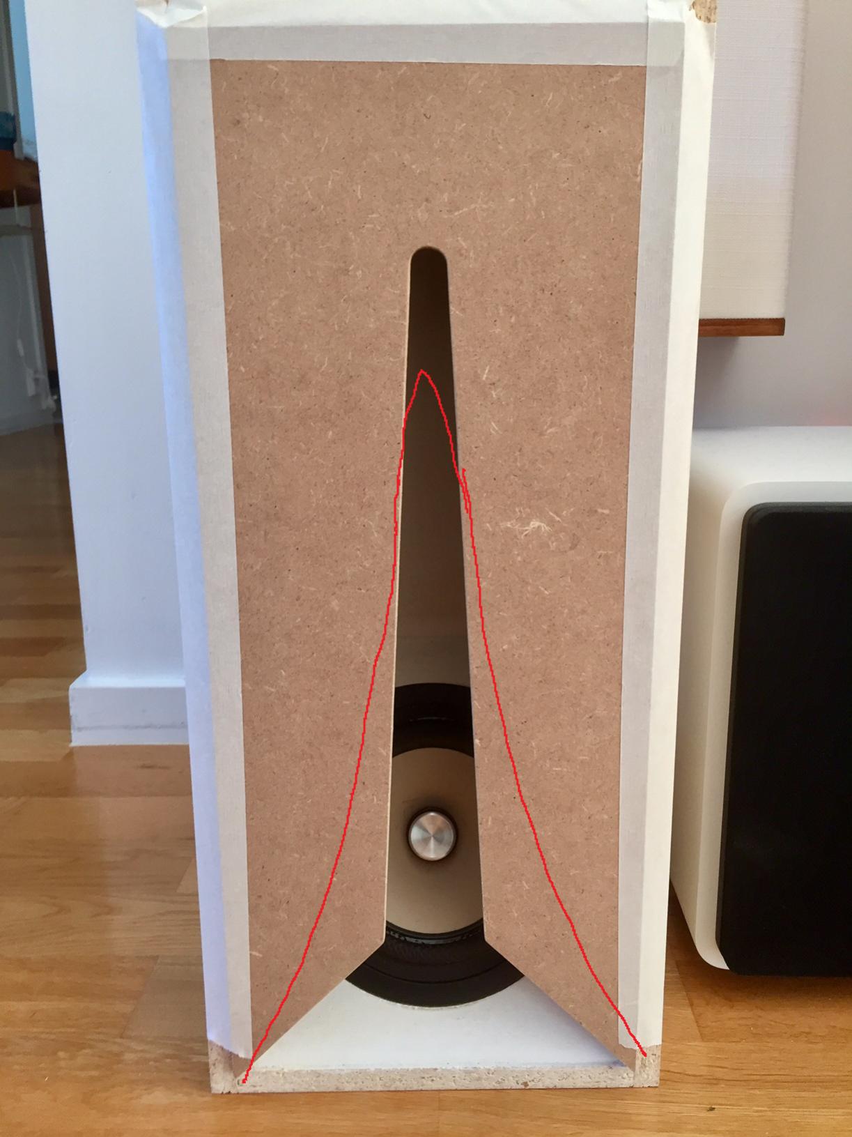

I was planning to document my build of the xrk971 W5-2143 Kalsonator in it’s own thread but it didn't turn out the way I thought it would so I just document it in here…
Background and rationale: I got a pair of TB W5-2143 and I really like the way they sound, especially the midrange for vocals and jazz. Not excelling in bass extension or SPL but good enough in a bog standard vented box so I have been in search for better alternatives for these drivers. The Karlsonator intrigues me and I also think that the Decware DNA Horn could be a good match. I decided to tackle the Karlsonator first. I constructed a drawing based on simulations and measurements by xrk971, who also provided me with some additional guidance.
Some use foam board for prototyping I use chipboard and scrap pieces. I made some minor changes to my drawing and started to build the xrk971 W5-2143 Kalsonator Special. Sanding sealer would have been a better option to seal the chipboard but I wanted to try a new water based sealing primer. Total fail, I really hate this product (white in the pictures), deluded PVA glue would have been much better (if schellack based sanding sealer is not an option). The boxes came together quite easily and I was planning a more modern looking take on the Karlsonator aperture (please refer to the pictures). I was planning to mount them against the triangular strips with velcro.
I used chipboard for the base (planning to veneer it if they sounded great), some ply to stiffen the baffle and to drive the mounting screws through, MDF for the aperture and additional stiffening the back panel (I planned to paint these off white and edge trim the chipboard with solid wood). I wanted to put it together in a state where I could actually get a feel for how it would sound before I invested time and money into finishing.
Today I manage to put the first one together with the W5-2143 element and benchmark it side by side with my original boxes. Maybe I had too high expectations but I immediately felt something was wrong with these new speakers. The bright open midrange that I love about the W5-2143 was gone. It sounded dead, muted, muffled in a way. Bass extension was way better than my vented boxes but pretty much everything else sounded worse. I really hate when projects doesn't turn out the way you anticipate and I guess there is much room for improvements but I will abort this build just based on how the midrange got affected. I also ran them without the aperture. They now sounded more open and airy but still way more artificial and closed than the vented box.
I will miss the bass extension and continue to augment bass with a set of subwoofers.

Hi EmuMannen,
I was wondering what the status of your project is, and did you get a chance to try out the larger K aperture? It needs to be opened up from what you had it for the mids/highs to get out properly. I would make the front aperture something like this - where the line intersects the midpoint of the surround (the definition of the Sd).
X
