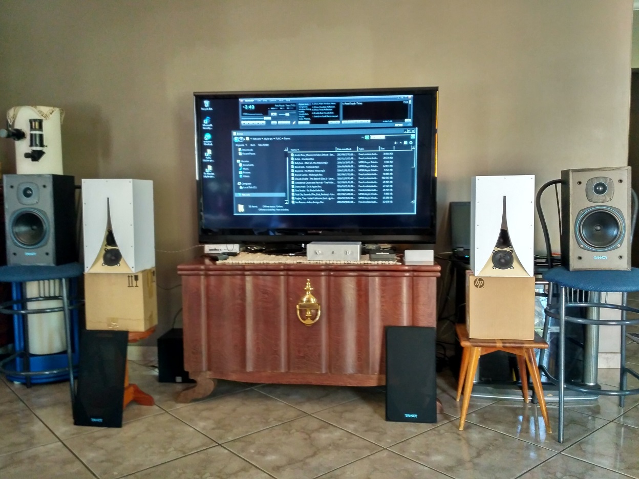

Below is a photo taken at our first listening session - shortly after I completed the 0.53x K's, but before I built the ACA's. It will give you an idea of what the Tannoy's look like. Twocents (owner of the Tannoy's) said they are 'monitors'. I had a look yesterday and there is one 6" driver and one tweeter per cabinet, which probably means it's two-way.
The crude speaker stands are still in use. I'm planning to build proper stands when I rebuild the K's out of LitePly.
Also, note the position of the speakers close to the wall. I have since then discovered that speakers need to be moved well away from the wall and to form an equilateral triangle with the listener, thereby facilitating a good soundstage (if the system is up to it). As I've mentioned in my previous post, the ACA's and Karlsonators are a good match and the soundstage is excellent.

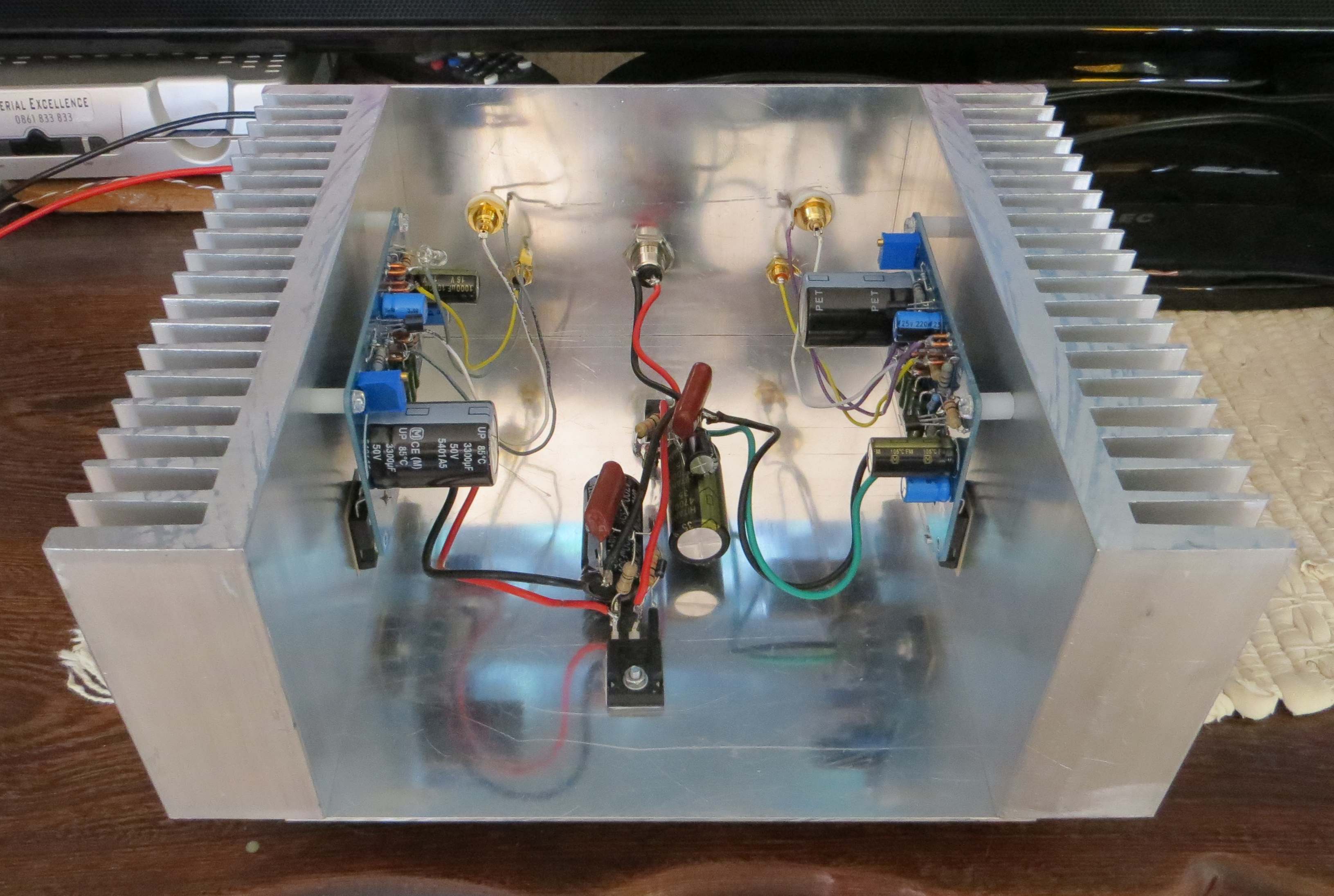

And since you've asked for photos, here are my ACA's. I've made custom PCB's and used dead bug style cap multipliers to drop from the PSU's 24V down to 20V for the ACA's.
The enclosure still needs a lot of work, but I can enjoy the sound in the meantime.

Tannoy E11 - 2 way with 6.5" woofer and 1" tweeter - so, not a full range speaker. They sound good and loud enough with the ACAs.
BUT, with Skylar88's current setup - dual FaitalPro 0.53X Karlsonators with BSC driven by ACAs - I have never heard such a soundstage and imaging before. Simply jaw dropping with good recordings, like Nils Lofgren - Keith don't go live recording. The midrange is really really nice - warm and natural. Feels like the artist is in the same room. The treble is incredibly detailed and sharp without any hint of harshness. Comparing to the Tannoys - the Tannoys still have more authority in the mid bass and lower, but the Karlsonator's bass is just tighter and more pleasing, even if it does not go that low. The Karlsonators sound much better in all aspects. The presence they create is just amazing - even with old recordings ripped to MP3.

That's a fantastic looking amplifier!
Any details on how you did the heatsink/enclosure setup?
The enclosure construction is really very simple. So far I've just bolted aluminum plates to the underside and rear with 3mm bolts which fit into holes drilled and tapped into the heatsinks. I'll add a 6mm aluminum faceplate to the front and the top will get a 1.2mm alu plate that will be recessed to fit flush with the top of the heatsinks. That's about it. I may send the heatsinks in to be anodized and all the aluminum plates except the front will then also get a coat of paint.

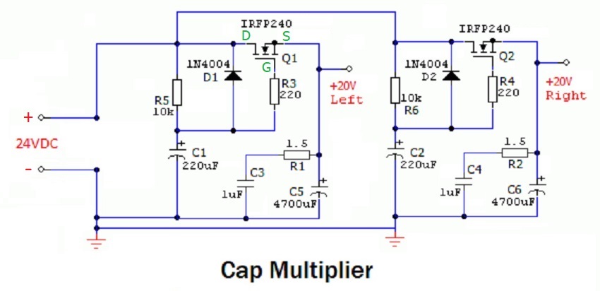

That’s the Juma cap Mx circuit. Simple IRFP240, 10k, 220R, 1.5R, 220uF cap to be Mx, 1uF film snubber cap, 1N4004, 4700uF output.
Juma's Easy-Peasy Capacitance Multiplier
Yes, it's Juma's Cap Mx and this is a diagram for two-channels that I adapted from the one in that thread. I used IRFP250 because it was cheaper and more readily available.
