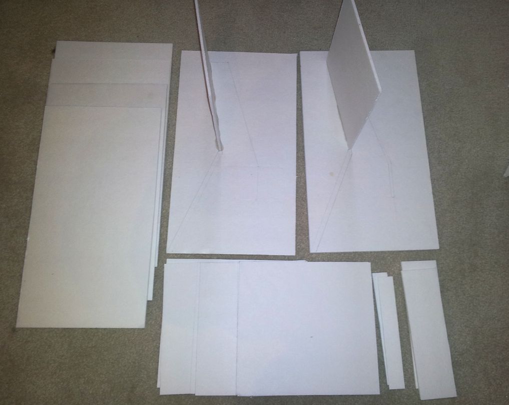

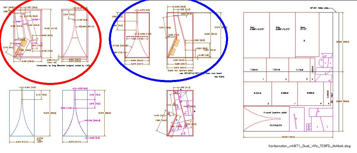

Got started but need help. I cut all the major pieces from cut sheet diagram before I realized there were two different presentations on the dual PDF. What's what.:scratch1:

Bob,
There is a version on left that is a scaled down Karlsonator per original dimensions by GregB. The one on the right appears to be the plans as I adapted them to be optimized for foam core sheets. I did not make these drawings so you will have to double check what the cut sheet is for. If you go with my hand drawn plan on post 1 that will work. I make a long strip of the width and then cut pieces to length to match the plan drawn on one side panel. Sort of like how we built the Cornus.

Thanks, I'll adjust to your version as you have made the effort to optimize to FC. The measurements are not vastly different. Glad I didn't go for wood yet.🙂
Haven't gone too far so it should be easy.

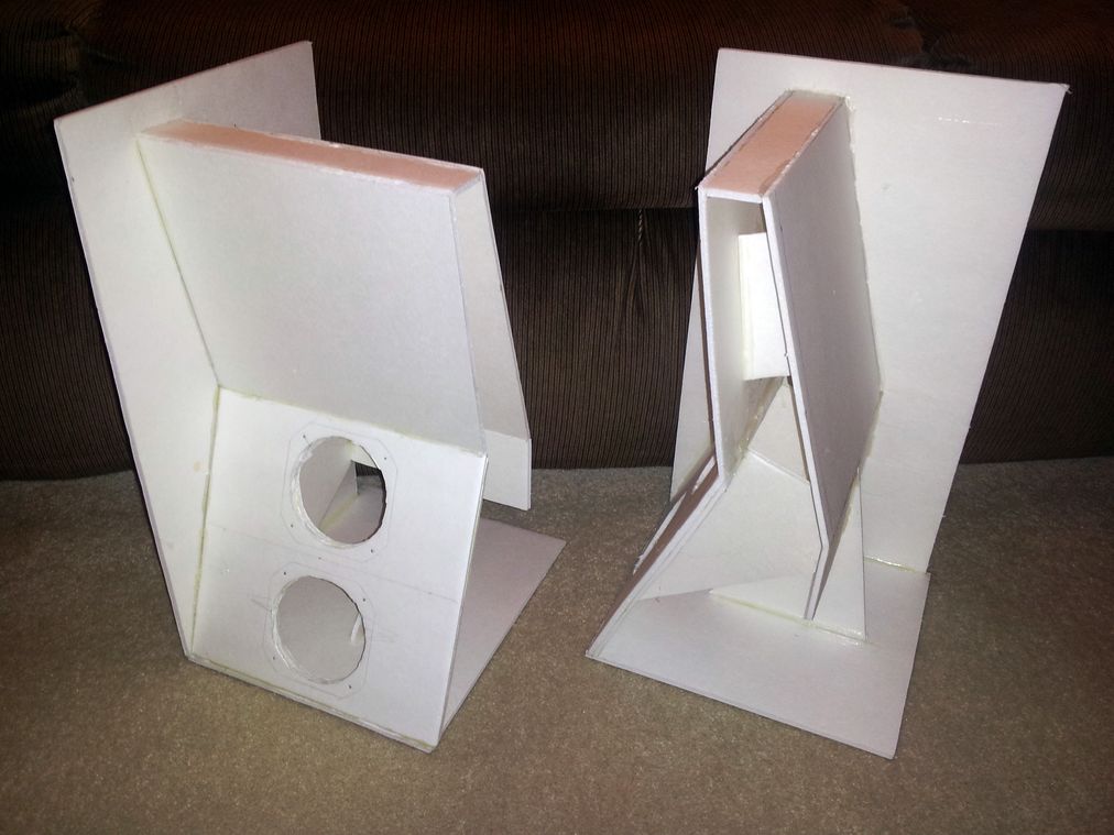

Bob,
Cool. I usually start at the bottom and work my way around. Use a square piece to brace initial pieces so that they form a 90 deg angle to ensure box is square when done. I just finished the second speaker and waiting for the PVA glue to dry on the final side.
So you are going for 0.53x with dual drivers then? This one sounds really nice with plenty of bass. Also is nice with 91dB sensitivity so that should help things for your ACA amp.

Hi bcmbob,
Just noticed your question in Post #249, the one you circled in blue is xrk971's version, and all the cutsheet stuff belongs to it. It is based on the scaled original, a material thickness of 3/16" and on xrk971's notes. When you scale an existing drawing the material thickness will more often than not be incorrect, etc., so you have to make adjustments, same for going from a hand drawing with generally close dimensions to a cad drawing; e.g.: the shape and dimensions of the Karlson slot. The one circled in red is just the straight scaled Greg B. original. Either plan could be redrawn for wood (different thicknesses), xrk971's (blue circle) is correct for the 3/16" material thickness.
These drawings are just part of my personal notes, and as you have noticed life can get in the way....

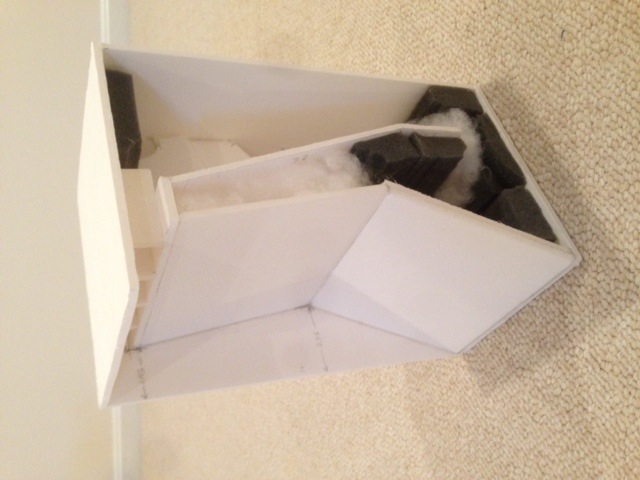

Padding plan
Here is how I am adding open cell foam on the inside surfaces near the driver and on flat ends to reduce internal reflections.
The second 0.4x is done and awaits the K wing panel. Listening to it in stereo actually sounds pretty good. You can tell the bass is not as deep as the one with the wing installed.
