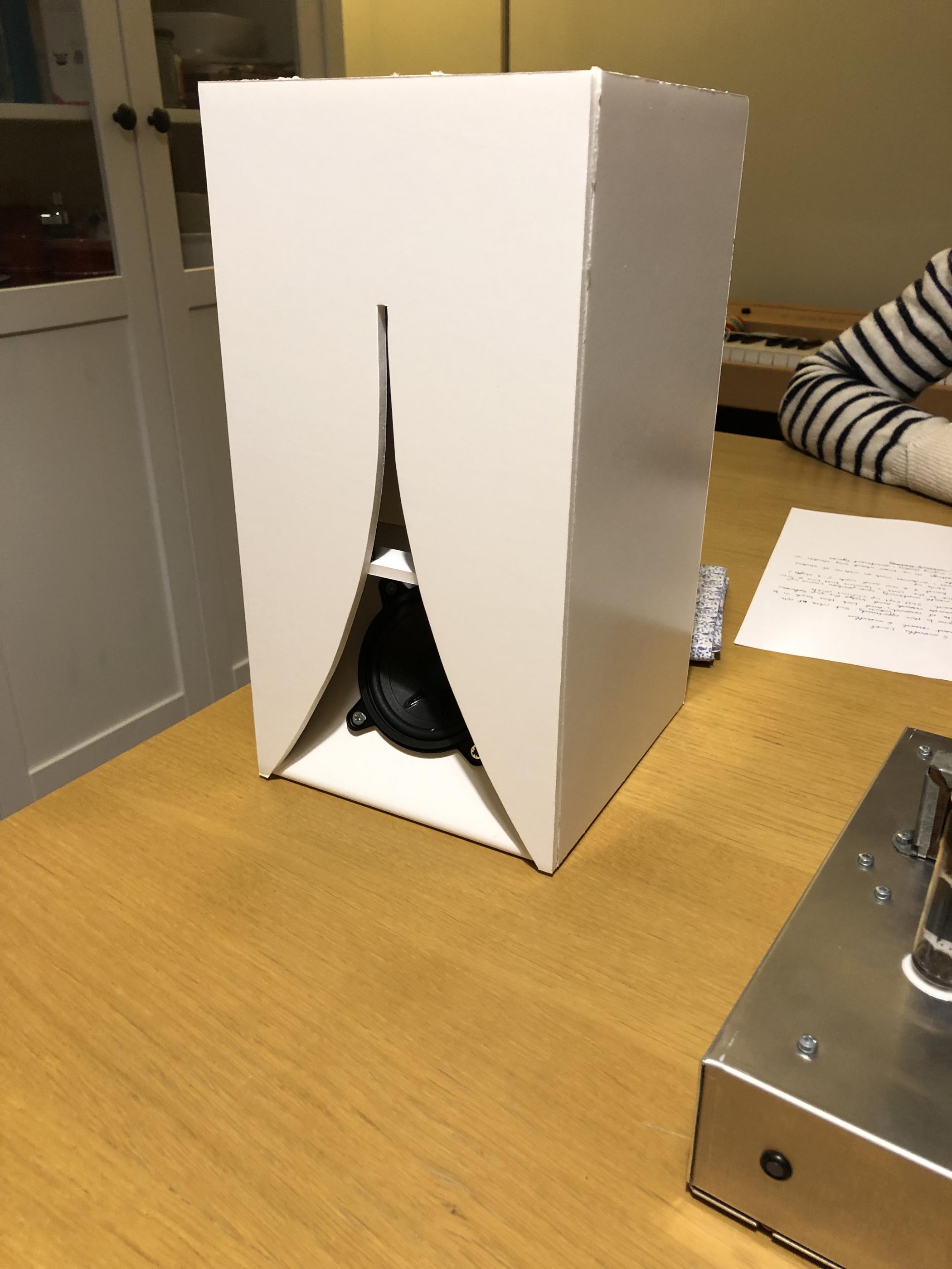

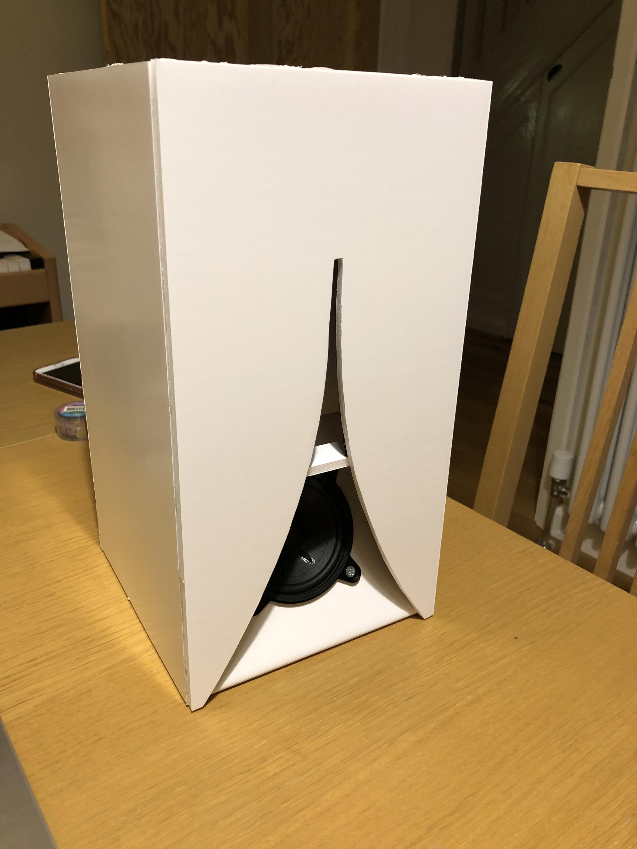

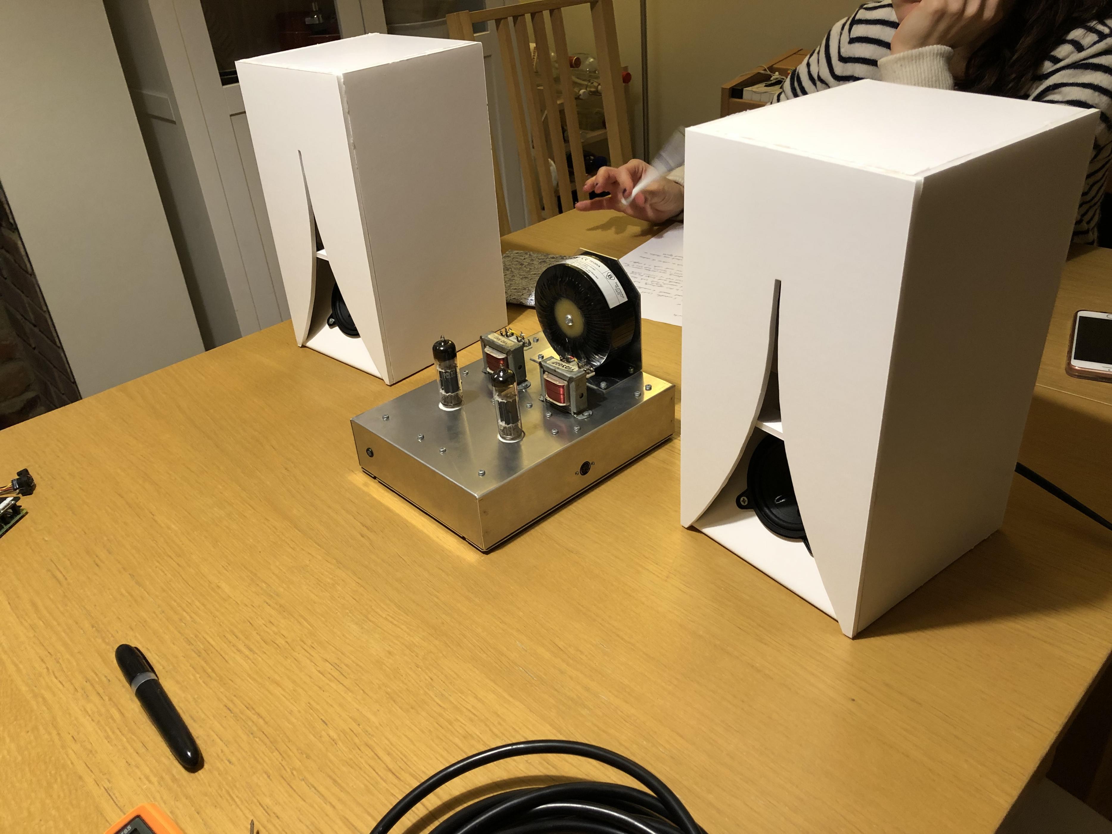

Mini Karlsonator (0.53X) with Dual TC9FDs
I got them 95% 'finished'.
A few tweaks here and there, but they put out sound. I need to go over each joint with more PVA (I don't seem to get much in the way of bass, but that could be the tiny output transformers or lack of break in) and do some general tidying (removing the bits of glue which seeped out).
Haven't had much of a listen as I've got a hideous ground loop issue with my amp + source, and blew a MOSEFT in the control circuit... But once those are resolved we're in business!
Thanks for all the help.

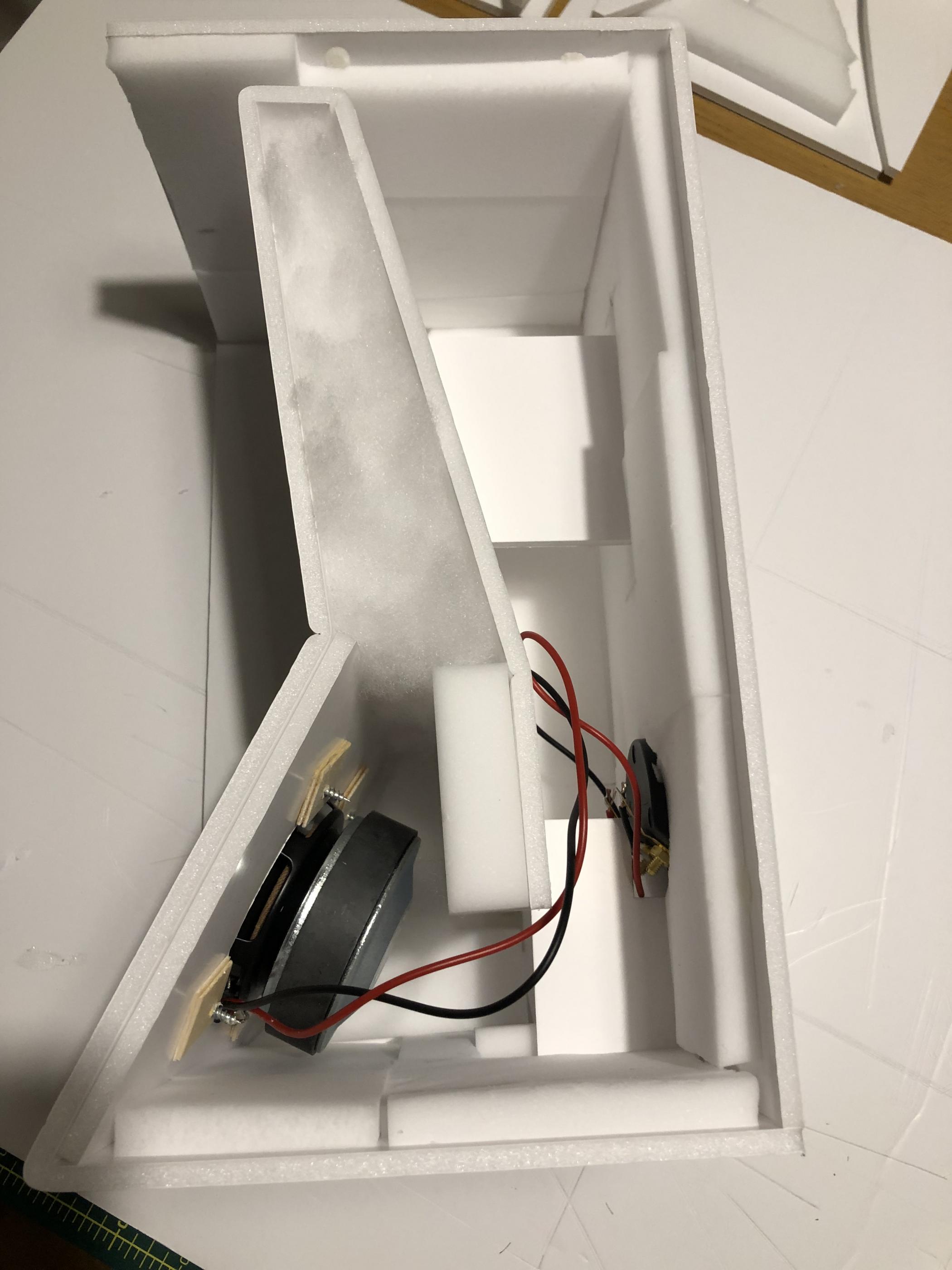

Nice work! The 0.40x scale Karlsonators don’t put out a lot of bass - probably down to 80Hz or so, but the sound should sound quite full and balanced and not tinny or lacking bass. If you have any air leaks in the TL, it might prevent generation of deeper bass. You did an excellent job of lining the inside with the melamine foam. How much power do you have from your hybrid amp? Is it sort of like the Estudiante amp?

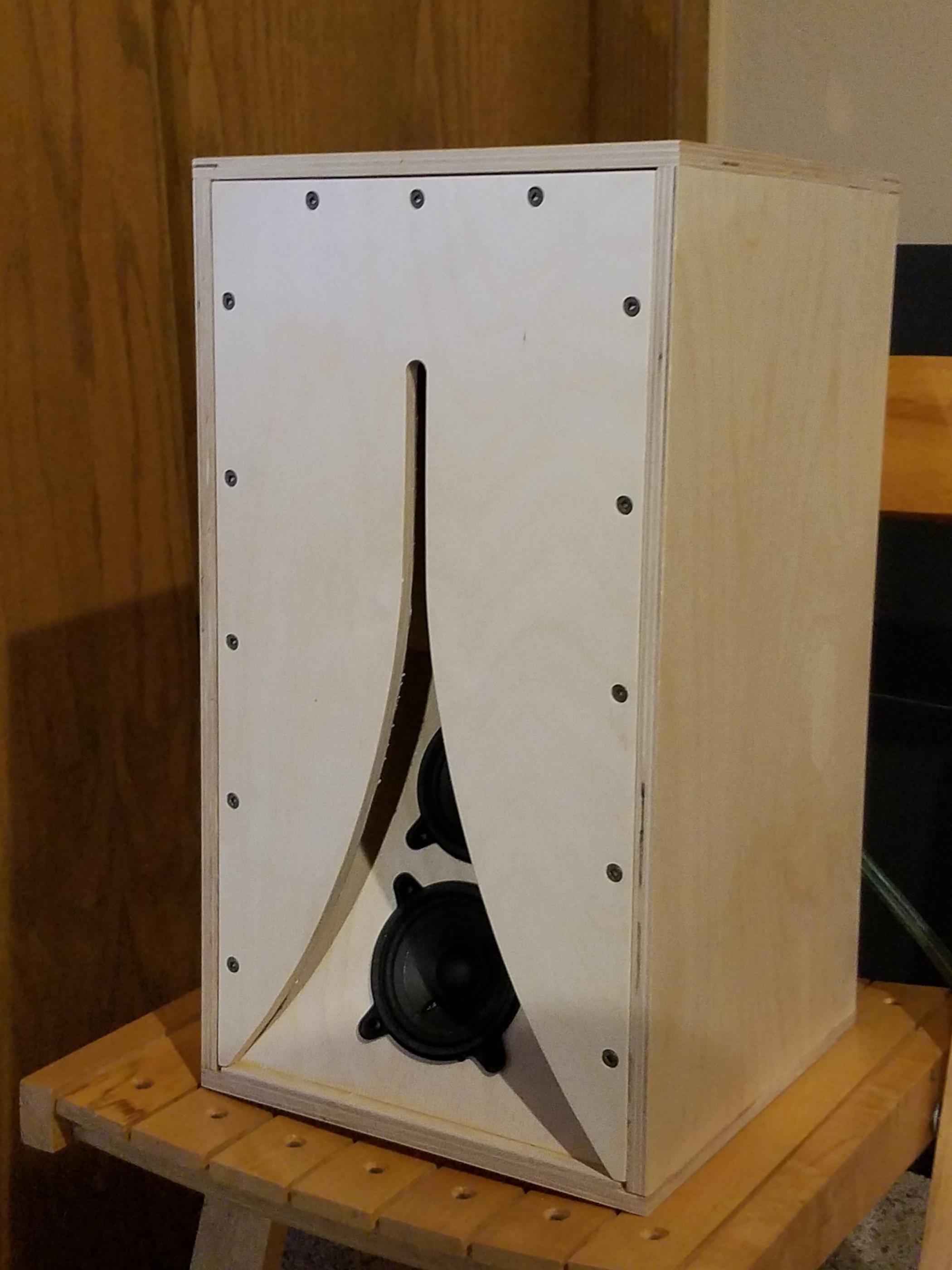

Well folks,
My first experience with the mini-Karlsonator design. I built the 0.53X version in baltic birch plywood. There are dual Faital 3FE25 16 ohm drivers in each one wired in parallel for an equivalent 8 ohm nominal impedance. Internal damping materials are exactly per X's recommendations. Melamine foam on the interior bottom and both sides of the box. Additional melamine foam along the back up to the baffle height and on the back and both sides of the bracing near the drivers. And there's foam core board on the back side of the aperture.
The attached image is what one of them looks like. The resemblance to X's earlier posts is intentional. I built all four of them to his design.
My first listening experience was almost shocking. I'm listening to a Ramsey Lewis Trio CD recorded around 1958 titled Down to Earth. The detail and clarity is exceptional. The piano, string bass, and drums never sounded better. I'm not one for superlatives, in general. All I can say is that these are keepers.
Thanks for the kind words.
The amp is all valve - those are PCL82s, so half a 12AX7 as driver and a de-rated EL84-ish pentode in the same envelope. As for power, I'm looking at a big 1W clean! But that's fine to sit in the kitchen...
I've added plate-to-plate feedback to get lower input sensitivity. This decision may be altered once I've let things settle: GNFB might be applied with a lower level of plate-to-plate feedback to try and get some more bass. But these transformers are definitely the weakest link here!

Great to hear that we can officially say it’s safe to build plywood Karlsonators if the proper amount of damping material is used. Thanks for the listening impressions. The speaker is definitely “a keeper”. 🙂
