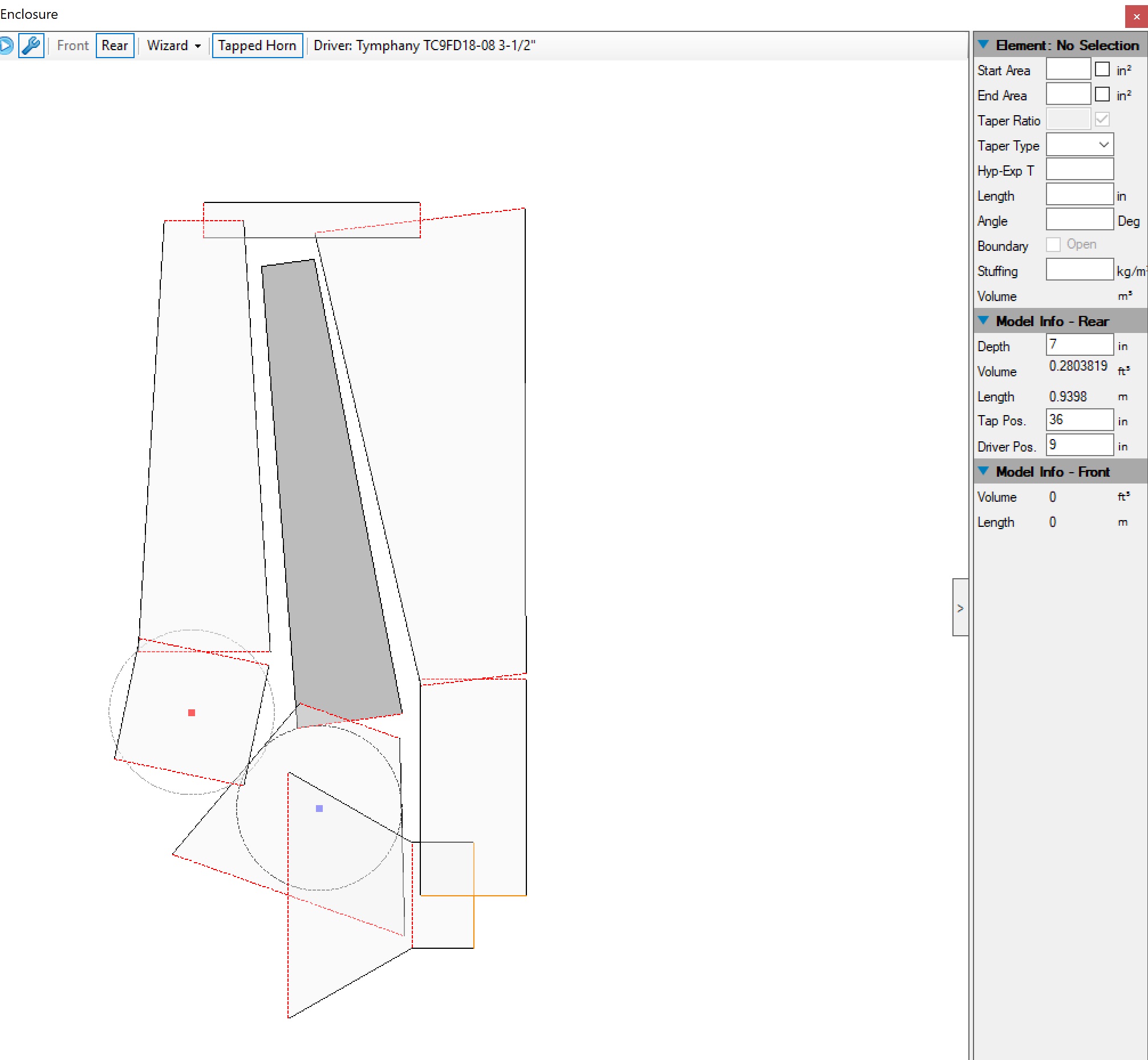

I tried my best to model a 0.4x TC9FD karlsonator in the, now defunct, Transmission Line beta program by leonard audio. I realize that the experts herein use akabak, but I couldn't get to run on my PC. I haven't tried a VM of Winxp yet though.
All that said, I don't really know what I am doing, but I set it up as a tapped horn design and did my absolute best to match up the "areas" to the dimensions in the score-n-fold plans. Is this a suitable method of modeling a design such as this? Or am I fundamentally missing the point and oversimplifying the physics?
I have enclosed a zip of my file. Please edit it, criticize, suggest alternative methods, etc to your hearts' content! I'd rather be disappointed but correct than happy and wrong.

I don't have Leonard Audio TL program so can't look at what you have done, but you can indeed model a lot of it if you follow the dimensions ad make a tapped horn. The main difference is that the effect of the Karlson aperture probably is not modeled well in the LATL program.
More details of how the K aperture is modeled in Akabak is shown here:

This is for the K15, but same principles apply to Karlsonator aperture, and the back chamber is a TQWT-MLTL...
You will know that the model sort of approximates a Karlson when you get the characteristic Karlson "W" dips in the 200Hz to 400Hz range. No one ever said the Karlson is a flat response speaker, but narrow dips are hard to hear, but it makes up for it with a wide soundstage and smooth wide polars and excellent dynamics.
It doesn't look exactly like a "W" but I think it might be what you are describing? You are right that simulating the aperture in TLbeta is impossible (I think). Is the "W" a result of the aperture or the design of the enclosure? If the former, then I imagine I am incorrect.

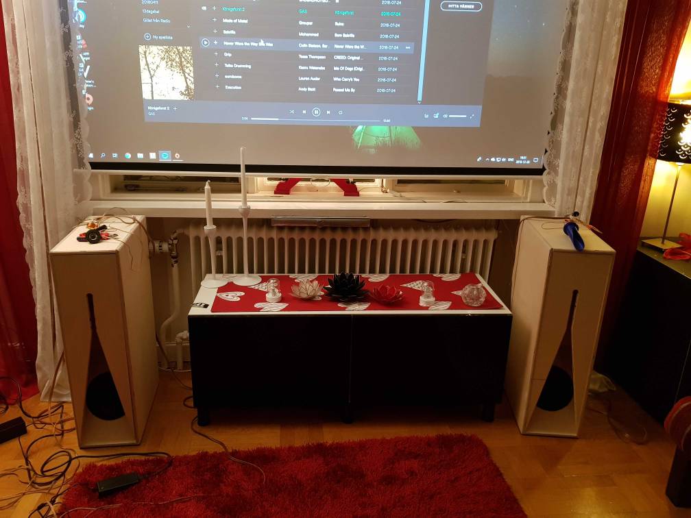

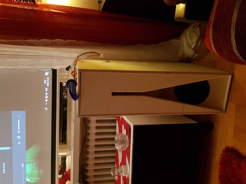

First test, so far so good.
Will add some paint and finish the damping eventually..
They turned out a lot bigger than expected

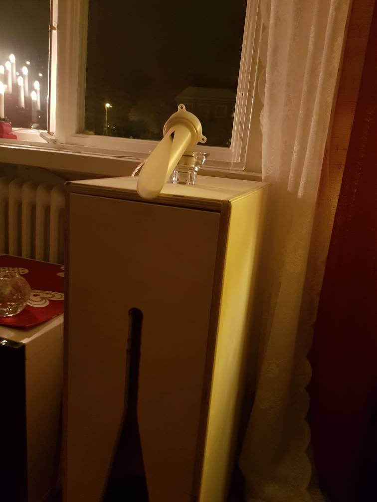

As I remember, the tubes work best if they are inside the cabs with the mouth poking out of the top of the woof horn slot. Looking good by the way.
Yes I'm going to experiment with the whole Tweeter setup and damping. The project started because I had some ~10$ speakers laying around. Now 150$ cabinets later can't say I regret it, I am very impressed with the amount of depth I get from this speakers.As I remember, the tubes work best if they are inside the cabs with the mouth poking out of the top of the woof horn slot. Looking good by the way.

Nice work! What drivers are those again?

3d printed some new ones and the combination sounds great. Waiting for some measurement equipment and will send you the response of this setup when I get it.

Once again just something cheap I had laying around.What drivers are you using in the tubes? I'd love to try a set.
13DT48P - Hifi - Hogtalarelement - Komponenter
They are a little harsh on their own but with the tube it behaves a lot smoother.
