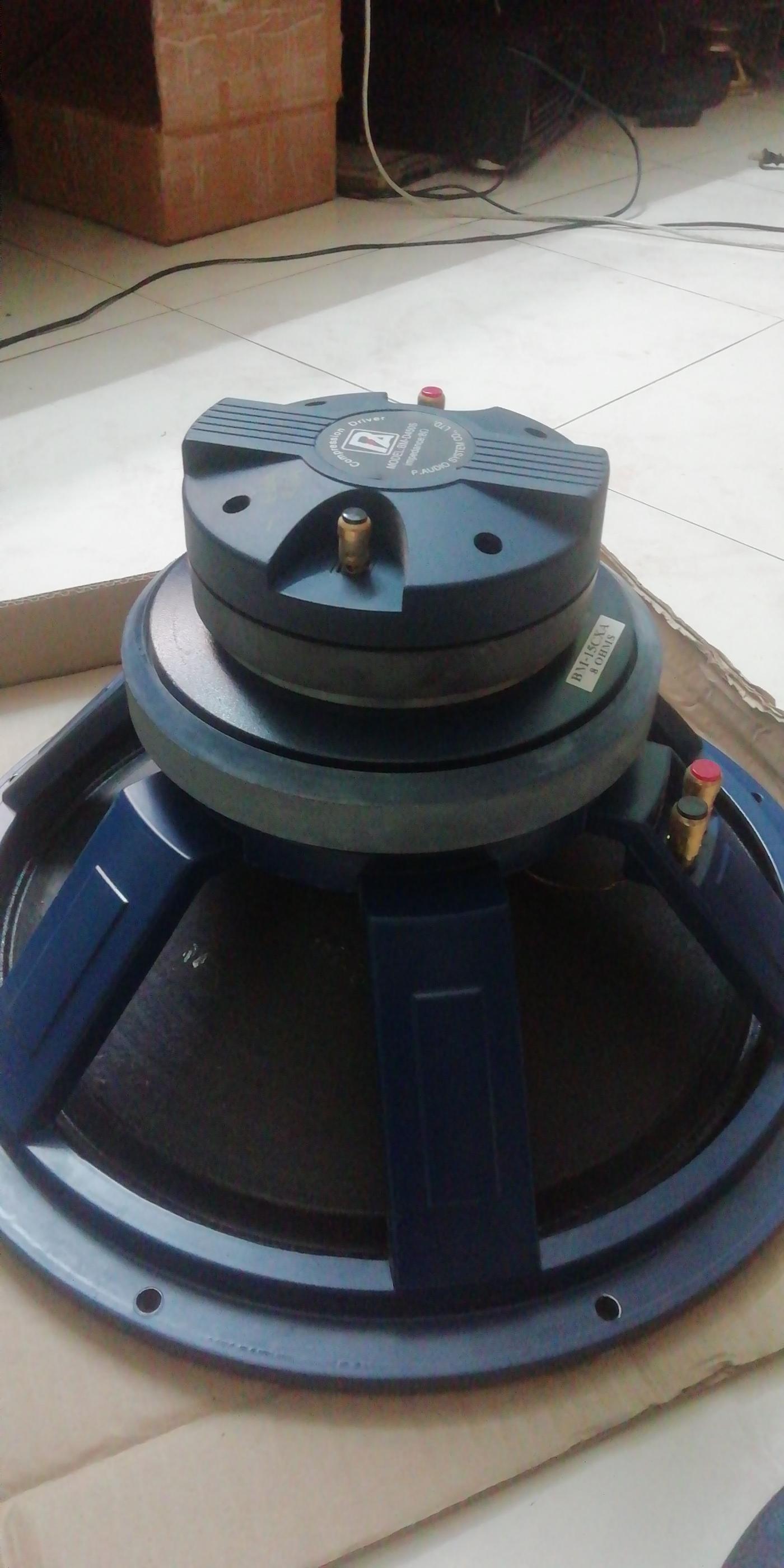

I managed to get hold of a pair of 15CXA and planning to go with K15, what is the recommended XO point for this driver as per your experience.a year or two ago, Loudspeakersplus had the P-Audio 15CXA with 100oz magnet and cast frame for $99.95 including their BMD440 compression driver - that would have been a traditional Karlson K15 coax. I mentioned it several times on this forum and they finally sold out.
![IMG-20200930-WA0014.jpg IMG-20200930-WA0014.jpg](https://www.diyaudio.com/community/data/attachments/795/795855-41ce4a4eb21819809dee315e0dc0d01e.jpg)
I've run that compression driver with Eminence generic (8uF/0.3mH/22uF) "1K6" 3rd order highpass on a K-tube without strain.
It could be run with just say a 3.3uF cap and not much padding - if any

you can try running the woofer section fullrange and tweeter with say a 3.3uF cap then compare that to a more conventional crossover.
FWIW the late Stan Ricker suggested that as a way to run Altec 604. I think that also was the way David Dicks suggested.
That may or may not sound good - but simple to try and if you don't play things at PA levels, 3.3uF should not pass enough LF energy to hurt the driver. (it can and will interact with a driver/horn's input impedance - usually to give a lower cutoff than what would happen if the driver was a pure resistive load)
With a small value capacitor as the only highpass element to the compression driver and no padding, the result will result in proportionately more energy at the top octave than a lower cutoff steeper slope highpass with no contouring,. In other words, a "brighter" more extended sound,

Which design is recommended for this driver, the original Karlson 15 or any other modern iterations. I could see many designs with different slot designs hence confused. I am eyeing for mid purity, LF extension is not my primary goal, anything around 40s would be good enough.you can try running the woofer section fullrange and tweeter with say a 3.3uF cap then compare that to a more conventional crossover.
There should be measurements and crossover schematics for your 15CXA.
One would not want any baffle step compensation with K15.
K15 is certainly appropriate. XRK971 might look into other possibilities using Akabak and your driver's spec. K15 should pretty much maximize "punch". A 1.2X scaled Acoustic Control 115BK would be about the same bulk as K15 and tune a few Hertz lower. A 15 inch Karlsonator simply scaled might tune too low so should be adjusted so Fb no lower than 40Hz.

I think Les Hudson used your model of coax when he built K15 (and scaled K15) - it also could have been the heavier model (?)
The "Blue Monster" /BM frame color is nice - my P-Audio have black frame

I would try the K15, don't want to bug XRK with the published TS as I heard those are very "optimistic". Now I need to figure out which port design will work the best for this.
Below are the T/S values, but no info about Mms.
Resonant Frequency (Fs) 39 Hz
Impedance (Re) 5.6 ohms
Mechanical Q (Qms) 6.45
Electrical Factor(Qes) .25
Total Q (Qts) .24
Comp. Equivelant Vol. (Vas)
9.09 ft3 / 257.5 Liters
Voice Coil Overhang (Xmax) 2.75 mm
Surface Area of Cone (Sd) .083 m2
BL Factor (BL) 18.45 T-M
