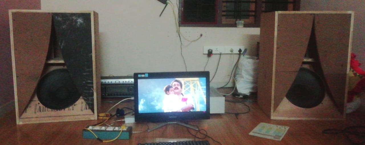

I wonder what is the difference between 0.4x one driver karlsonator and 0.53 with two 3fe25-16 in terms of midrange and highs only.Is there a better image, soundstage with 0.53x? I already have a subwoofer but I'am afraid I do not have the necessary listening space for a 0.53x...
Founder of XSA-Labs
Joined 2012
Mid and highs are similar but more bass and more punch in mid bass. Feels substantially bigger sound stage with 0.53x. I like to think of 0.40x as desktop near field speakers and 0.53x as full room speakers.

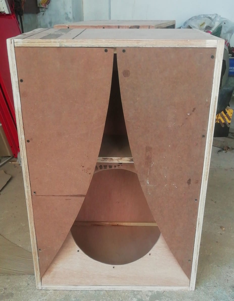

In my Karlsonator with dual 3FE25-16 made of 12mm plywood I would like to try the foam core instead of plywood for the front panel/aperture, 10mm (can't find any 12mm), but it seems there is many different materials, I need the stiffest possible and lightweight. Is there any specific that you can recommend for this purpose or there is no big difference between them?
I used this one
https://www.diyaudio.com/forums/ful...onator-0-53x-dual-tc9fds-137.html#post4309613
As a desktop speaker they absolutly rock. Go for it asap!

Please can someone confirm or amend my shopping list:
2x A1 size Foam Board. Which thickness is required please I can only find that cardboard would be 5mm? But thought I had seen 10-12mm mentioned.
Drivers - Got.
Glue Gun
Thing to attach speaker cable to.
Accoustical damping material. Can this be all sorts of stuff?
Foam. Again, can this vary? I have some half decent closed cell 2mm foam Fairly dense. Or some eggbox type foam, Probably about 23mm but quite 'airy'. Or I think I have an old roll mat.
Thin felt. Might have to buy some of this.
