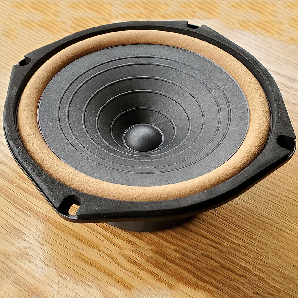

This Diatone clone is a very nice sounding 6.5" loudspeaker. And cheap, too.
I don't know if it's suitable for Karlsonator, maybe XRK can make a simulation

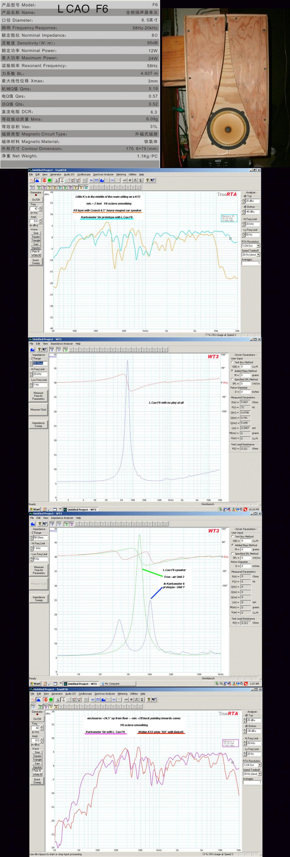

that should play in a Karlsonator 6. Here's the prototype for Karlsonator 6 with L Cao F6. The prototype was a bit smaller (less deep) than the plan.

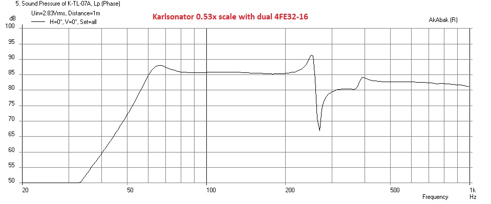

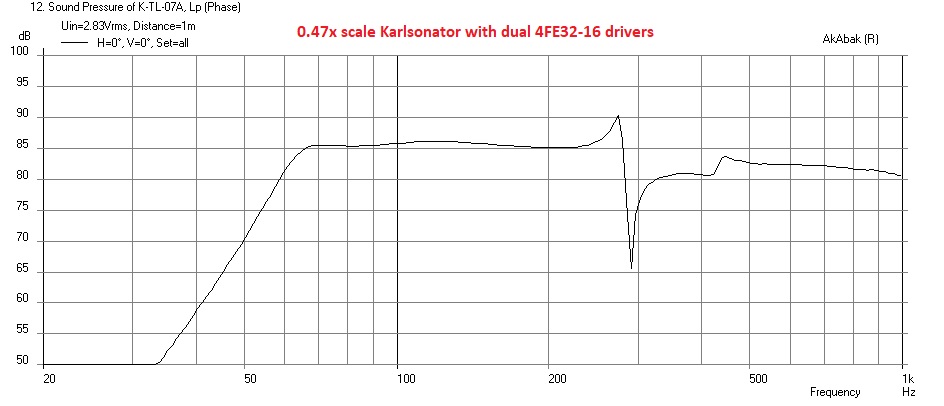

What I sometimes miss with my Karlsonators is a bigger sound. I.o.w. more SPL. It's great that the FaitalPRO full range drivers are available in 16 Ohm. I wonder if dual 4FE32-16 in parallel in a larger scale cabinet would work well. It would still need a sub I think, but I'm OK with that.
The Tabaq is no doubt a great sounding speaker and has the advantage of a long MLTL. I made one with a 3in Peerless driver once and recall pretty deep bass in the 50Hz range. The SPL was moderarate though and you needed a lot of attenuation of the highs to balance with the bass. In the end, it made the speaker maybe -5dB less sensitive from the BSC. The Karlsonator, on the other hand, has no BSC circuit so the bass you get, although not as deep is as sensitive as the drivers permit. For the case of dual 3FE25-16's, it is 93dB at 2.83v. If one has a 4ohm capable amp, then dual 3FE25-8's would be 96dB at 2.83v.
I would have to run a simulation for the dual 4FE32-16's to see how it looks.
The 4FE32-16 is a more powerful Nd motor and hence Vas is lower. A dual 4FE32-16 requires a smaller cabinet scaled at 0.47x overall to produce a smooth response. -3dB is only 61Hz and sensitivity appears to be 85.7dB at 2.83v when wired in parallel.

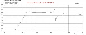

With 0.53x scale, there is a bass overshoot from a too-large of a cabinet:

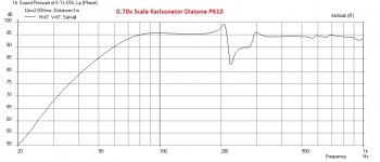

Hi Vitorio,
The P610 has a very soft suspension and large Vas - so requires a large cabinet to reach its full bass extension. It can work in a rather large Karlsonator and even at 0.70x scale, the -3dB is around 67Hz. The response is very smooth though and more like a "PA" response with 95dB sensitivity at 2.83v. It might be very good if assisted with a sub.
Thanks for the simulations, X. 85.7dB is a bit of a let down. It's maybe suitable for a powerful amp, but will not work with my ACA. Would a 25W Pass amp be powerful enough?

No hurry XRK. I was only answering a request for 6" drivers. This "Diaclone" is a very nice speaker, I think it deserves more attention. A classic paper fullrange.
hey victorio. - here's why I think a stock Karlsonator 6 would work
The original Karlsonator 6 prototype was a bit less in depth than the plan as my friend only had so much scrap plywood.
L Cao F6 has a smaller Vas spec than your 610 - but a weaker motor.
For a single cone, L Cao F6 has the smoothest most extended treble response I've seen. Subjectively, with slapped acoustic upright bass, the attack wasn't as sharp as that of an old de-whizzed Fostex FE164 with stronger motor. But mids and treble were very nice and there was impressive sensitivity with F6 (compare it to BetsyK in the last graph above)
0.7 scale for that Diatone type 610 looks really good in X's Akabak simulation.

The Diatone clone has smooth treble too. Never sounds agressive.I own the ferrite version and worth the money paid. It`s not very far from a Pluvia 7HD and have more sensitivity. I don't know if alnico version is better, never heard it.
Incidentally, I plugged Diaclones in a FrugelHorn MK3 and works. No much more bass than a 4", but it sounds ok.
