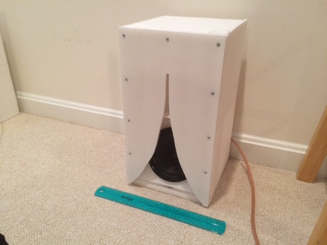

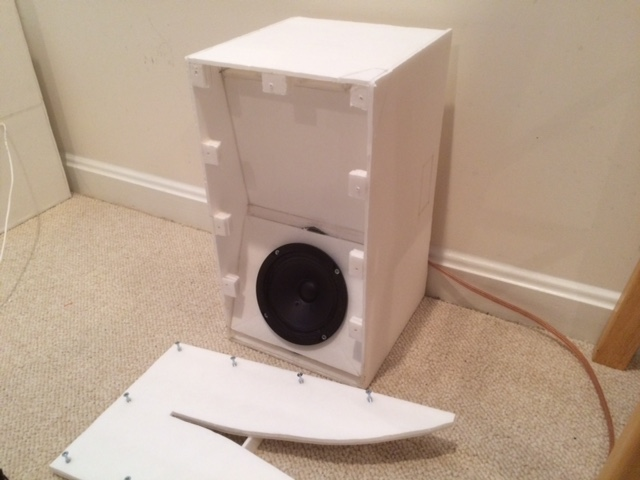

Ok, surgery was a success and this thing is loud and great bass punch! Love it!!! :D
One of the best values in full range higher SPL drivers.
Photos...
474549d1427659994-mini-karlsonator-0-53x-dual-tc9fds-0.53x-knator-pa130-8-photo-no-k.png
474550d1427659994-mini-karlsonator-0-53x-dual-tc9fds-0.53x-knator-pa130-8-photo-k.png

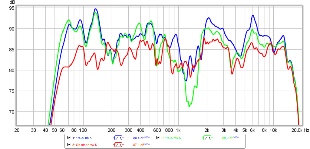

0.53x K'nator with PA130-8 Measurements
The 0.53x K'nator with K-aperture does a good job in the frequency response department: about +/-3.5dB over most of the range (this is very good for a K without any EQ). The response on the floor and against a wall(1/4-pi has enhanced bass but at the expense of a large floor bounce cancellation. When placed on a stool up high, the 1.2kHz dip goes away and the exaggerated peaks actually smooth out.
Here are the frequency response measurements (blue is without K-aperture, green is with K-aperture & on floor, red is with K-aperture & on stand):

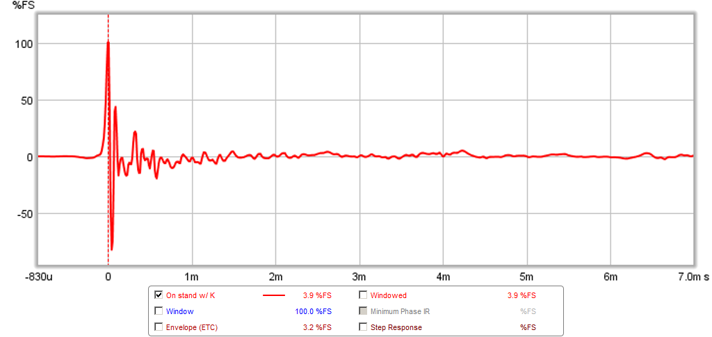

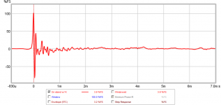

Here is the Impulse Response:
474640d1427700312-mini-karlsonator-0-53x-dual-tc9fds-0.53x-knator-pa130-8-ir-0.5m.png

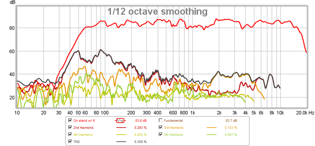

Here is the Harmonic Distortion:
474641d1427700312-mini-karlsonator-0-53x-dual-tc9fds-0.53x-knator-pa130-8-hd-0.5m.png

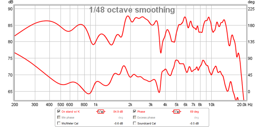

Here is the absolute phase and frequency response in high res scale (4ms gate and 1/48th oct smoothing):
474642d1427700312-mini-karlsonator-0-53x-dual-tc9fds-0.53x-knator-pa130-8-phase-0.5m.png
I think that the variation over the 60Hz to 15kHz is quite minimal given a K-aperture on the front. This helps contribute to a very clean musical sound.

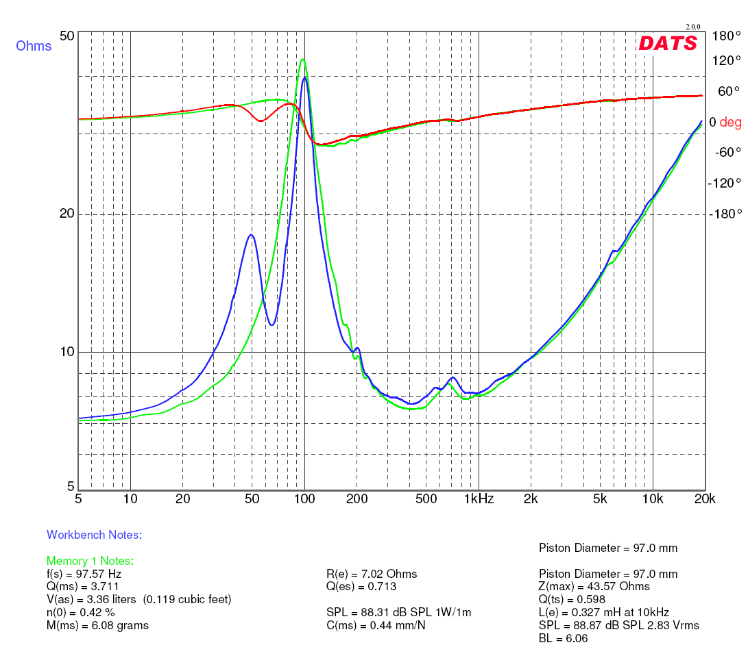

Here is the impedance sweep of the speaker (with bare driver sweep):
474644d1427701289-mini-karlsonator-0-53x-dual-tc9fds-0.53x-knator-pa130-8-impedance.png

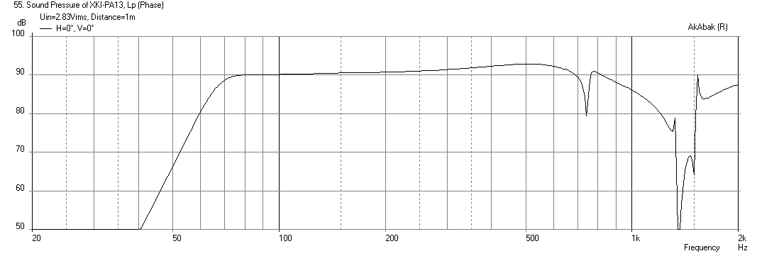

A PA130-8 in an XKi needs to be tuned a bit higher at 73Hz but produces a pretty high bass SPL of about 90 dB down to 67Hz (-3dB). The box is 7in wide x 7.25in deep x 12in high approximately 0.35 cu ft - similar in size to a 0.4x Karlsonator. So quite small but with pretty good punch covering below 80Hz for ability to get the first overtone of 41Hz bass. Box uses 7in wide x 0.75in high x 9.0in long vent. 7.5 liter rear chamber and 2.5 liter front chamber. Max SPL is 98 dB at 2mm xmax.
Freq response at 1m and 2.83v:
In a way it's kind of like a more powerful 0.4x Karlsonator.
that should make a cool 2.1 system with a powered subwoofer - are those internal box dimensions? is that destructive dip prediction what I've seen in some K12 with too small area single vent?
this case was worse than a sealed rear chamber- it seemed to play and measure ok when I opened the area up a bit
Founder of XSA-Labs
Joined 2012

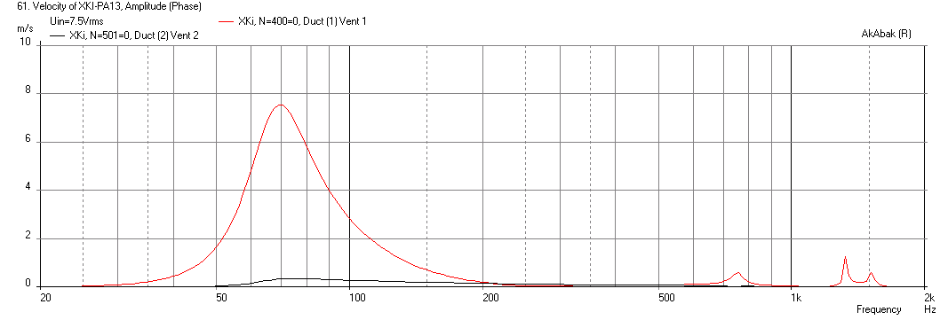

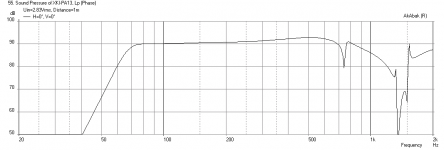

The velocity in the vent shows up as a minor couple of resonance velocity peaks that will cause a little bit of cancellation at 750Hz and 1300Hz and 1500Hz. They will be minor dips though as you can see in the velocity plot for the vent.
