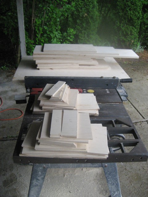

I was set to make a pair of .53s, but then I decided to make two pair of .40s. Then my son and my niece can each have a pair for their tiny apartments at those times when IEMs won't suffice.
The piles of cut wood are in the foreground. The wood in the background is for a 25HZ tapped horn sub deigned by Lilmike.
Very nice. Looking forward to seeing your build of the K'nators and the Lilmike sub.

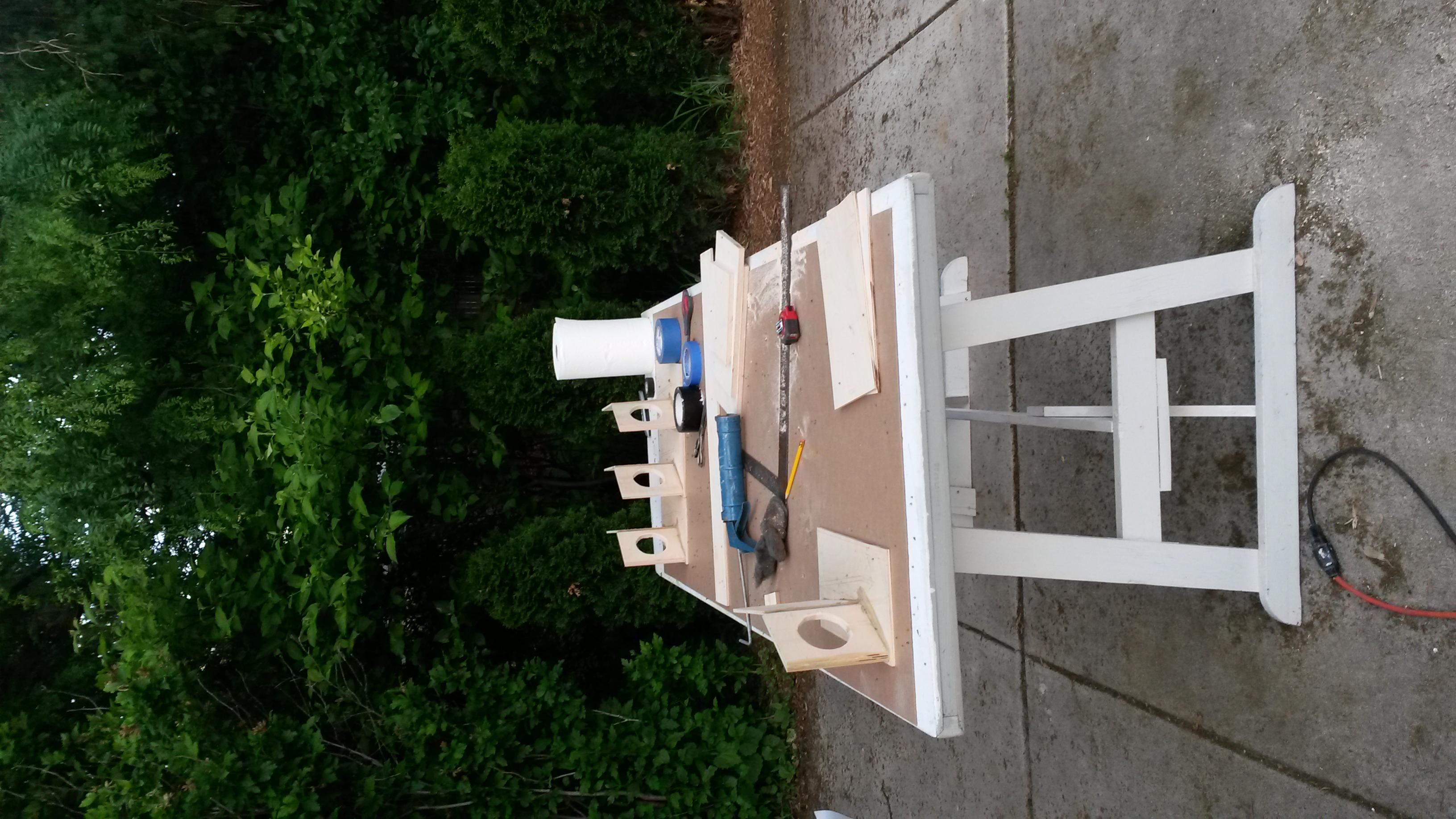

Two pairs of .40x are underway. I'm making them out of .25 Baltic birch, but the motor-boards are .5 Baltic birch.
The pair of .53x I'm building will be entirely .5 stock.
