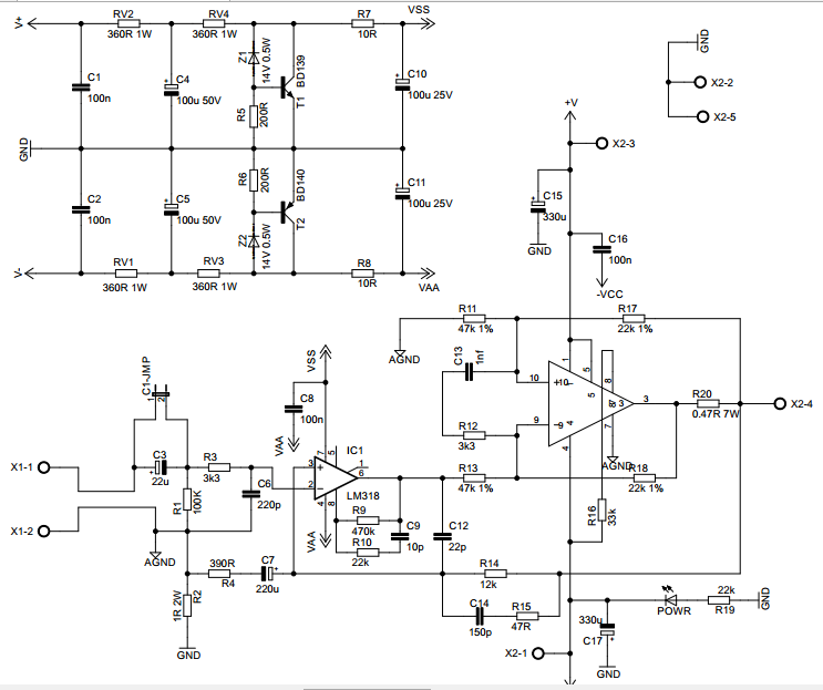

Finally wired up after a year in my cabinet. Got no problems encountered, initial power up is good.
Sound is good, which inspired me to create a module without built in power supply, for connecting with SMPS etc..
Supply for LM318 is RC + shunt, can be connected to external supply through optional header.

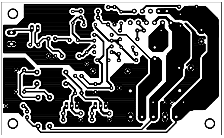

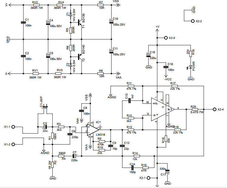

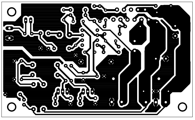

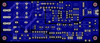

Free layout update
Size 3.8 x 2.3 inches
only 1 jumper
feel free to suggest improvements on pcb design

Slight update on pcb tracks
all poly caps = 5mm lead spacing
c3, c4, c5, c10, c11 = 8mm diameter
c7 - 10.5mm diameter
c15, c17 = 13mm diameter
jumper 2.5mm lead spacing
input terminal 5mm lead spacing
R20 = 7W TWM or SQM vertical resistor, or TO-220 2pin resistor

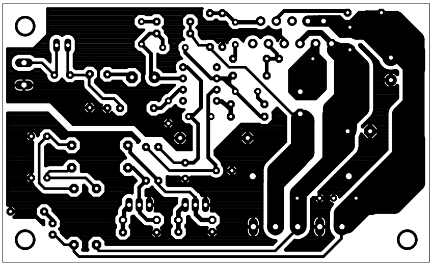

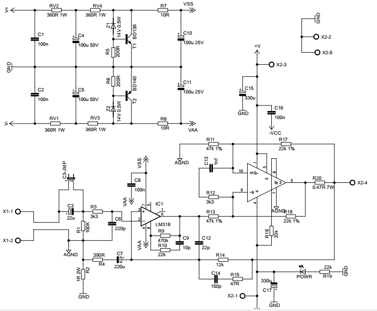

Try to connect R1, R2 and R4 closer together. Shorten the traces R2 and R14 to the speaker outputs. Speaker return is missing. Keep the loops as small as possible.
Thank you for your suggestion, the board is limited only to 1 layer and 3.8 x 2.3 inches so there will be compromises.
In my previous layout, speaker return is intended to be connected to the power supply star ground and +speaker should be connected to external speaker protect module.
Here is the updated layout.

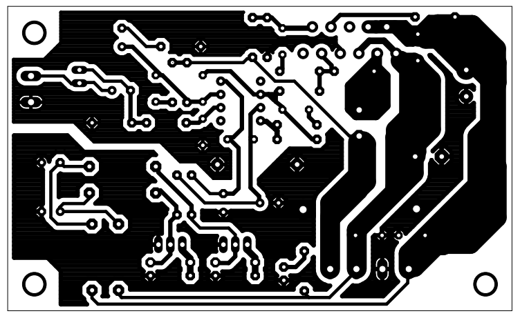

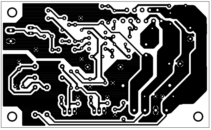

Deleted member 148505
See if this helps:
Rotate and move up/left C12, R14 and R15 so that they are next to R17. This should give you some room to move C7 down/left.
Making a PCB layout is the most frustrating thing ever. I am never really happy with what I design.
Yep balancing benefits and trade-offs :)
How about this.
no more suggestions, i guess it's nearly perfect. ;)
uploading final layout.

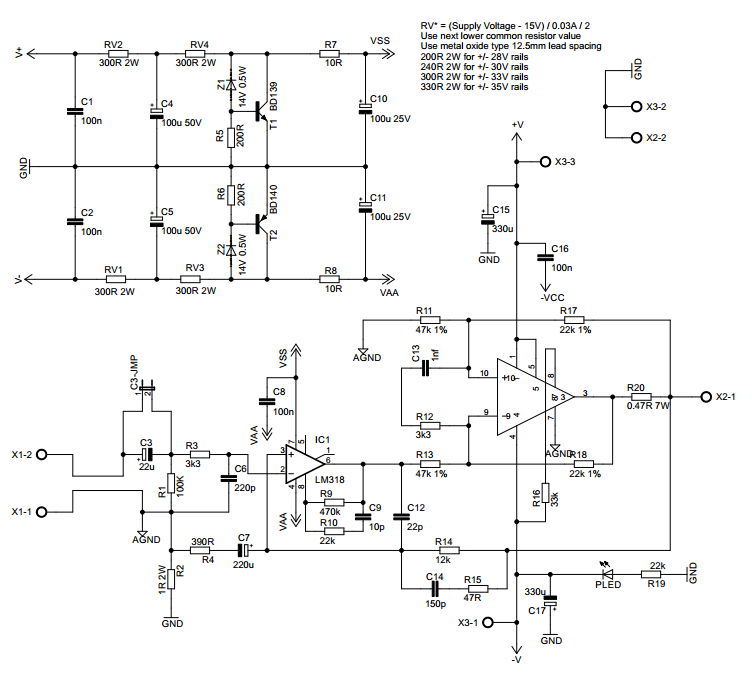

This one needs DC supply since it doesn't have onboard rectifiers.
Attached update.
