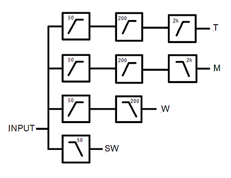

The theory of cascading filters is:
Lowpass and highpass filter sums correctly in a 2 way system. In 3-ways they don't - unless the xover frequences are more than a decade apart - In the mid channel phase lag from one xover will affect the phase at the other xover. The solution is to make 2 perfect 2-ways systems and cascading them - consider mid/high as the high part in a 2-way system.
In miniDSP you can only do that in the advanced mode, where you can duplicate the HP part of the low freq xover in the LP and the HP part of the high freq xover - as mentioned by someone else.

Note how in Linkwitz's crossover, the input for the high pass of the mid is not the input signal per se, but the output of the high pass for the woofer. That is because the woofer high pass filter will still cause altered magnitude and phase response even at the mid's high pass frequency.
Instead of using the output of the woofer high pass as the input to the mid high pass, you can duplicate the woofer high pass filter before the woofer high pass filter. That will have exactly the same effect. Like this:
Yes. Can MiniDSP do this... and how? This is exactly what I want to hear! That is similar to cascaded filter stages.
That will make MiniDSP perfect (well maybe not yet .. I'll reserve that for hires ADC/DAC
Thanks for the drawing also!

To further comment Macboy post, you can indeed build this exact configuration but only by using the miniDSP 4way Advanced plug-in allowing custom Biquad programming.
In advanced mode, you basically have access to 8 biquad per channel for the crossover only (see back of datasheet of 4way advanced plug-in for example). These biquad are typically used for the crossover section (LPF + HPF) in the basic mode. Each biquad is able to perform a 2nd order filter so that's how we can go up to 8th order on the LPF (4 biquad) and 8th order on the HPF (remaining 4). Makes sense?
Now to build the configuration shown by MacBoy, you simply need to calculate each filter biquad coeff separately and load the Biquad settings to each section as per the diagram.... Eventually allowing you to have that exact configuration.

I'm running a 4 way 4th order cascaded active crossover using AD825's. No additional noise with it in or out of the chain.
