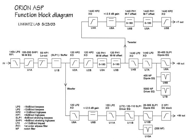

Davey, thank you very much that string works
. Now we have the recipe to implement circuit as complex and well-engineered as Orion ASP. In this case I have also found an easier way to do it.
The Circuit in question:
As discussed previously only MiniDSP has the capabilities to implement something like this compared to other products like DCX2496 as highlighted.
Slopes (obviously) ... ok
Phase alignment/allpass filters ... ok
Notch filters ... ok
Channel level ... ok
Shelving Lowpass filter ... ok
Master volume control ... ok
Cascaded filter stage topology ... ok
Linkwitz Transform ... ok (thanks to the netherlands DIYers!)
Here, one would need:
2x MiniDSP kit $200
1x Advanced 4-way crossover $10
2x MiniDSP kit $200

HP: 20Hz, 6db, BW.
LP: 1000Hz, 24db, LR.
EQ: 50Hz, +8db, Q=1.6, low-shelf.
Tweeter:
HP: 1000Hz, 24db, LR.
LP: bypass.
EQ: 4200Hz, -7db, Q=1.3, peak.
EQ: 9000Hz, +5db, Q=1.0, high-shelf.
Delay: This setting is a bit different since you're using a pure delay vice the all-pass filter of the Pluto ASP (or an all-pass created with the MiniDSP advanced plug-in.)
Here's a good method to find the correct setting for tweeter delay. Setup your measurement microphone about a meter away on-axis, reverse polarity of the tweeter and then adjust the tweeter delay setting until the notch depth at the crossover frequency (about 1000hz in this case) is maximum. Then return tweeter polarity to normal. (My setting was 0.3mS.)
Gain: Adjust relative gain between woofer/tweeter to your liking. An approximate 6db difference is a good starting point.
I actually have a PLUTO ASP configured with the 2.0 revision and so could make/save a transfer function measurement for a reference and then adjust the MiniDSP iteratively to match it exactly.
Dave.
sdsnyc,
You don't necessarily have to use the advanced plug-in to replicate the Pluto transfer functions. I haven't done the 2.1 yet, but I have done the 2.0. (IMHO, the 2.0 alignment is better sounding than the 2.1, but that's another subject.)
Anyways, here's a setup for the 2.0.
Woofer:
HP: 20Hz, 6db, BW.
Tweeter:
LP: bypass.
Dave.
