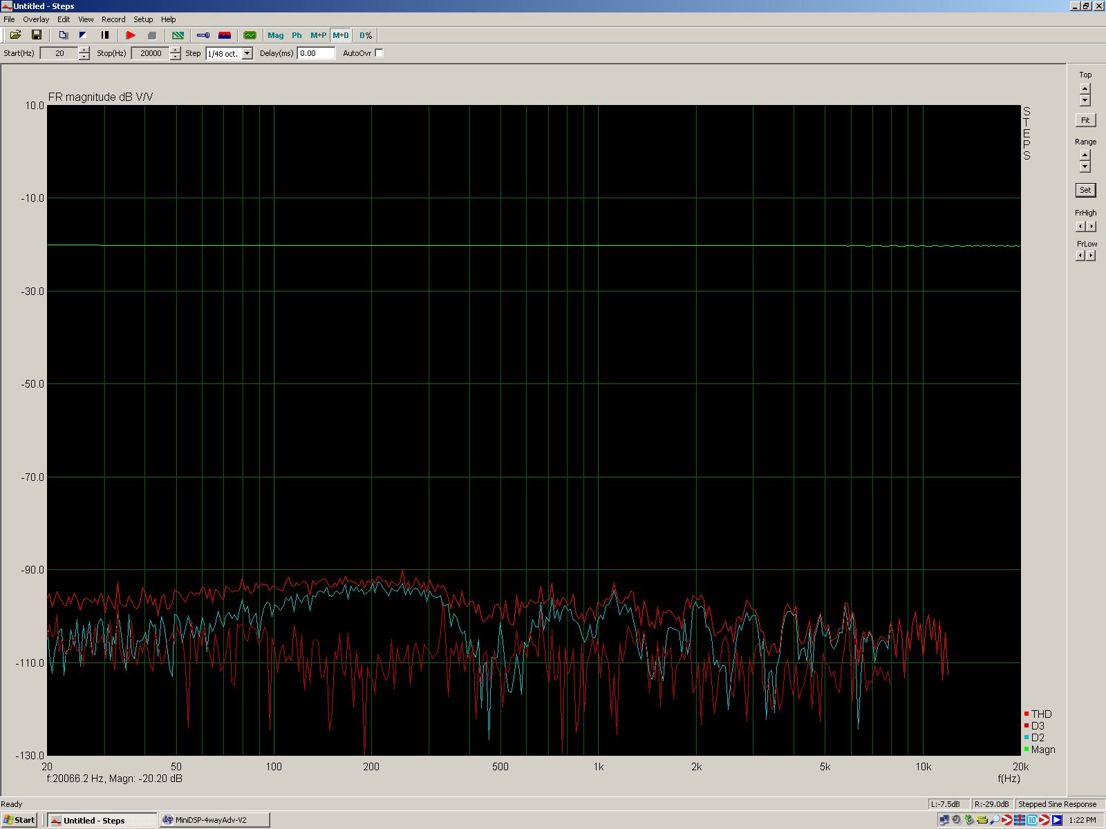

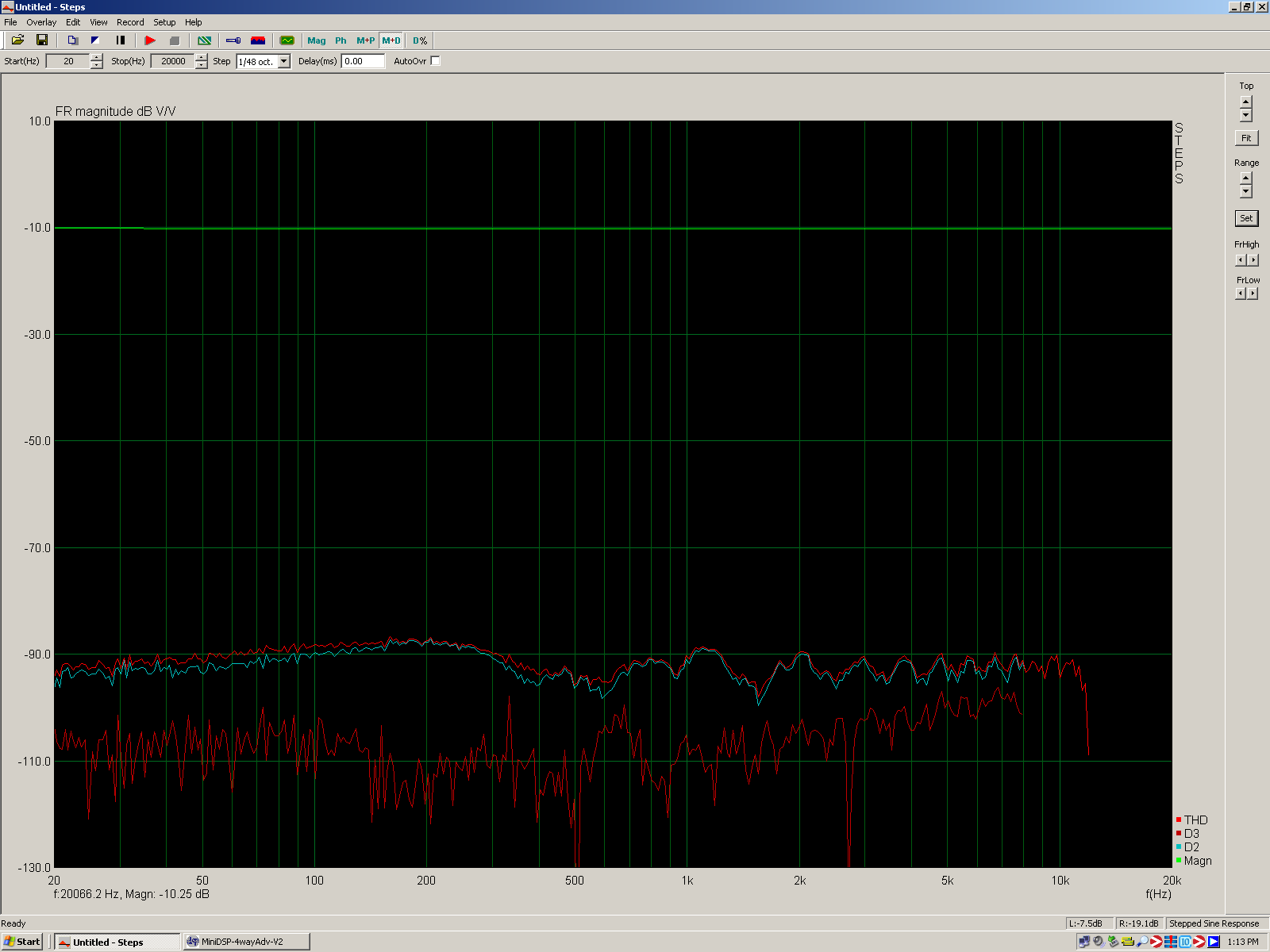

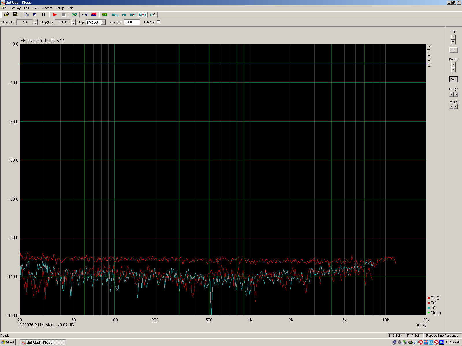

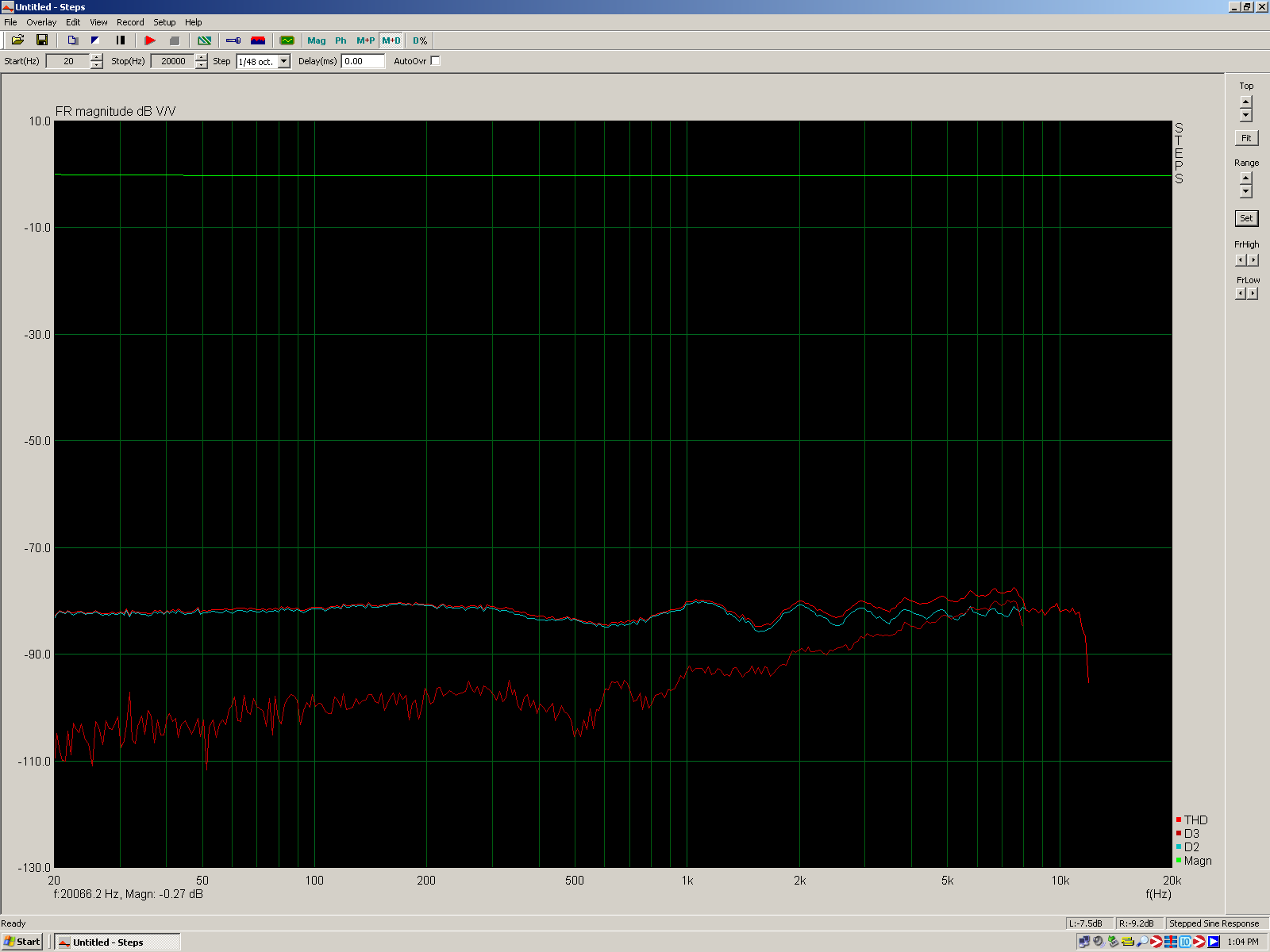

Regarding the distortion claim: Here are some distortion measurements performed on my MiniDSP unit. The "loopback" plot is a baseline measurement showing the residual distortion of my testing system. The other plots should be self-explanatory. (You folks can draw your own conclusions from the results.)
Dave.
Dave.
Sorry! I'm not using miniDSP! The THD increase I was referring to was seen in SoundEasy's signal generator. Davey, thanks for showing all these measurements - I'm probably going to be buying a couple of miniDSPs, so all this is nice to see.
