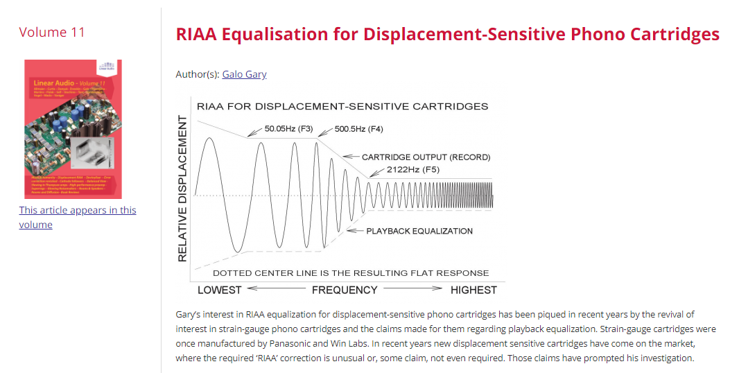

EDIT - found the article, this reads like the strain gauge carts that don't need any equalization at all. RIAA is there you can't ignore it.

The article is here: http://www.phaedrus-audio.com/DisC article_for Transform Media.pdf
Yes. In the sketch I use a shelf filter to provide full RIAA. It all works out very tidy and simple. I would be interested to try a simple 1/f response to listen to, after all its only eq and the ear accommodates within reason. But might as well get it right.

Are you guys aware of this article? I set the price to 0.10 (shop will not allow zero and it is to large to attach here)?

Basically Gary is in complete agreement over EQ for displacement sensitive carts
an RIAA record is cut constant-velocity
below 50.05 Hz, constant-displacement between 50.05 Hz and 500.5 Hz, constant-velocity between
500.5 Hz and 2122 Hz, and constant-displacement above 2122 Hz.
He also does quite a lot of digging and discovers (as KevinK has) that the panasonic capsule isn't a perfect strain gauge so additional eq is required to render a flat response. And gives a couple of examples of how the eq can be done.
A very well researched and written article in fact.
