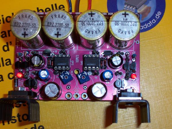

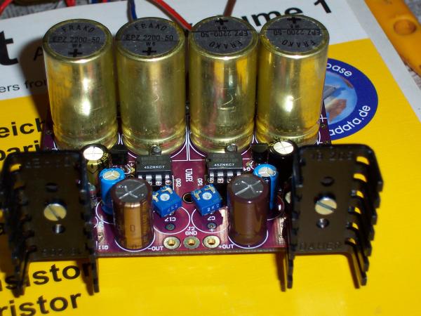

Received my boards some days ago, good quality PCBs indeed.
Well, as I needed a little more 'flexibility', I used 2.2K trimmers, paralleled with 10K 0.6W film resistors, for R2 and R12.
1K 0.6W film for feedback.
This way I can easily adjust for the range I wanted to, that is, between +/-12V and +/-18V.
I used one of the holes of the unused caps, C7 and C17.
The adjustment works well, but if I had space I would use a series resistor with the trimmer. Because the adjustment is wider than what I needed.
Also, I'm using the 5.0V LM336, and a lower gain on the op-amp (OPA627BP).
For ZD1 and ZD2, I'm using 10V/1W zeners.
EDIT: I'm using Elna Silmic 100uF/25V output caps. Diodes are MUR1100.
Here it is.
