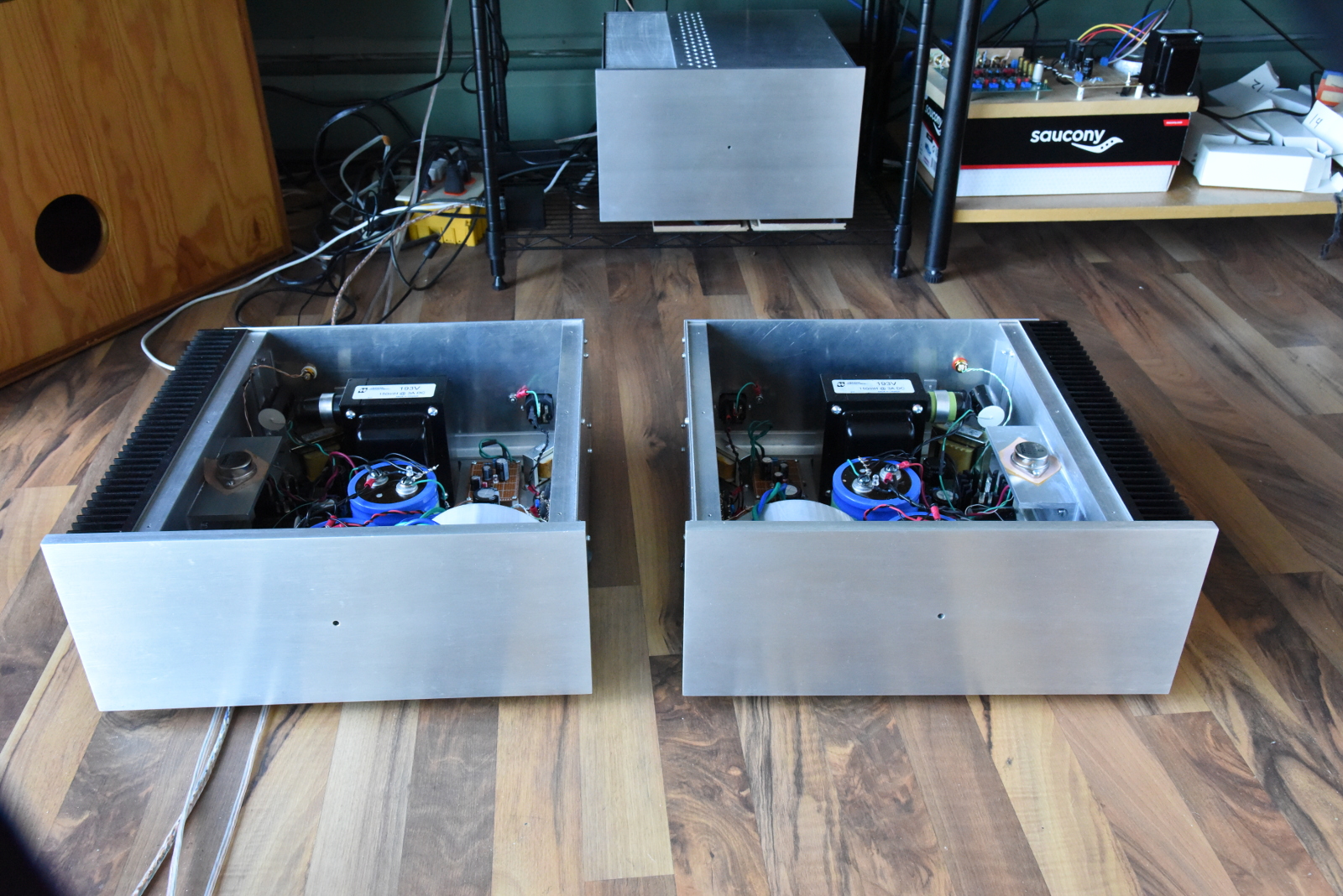

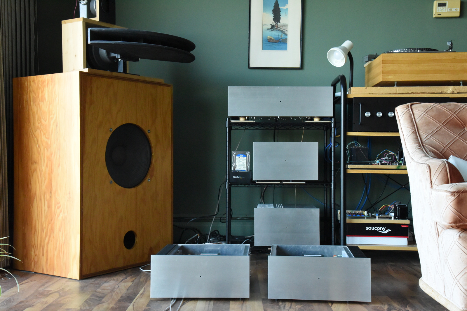

The latest addition to the SIT family. The baby 2SK180 monoblocks joining the 2SK82-2SJ28 amp, the BAF2015 THF-51S monoblocks, and the 2SK82 Luminaria preamp (barely visible).
I still need to add LED pilot lights to the front panels and then they go into the stereo system. Still deciding on LED colour.

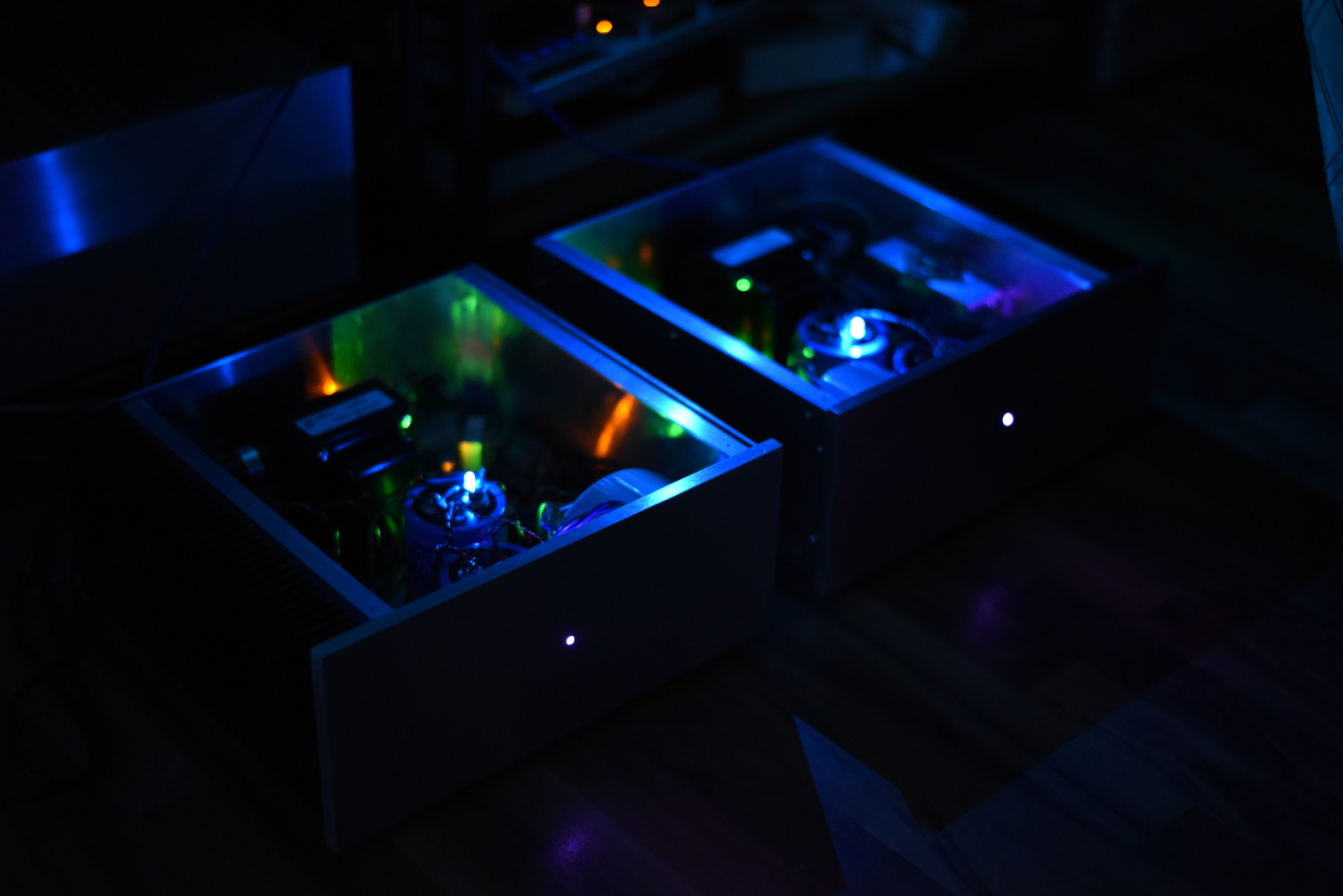

I finally got my amps into my main music system for listening yesterday. I replaced the BAF2015 THF-51S monoblocks which were powering the low frequency drivers of my biamped speaker system with the 2SK180 monoblocks. I use a modified version of the Pass LX-mini active crossover with the crossover frequency of 800 Hz. My 2SJ28 VFET follower amp powers the high frequencies. The preamp is a fixed bias version of the 2SK82 VFET Luminaria.
The speakers consists of JBL 2225s in about 9 cubic ft. cabinets in an EBS alignment. In room, they produce strong response to below 30 Hz. The higher frequencies are mainly handled by JBL 2445 compression drivers with JBL 2397 horns. JBL 2405s take care of the very upper frequencies and each is crossed-over using a single capacitor at about 9 kHz.
When I first played music with the new amps in place, I did not notice much in the change from the THF-51S amps. No obvious differences in sound were heard. The THF-51S and 2SK180 amps are quite different; one is configured as common source while the other as source follower. One probably has 10 times the harmonic distortion and twice the power. However, in my system powering the low frequency speakers, the overall results are very similar.
I have since spent quite a few hours listening to this new setup, and I can say that the new amps are equal to the BAF2015 THF-51S amps in doing the low frequency amplification duties. I thought that I would be to detect differences in sound, but what differences there are, my memory is not capable of providing an accurate comparison. Usually, I find that after listening to a system for a while, a change to it, if it is significant, is immediately obvious.
When I put the BAF2015 THF-51S into my system, replacing a Sony VFET amp, the TAN-5550, the changes were immediately obvious. The sound improved quite a bit. The most obvious thing was in the lower frequencies; the bass notes acquired tone and body. The bass also had much more weight.
Now, replacing the BAF2015 THF-51s with the 2SK180 did not produce any great differences. However, nothing was lost. The tunefullness and weight of the low frequencies are still there, and the coherence of the overall sound of the whole system remains. This system fills the whole room with music, and I can enjoy the sound anywhere.
Next, I will put the BAF2015 THF-51S amps back into the low end move the new 2SK180 follower amps to perform the high frequency duties.

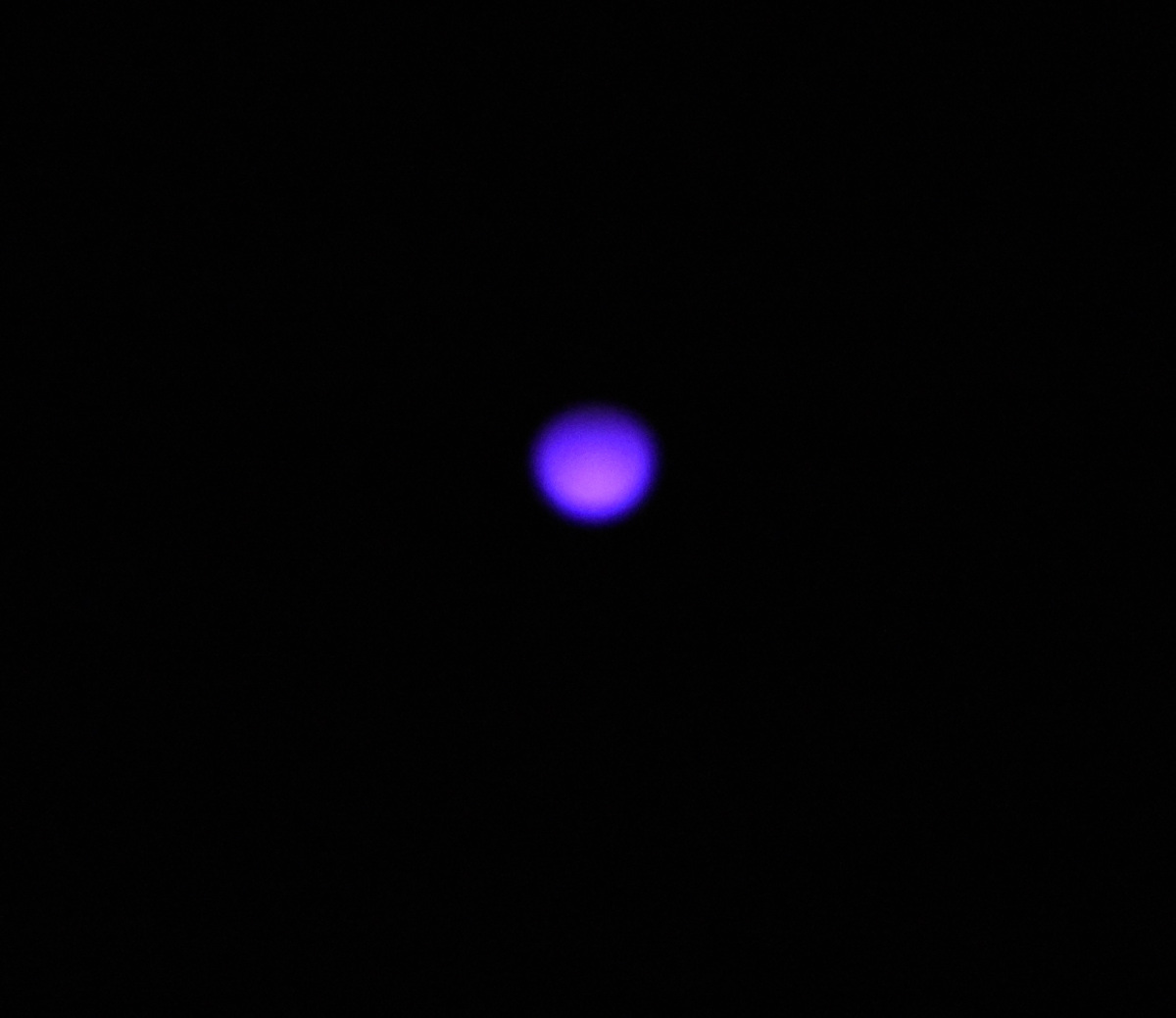

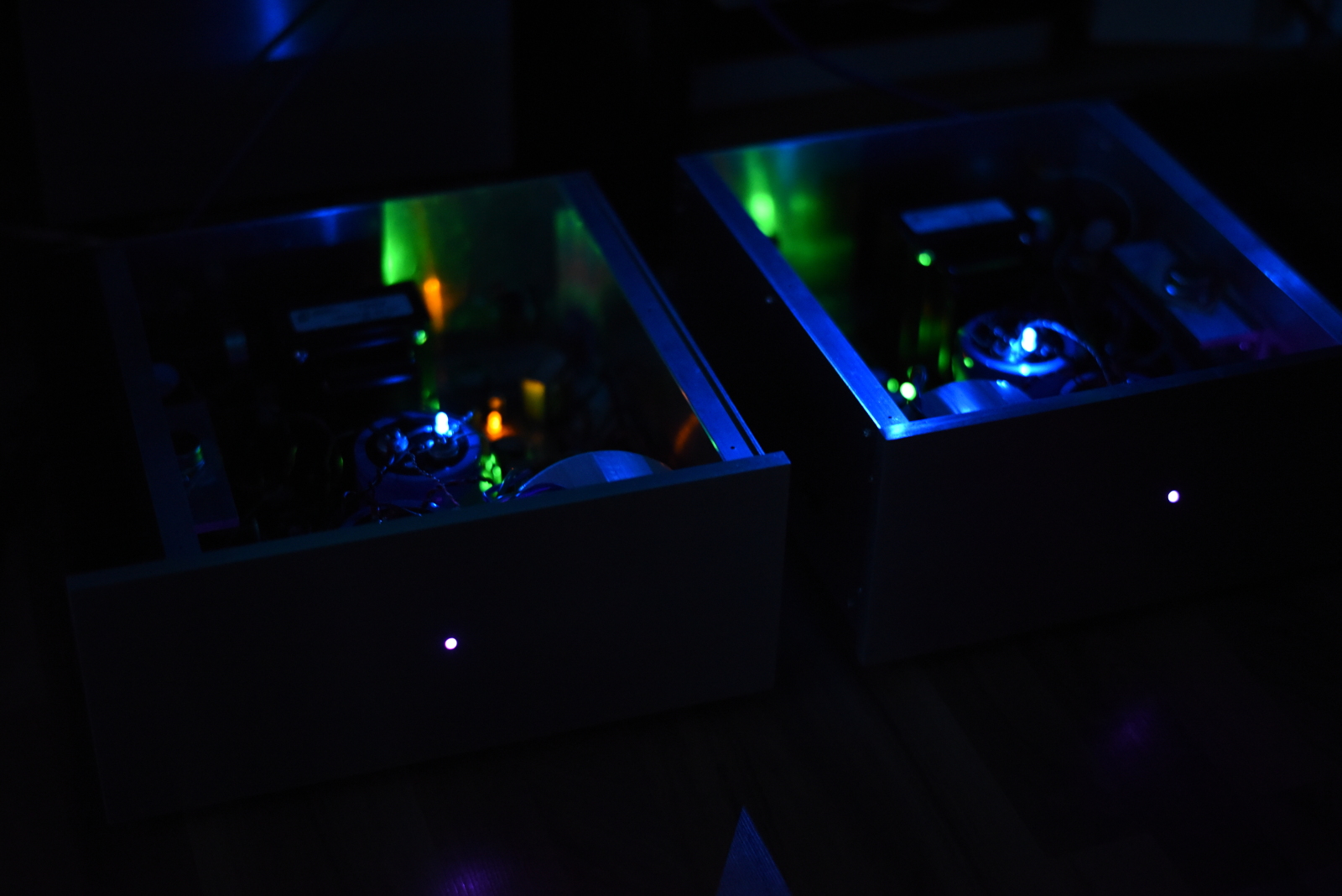

I did make a decision of which colour LED to use. The thing is, I had been using a lot of blue LEDs and I am running low. I have other colours and I'm at the point where I want to use what I've got instead of buying more stuff. So, I looked at my stash and found some RGB LEDs and thought, why not try something new; and I did. I used the red and blue sections of the LEDs together at equal current and the result is a pinkish hue. Always fun to try something different.

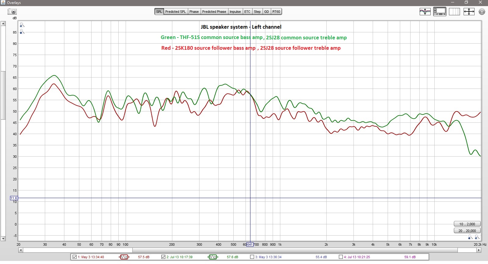

Joined 2010
Thank you, peppennino.
Here is a comparison of the left channel speaker showing the frequency response of the latest setup (2SK180 source follower amp for bass, and 2SJ28 source follower amp for treble) compared to a previous setup (THF-51S common source amp for bass and 2SJ28 common source amp for treble).
Not much difference in the bass (800 Hz crossover). The top end shows roll-off with the 2SJ28 common source amp. I had thought that my JBL 2405s were just getting old, but they are fine with the 2SJ28 source follower amp.
I am now listening to the 2SK180s powering the bass and will switch later to the THF-51S and see if I can hear any appreciable differences.
