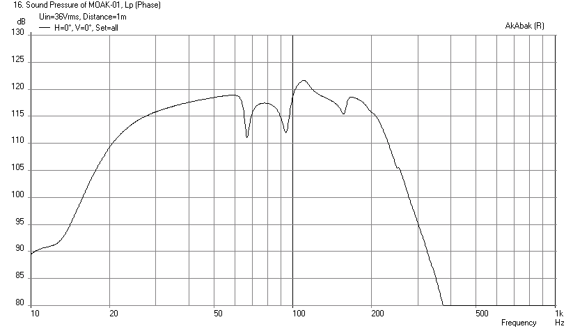

If you scaled the depth by 1.53x you will get the 0.63 meter depth. This is an approximate simulaton of the resulting response. It may still be sufficiently flat for you - I don't know.
Hi xrk971
Are you talking about this. I love it. It is more than good enough. Just keep in mind that I will be building these with the Leak Sandwich 13" woofers, which will have slightly lesser specs than the 15" AE Speakers. I just picked those because they have a low Qt, which is what I expect the Leaks to have. I have REW installed and I now still need an MMC (what is that, BTW? is it a USB mic?) to measure these drivers.
If I calculate 1.53x, the external width is 651mm, and this is too wide. For 1.53x the depth will be 690mm, and that can still work. I remeasured that wall, and the depth is 600mm, not 550mm, so 690mm will work. My problems is that my max width is 600mm, and even that is pushing it.
As soon as I have the Leaks measured I will give you the measurements. Then we can really get the best results. I am really looking forward to this!

The depth is 1.53x and the width is 1.4x per your requirements. The height is 2.5x still. I use the Dayton UMM-6 mic and really like it with REW. Is there a link for the Leak drivers?

It is a nice idea, however I need to XO at around 120Hz, and that sub looks UGLY up that high. It does go nice and low, though.
Deon
Then with any of the BP alignments you're limited to a ~two octave pass-band = a ~30 Hz Fb.
GM
Not with a ~120 Hz XO, at least not once room modes are factored in if you want good mid-bass 'slam', etc. unless your room is really large to push all its fundamentals down below ~35-40 Hz.

Actually, on the current point, I kind of agree with GM. You don't want to push a pipe/BP 'subwoofer' too low if crossing over as high as 120. The slot helps a bit to smooth response, but don't expect miracles. I think subjectively there will be a bit of a gutless sensation in the midbass where that null region is. IME, for a bass TQWT/TL that is needed for actual midbass, it is better to tune a bit higher and EQ the bottom end if needed.
The original K15 Karlson can take tons of EQ without the cone flopping around. Being a pipe/Karlson/BP hybrid, I suspect the 'Karlsonator' can't take as much, but won't need as much either.

It's all a bit moot now, until we know the specs of the Leak woofers. I wouldn't expect they'd be that similar to the AE lambda.
Why moot? Surely I am not the only nut out there that will want to build a pair of these, am I? I hope not so.
Oh, I don't mean the idea is moot, the idea is positively un-moot.
It's just that the size and tuning is impossible to predict for now, until we know the drivers' specs.
Then again, the Lambda drivers are probably more easily obtained for many people than vintage Leak sandwich woofers...
Still, my suggestion is to err somewhat on the side of higher tuning if these are going to be crossed at 120Hz. The lowest octave is going to get a lift from room gain anyway.

I think GregB means that until we see your Leak's TS params discussing the box geometry and such is moot. But if someone likes the performance predicted and will get the AE TD15M's then it is good as is.
GregB has a point about pushing the tuning higher up if you will use this indoors. The 20 Hz comes for free if you tune to hit 30 Hz - and my idea is why stop at using these as subs? I think they will go all the way up to 1 kHz (at least with the TD15M). Get a good CD and horn mounted on top and have a cool 2 way. Shrinking the cabinet to circa 48 in tall should hit 30 Hz and make the horn on top not too high above ear level.
