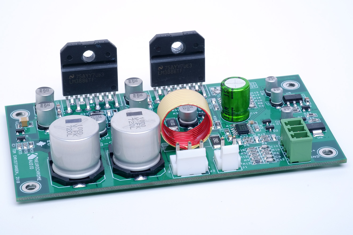

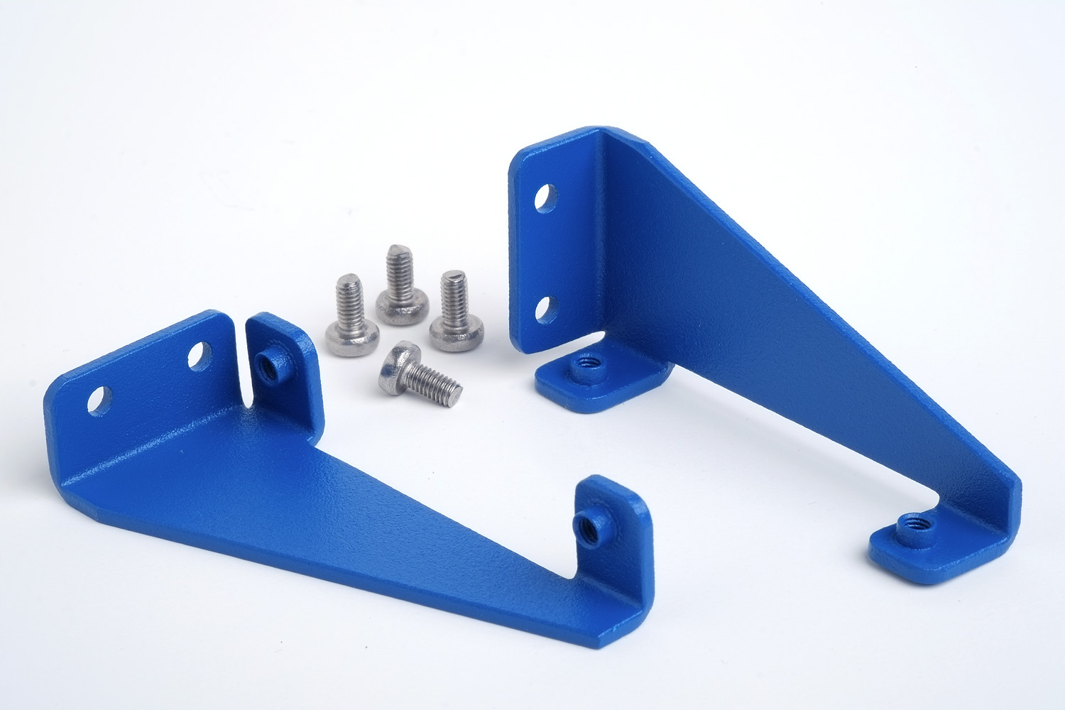

Thank you. Yeah, I rather like it. The final version will feature the same end brackets as the Modulus-686 (see attached) and an aluminum back plate. All you have to do is give it a think coat of thermal grease and bolt it to the heat sink.
Tom
