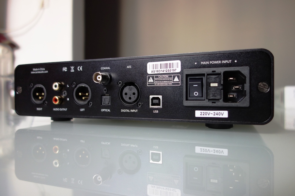

Does anyone know what the FPGA is handling on this dac? I noticed people preferred the sound of these aunes to even audio-gd gear which is well regarded. I was thinking this had some FPGA filtering somewhat like the chord just wondering if someone knows or has researched something of this?
I decided to share and discuss the modification of my Aune S16.
I changed all tantalum and electrolytic capacitors. I changed and opamps with Burson V5.
I replace IEC connector with Furutech FI-06 and RCA connectors with WBT.
Result is very good.
i think all your mods are useless!
the only thing you can do is replacing caps and opamps,your fantasy just stops there!
iam very sure that you have no multimeter in your home,because if you have one you should have measured the rails of the analog supply and you must got very surprised before go for new opamps!

Hi. Could you post any details and pics about this mods?trimed analoge supply rails ...MUSE decaplings,lowest ESR caps for digital power supply
- Digital Line Level
- Mod Aune S16
