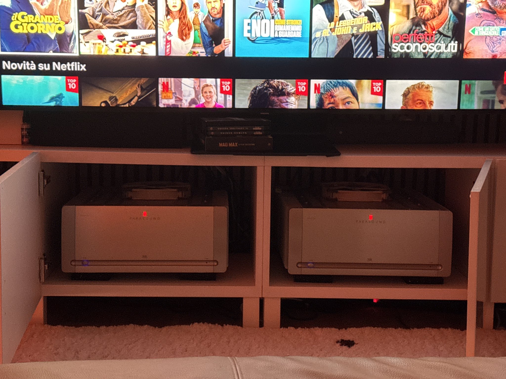

Yes but with the fan is way better , the problem is in the summer , they get very hot , even not there I remember in the old house
