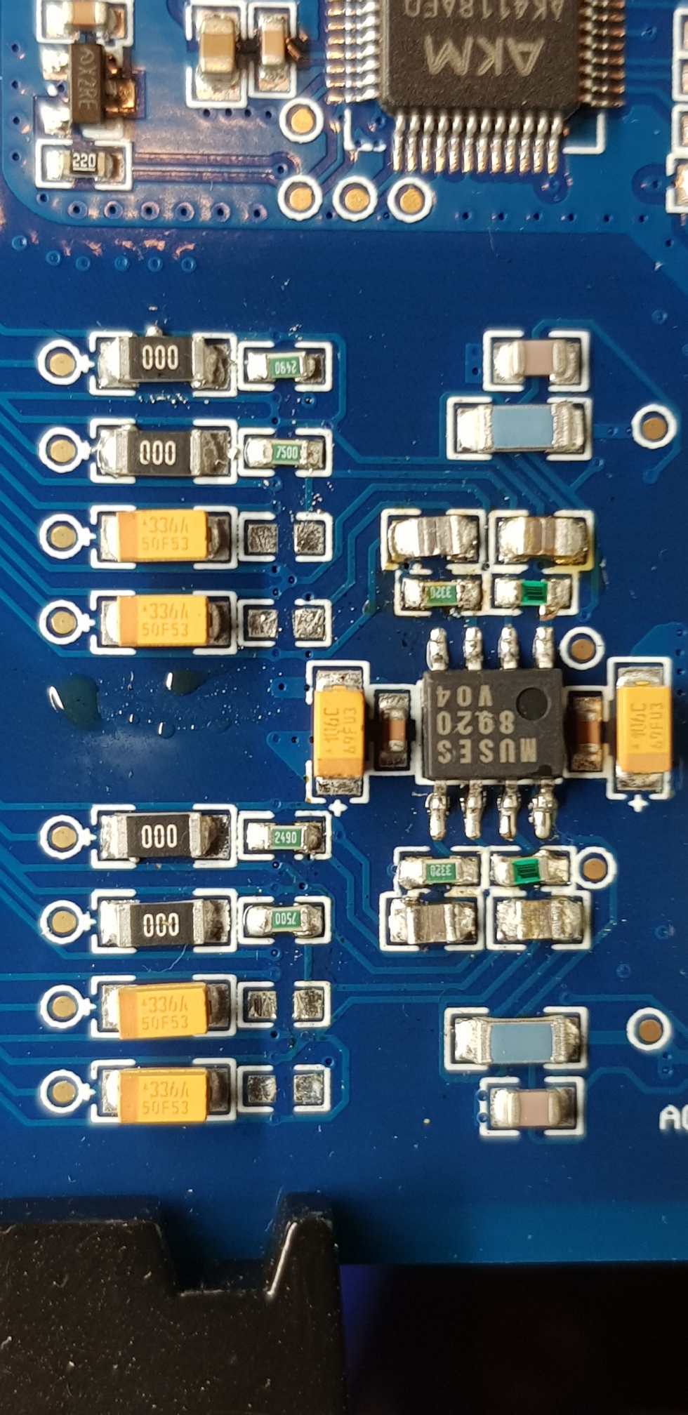

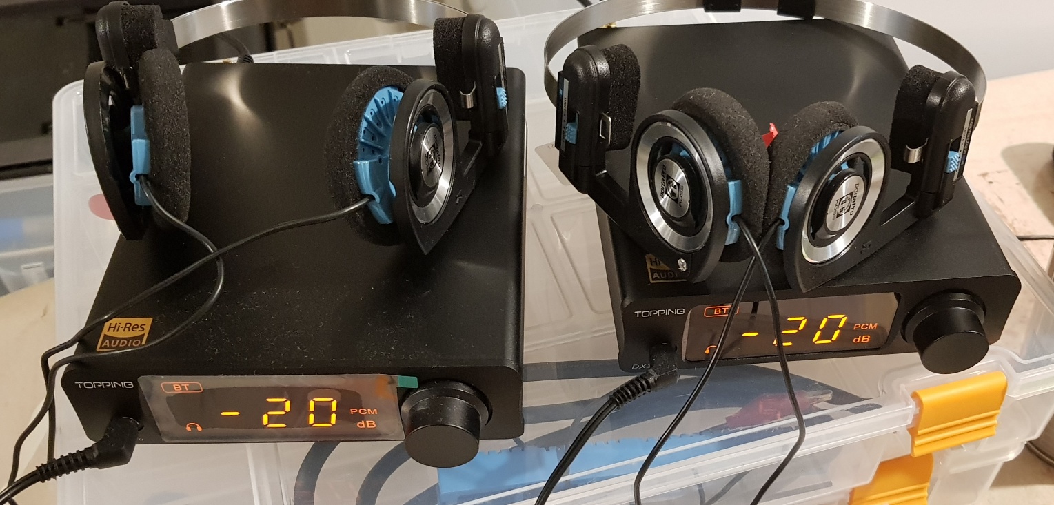

I finished the mod level 1 (all the parts arround the OPA including the OPA) !
I did some quick AB test with the second dx3pro and 2 koss porta pro headphones.
I find the improvements impressive !
I will have to make some tests in my HiFi set up that is using the topping D50.
I used a hot air gun, some solder paste to do all the job.
I just get 2 resistor to re heat with some flux because I probably put too many solder paste.

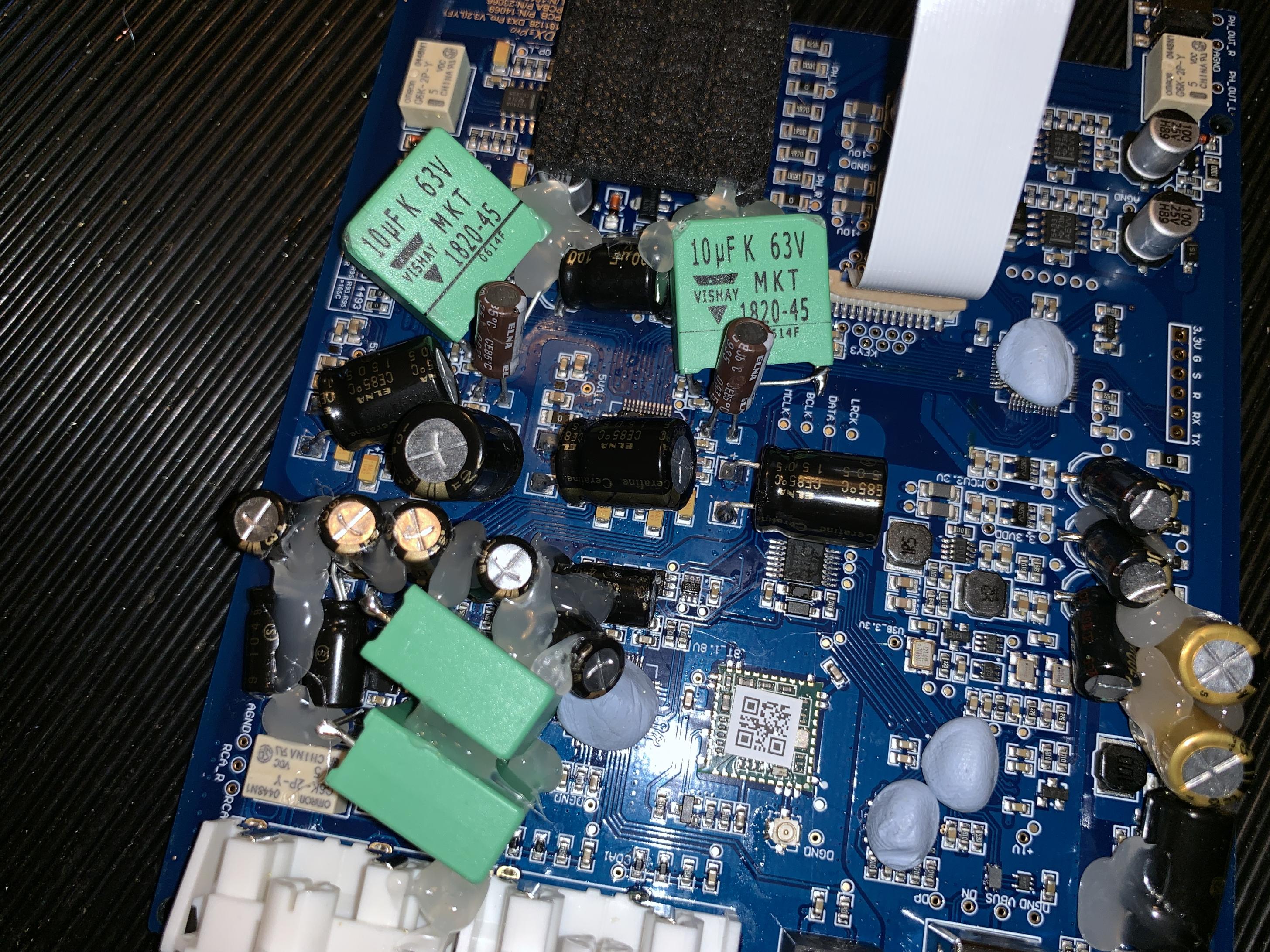

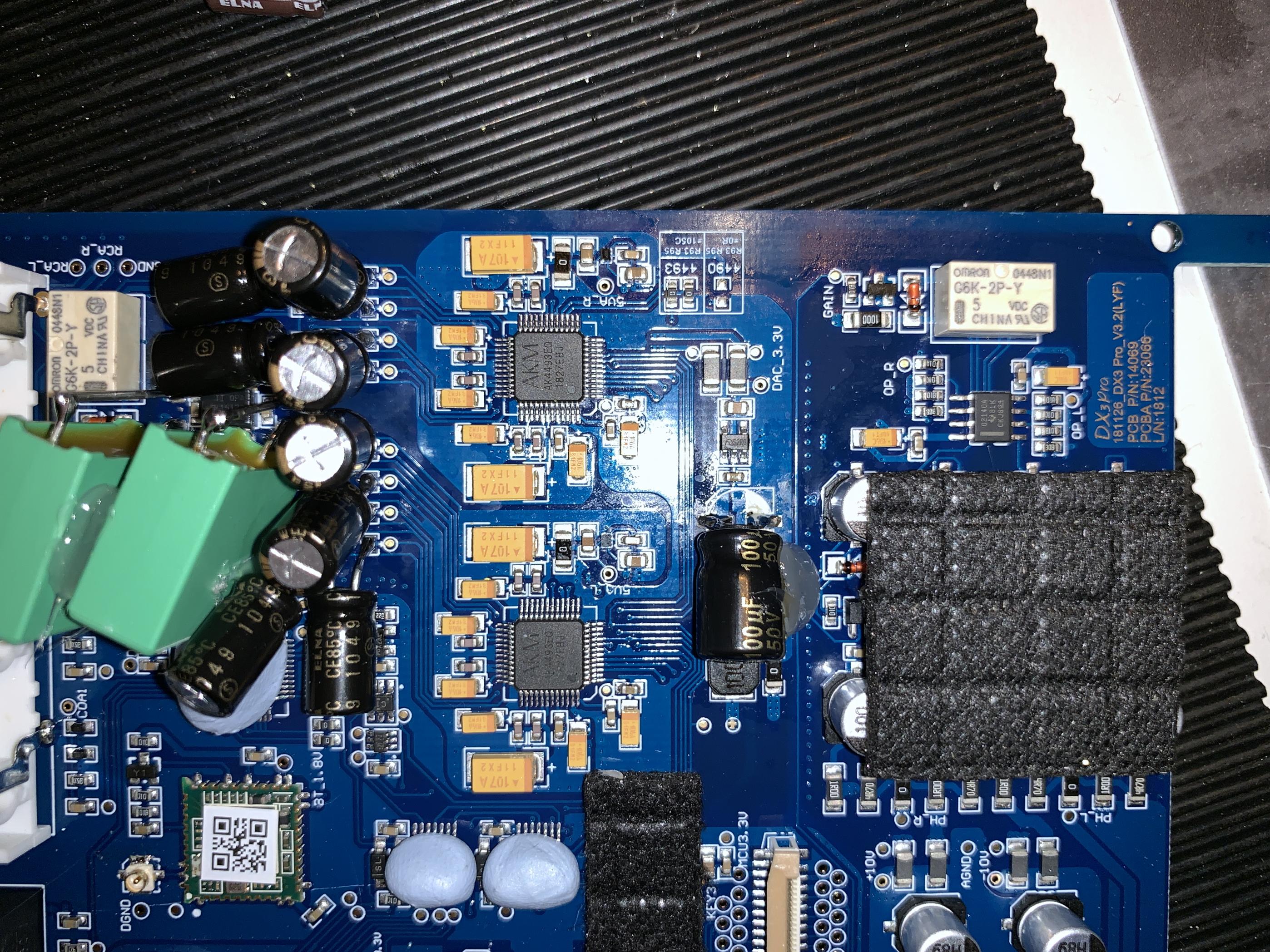

Massive improvement.
Used Elna Silic; Cerafine, Panasonic FM, Nichicon FineGold and Vishay /Ero MKT,
Powersupply is LPS from ebay (huge improvement only that)
🙂 Pics too.
To observe; i kept with orginal values execept input power i choose 220uF and the original 1612 opamp (i like it, compared it few yrs ago with amny others and 1611 and 1612 came out on top) if i would do more it would be a discrete opamp from ex Burson.
Also damped some part that was ringing with bitumen incl chassis. I use it only as a dac with USB.
Space is very limited and i had the caps already so well it worked but a bit tight, Anyway my DAC works flawless after modd.
After modd sound is very dynamic, fast and has good resolution. Bass is better (more and deeper but same time tighter) overall one thing that comes to mind is that it sounds very "airy" and transparent now. I'm very happy. With LPS i wonder how much i have to pay for something better...
