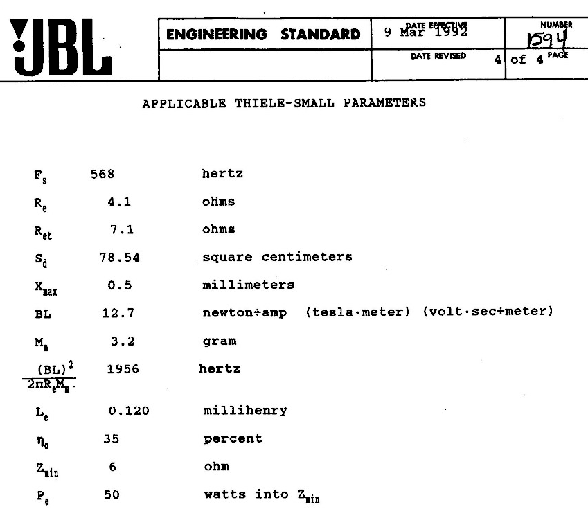

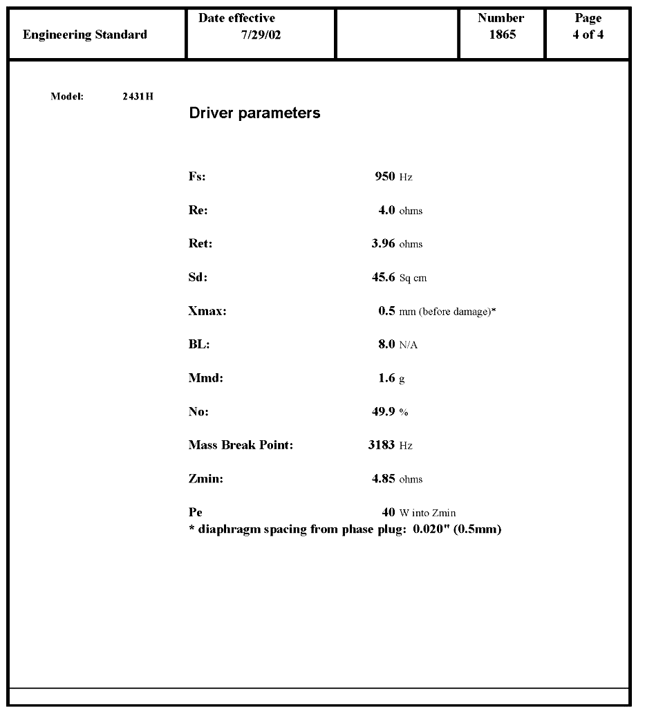

iirc i've seen jbl 243* data somewere on audioheritage..
close enough..JBL 2441 Hornresp input screen shot here:
http://www.diyaudio.com/forums/attachment.php?s=&postid=1536087&stamp=1213172475
How close do you believe these values are to real life?..
very unexpected imp. graph without back chamber!..More data here: Audio Psychosis • View topic - Simulating a B&C DE25

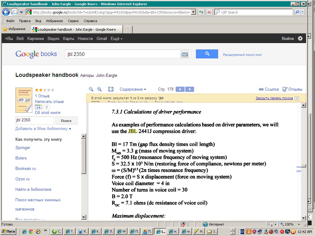

2431hiirc i've seen jbl 243* data somewere on audioheritage..
Can anyone confirm which parameters of those posted for the simplified models are actuals? Obviously the remaining parameters need to be contrived.
The contrived parameters are likely to be quirky because a typical compression driver has a second front chamber which is connected via the gap (slit) between the voice coil former and magnet. The Akabak model I have been playing with is EXTREMELY sensitive to the flow properties of this gap. The simple model assumes only a single chamber between diaphragm and perforated phase plug
The Akabak compression driver model uses 21 parameters. I could only find 2 parameter values quoted by B&C (Re and Le). The other 19 have to be guessed unless someone can provide them. Matching the SPL and Impedance values for the DE250 on a B&C ME45 waveguide has been fun but also frustrating because a few more actual values, physical or electrical measurements, would make things much easier. Trying to adjust 19 interactive parameters is akin to juggling jellyfish!
