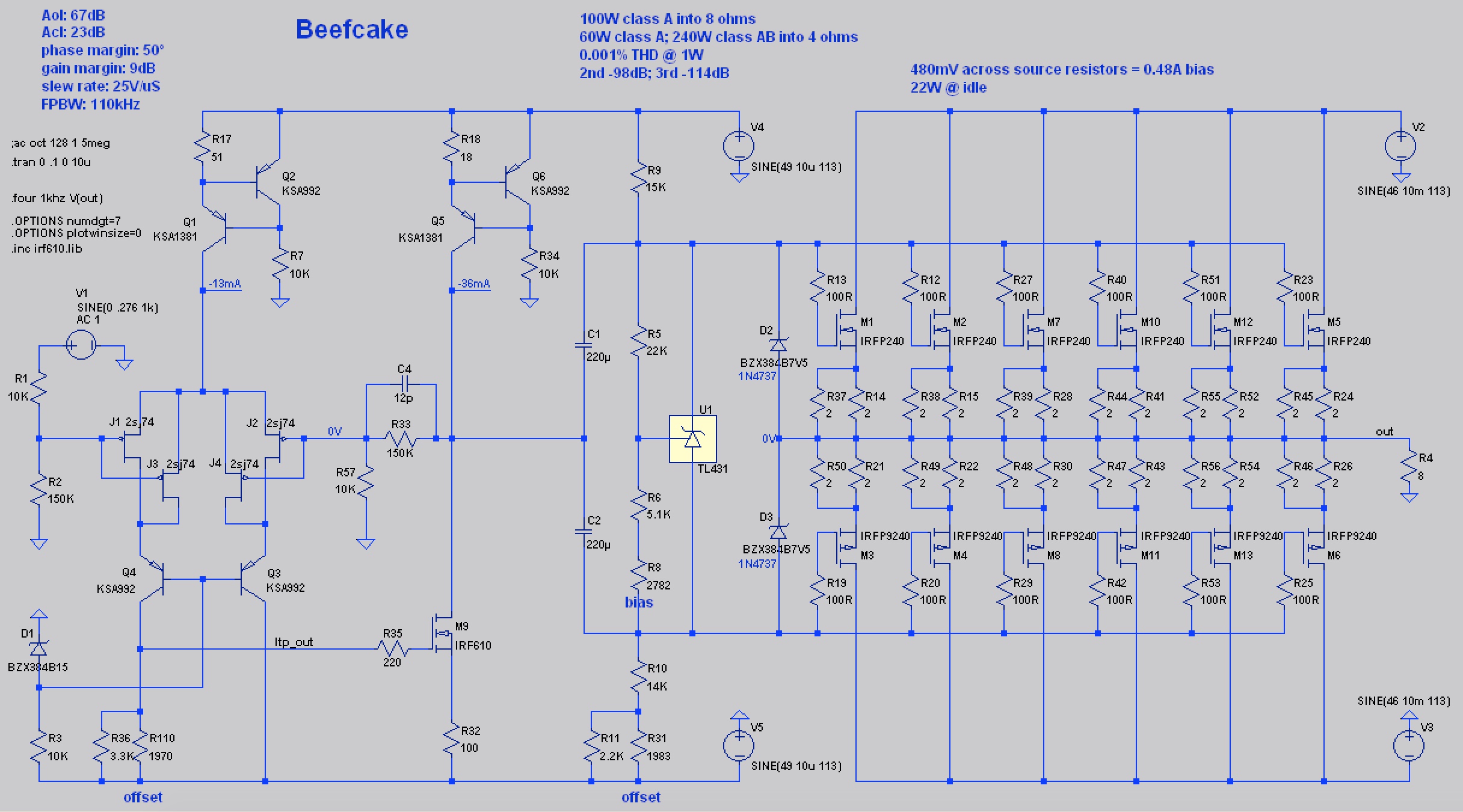

What was your simulation? Transistor, resistor values? Nominal current?
KSC1845s in the LTP, ZTX653/753 for VAS, 2N5551 for Vbe, MJE243/253 drivers.
LTSpice file attached.
Jeff.

Bang in some JFETs on the front, swap Q5 for a IRF9610, drop Q6 for a TL431 and add some nice n easy to drive FETs on the output... err, I think I've seen that somewhere before
Jeff,
I make the optimum 28 ohms for your circuit. I had to use a 2N5550 as my Spice doesn't have the 2N5551, but it should be the same.
Brian
Edit: Sorry, I was using 10mA current rather than your 8.5mA. Your optimum is 28 ohms.

Hi Brian,
Huh. So what am I doing wrong?
Ropt = (KT/qIe)(1 + R2/R1)
KT/q = 0.025V at room temp.
Spice shows me 7.64mA at the emitter of the 2N5551.
Ropt = (0.025/0.00764)(1 + 2000/987)
Ropt = (3.27)(3.03)
Ropt = 9.9
...Bang in some JFETs on the front, swap Q5 for a IRF9610, drop Q6 for a TL431 and add some nice n easy to drive FETs on the output... err, I think I've seen that somewhere before![]()
The TL431s in the CCSes turned out to need stabilising which made them more trouble than they were worth. I've gone back to standard 2-BJT CCSes:
Jeff.
Your only mistake is to use Hawksford's formula. It makes some simplifying assumptions and does not reflect real circuit behaviour.Hi Brian,
He he... it was probably some of those simplifying assumptions that allowed me to understand it at all. 😉
Simplified formula were meant for those didn't have access to simulator. With simulator we do .step param 😀

The scheme is Spectral revised by Norma Audio
if you have suggestions for the first stage, I am grateful
the original drivers were Hitachi 2SK 216 and complement 2SJ 79, no more products, but can be replaced.
My problem is the Dual j fet input and input stage
I couldn't find the Norma Audio schematic. The zeners between output gates are strange. To bias the latfets two diodes are sufficient. The zener is usually used for gate (Vgs max) protection, but then the connection is wrong.
You don't have to use dual JFET for the input. Two single JFETs would be better than dual BJT (without modification to the schematic). Look up BF862 (its SMD). Also discontinued but I think can be found. BF862 is good when Vds is low.
I own the 2N5564 and many BF862 but my Goldmund clone uses different metal JFET that I don't remember the type. You must have heard the Goldmund, right? Follow the Goldmund Clone threads, you may be able to get the part you're looking for.
in hurry I may have drawn quickly and mistaken some connection
however, the standard Norma 8.7 scheme is this
It is still drawn quickly and some detail, marginal, is left hanging and circled circled.
