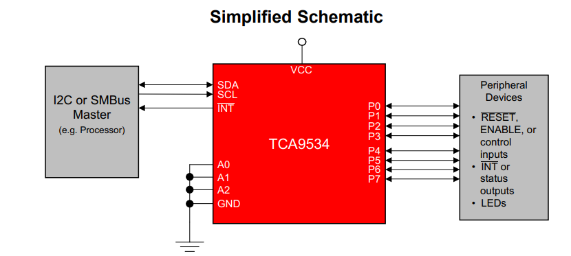

The TCA9534 is an I/O expander. It turns the serial I2C data into a parallel word and vice versa. They most likely deal with the front panel.
Yeah, I was just now figuring that out... It would appear that they just control the front buttons, maybe also the LED colors on the buttons. It would appear that the other connection area by the ATtiny is really what I'm going for...
This is the starting point:
The TCA9534 open-drain interrupt (INT) output is activated when any input state differs from its corresponding input Port register state. It is used to indicate to the system master that an input state has changed.
Care to show the TCA9534 and its surroundings in great detail, focus, and well-lit?

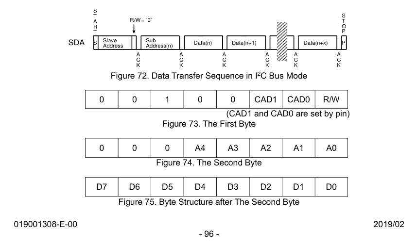

(from the AK4499 2019 DS)
<oops, my pic isn't from AK4499EX, rather the original non-EX. However seems the address is the same>
Having looked through the AK4499EX register file there are only 3 registers and I'm not seeing any bits there for selecting the digital filter. They only seem present in AK4499 (original 2019 version) which offers six options. If your chips really are -EX then it might turn out this thread has been in vain.
