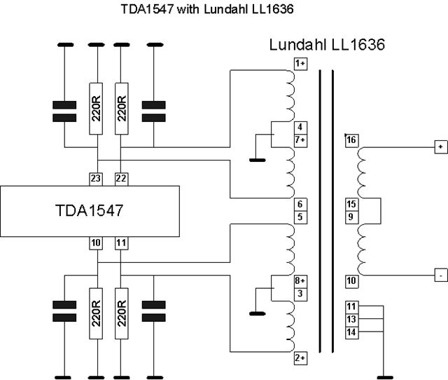

TDA1547
First of all a Happy Newyear to all of you ;-)
And now my question. I would like to use the DAC R (pins 11 and 10) and DAC L (pins 22 and 23) signals so I can bypass the internal OPA. I read somewere that these current outputs have a maximum of 0,1mA output. Is that correct?
Does anyone know what is the optimal load (resistor) value to create a passive I/V?
In my case the TDA1547 is used in my TEAC VRDS10 and used in dual differential mode. So one TDA for LEFT and one for the RIGHT channel. That gives already 0,2mA per channel. And I plan (TDA's already ordered) to piggy-back the TDA, so I wil have 0,4mA per channel Which still is very low.
I also have a ZAPfilter2 (http://www.lcaudio.com/index.php?page=6) which is capable of I/V conversion, but I don't know if 0,4mA is enough. Can't find any specs.
Another option is to use a step-up transformer. I prepared a little schema using a Lundahl LL1636 (http://www.lundahl.se/pdfs/datash/1636.pdf) to achieve a 2V ouput voltage. See attached drawing. Any comments on this?
regards, Theo ;-)

I've done mods to a TDA1547 in a CD950, just one dac chip there.
Though I don't have the D1 stage. I'm listening to an AD844 I/V stage with a 6.8 k Resistor. (times four)
This is followed by a discrete differential to single ended output stage. The differential stage also has some voltage gain and the output stage is just a class A emitter follower. Simple first order filtering in between.
Sounds pretty decent, and definitely better then the on chip I/V opamps, even with better opamps in the filter chain. Just more relaxed, better bass and much less listening fatigue.
Clock mods too, but that's another story...
Power for this comes through a dedicated analog supply with shunts close to the stages, 4 in total.
Your drawing isn't shown...
HTH
Diego
