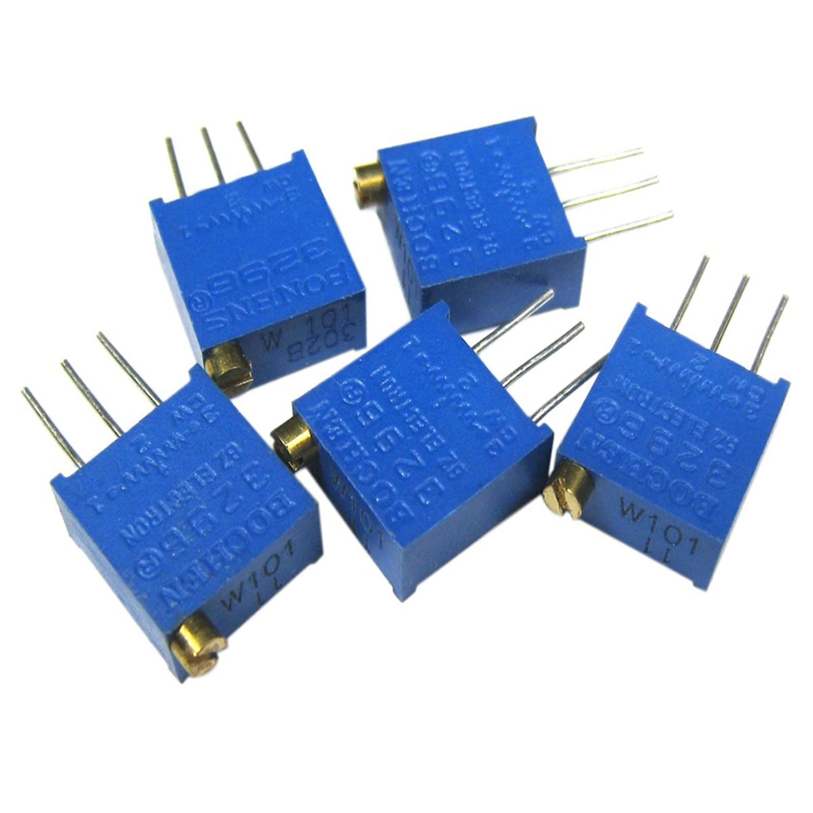

#14Q 401, Q 402 do run even with 1,1 V - later I would remove the whole current network and replace it with just one trimmer each. Because the whole component jungle also modulates the sound with noise.
I seem to be unable to locate Q 401 and Q 402 neither in the manual nor on the actual board. And pardon the ignorance, but how does one connect this trimmer exactly? What kind of trimmer should I be looking to purchase? When we talk about ground are we talking to the same negative lead from the speakers or is there another place I should be looking for ground. 120kOhm I reckon is achieved by adjusting the aforementioned trimmer.I currently have Q 401 and Q 402 connected via a 2 MOhm trimmer. I have also removed R 407 and R 408. Base ground about 120 kOhm. Now it sounds very seductive, almost magical;-)

Remove R407 and R 408 while the trimmer installation.

Q 401 and Q 402 are the very first input transistors. This is difficult to recognize on the circuit diagram. These should be closest to the newly laid input cable.#14
Trimmer: I mostly use these things. They can be set very precisely and sound even better than most fixed resistors.
Yea: ground = negative load from the speakers too. To be on the safe side, simply connect a Ohm meter to speaker minus or cinch minus or power supply ground.
120 kOhm will be the set value between base (of Q 401 and Q 402) and ground. I will probably use a lower trimmer later, perhaps 500 k Ohm. The value between base and ground should then be less than 50 kOhm. Let's see.
