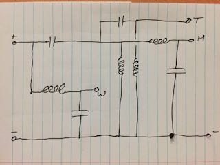

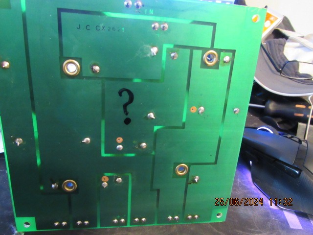

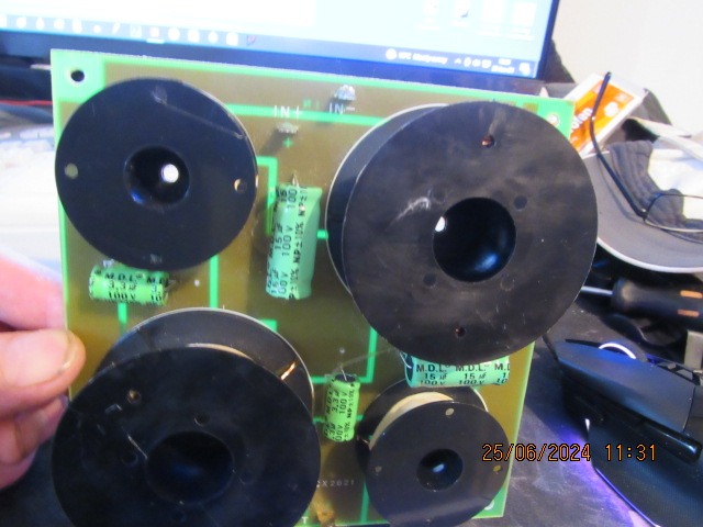

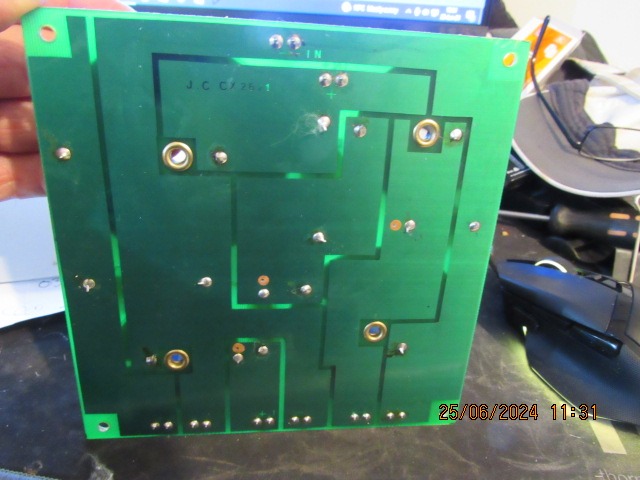

I have an Oriental grass problem, I'm bamboozled.
Already suffering under my poor understanding of electronics I can't get my head around how this XO is supposed to work
The section marked with the query? only seems to connected with the input via that 15uF capacitor which the 3.3uF tweeter capacitor is cascaded off. Doesn't that reduce the value of the total capacitance in the tweeter circuit to ~ 2.7uF ?
Can't say that I've seen it before either, but the cascaded high pass sections shouldn't effect the tweeters response, while providing it with a little better protection from the bass.... If you're going to try a better cap, you'll probably need to replace both to make an improvement.
