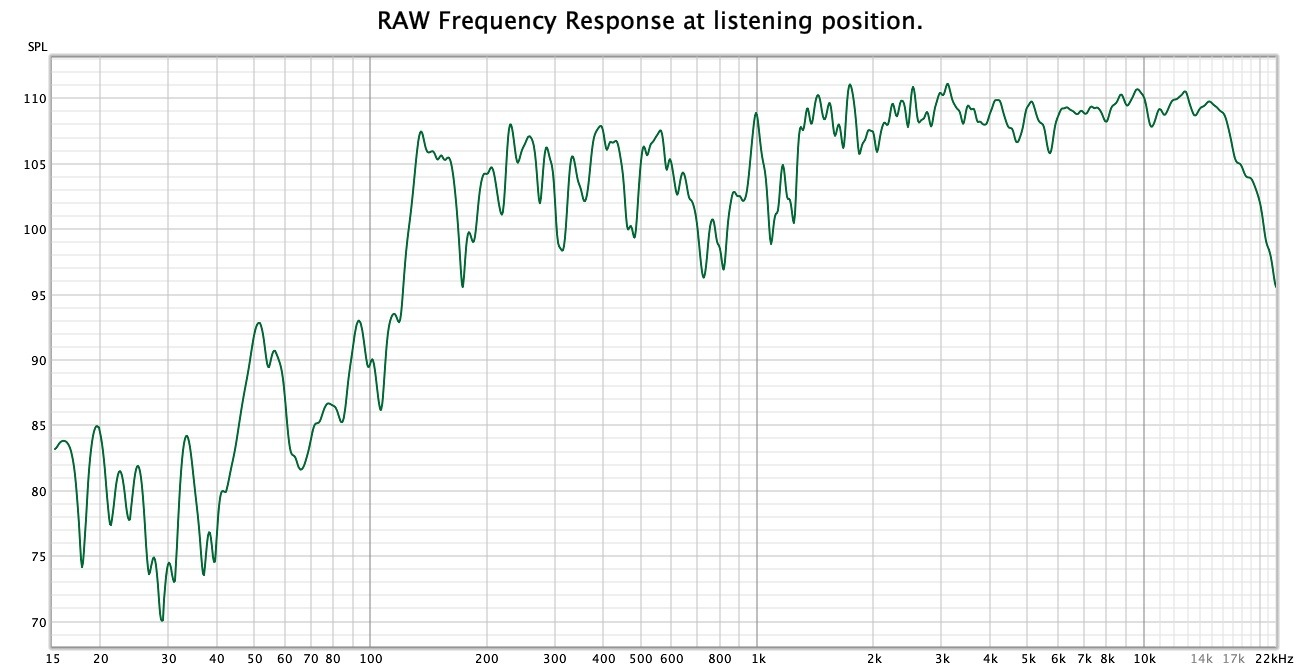

This is the only measurement I was able to make at the listening position (smoothing 1/24dB), without subwoofer.
Some notes.
Thanks!
Manuele
This would theoretically also allow each enclosure to be rotated freely, in order to minimize comb filtering by exploiting the horizontal response of the speakers.
Some notes.
- I need to repeat the measurements to understand what's happening below 1k, while below 300 Hz it's room dominated, the band between 300-1,000 Hz need to be investigate with outdoor measurements of the speaker itself.
- I would not have expected such behavior at high frequencies. Maybe the minimal baffle size helps to amplify only the high frequencies so as to counteract the comb filtering.

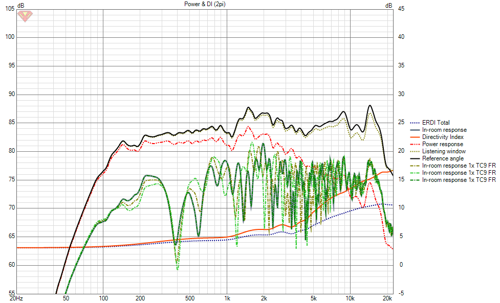

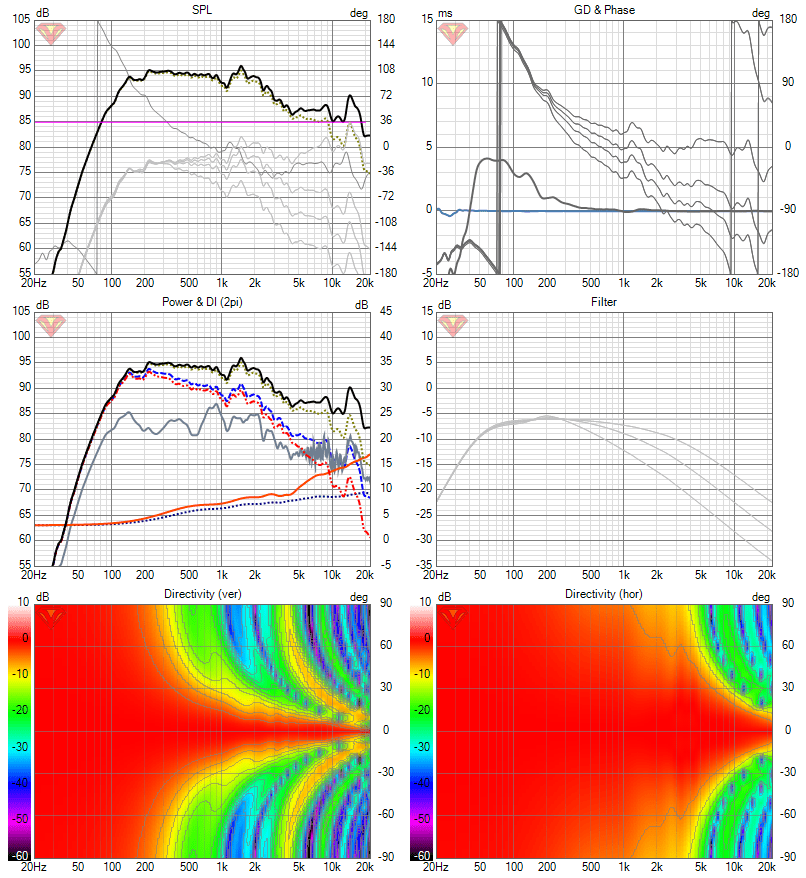

But to quickly compare the above to what Vituixcad thinks:
I see a lot of similarities here. Your baffle shape is going to change the top end a bit, no doubt. But look at the step up
in frequency at ~1.5 KHz, I think it's quite usable. See the rar file attached. Adjust the positions of the drivers and room to the right
sizes and let's check it out. You may need to point to the TC9 driver files again, as I'm not sure my folder still has the same name.
P.S. the driver at zero height is the center driver with a 0 Y-measurement. Microphone is at 0, floor at -1000. Adjust the floor and ceiling
to real positions but keep the mic at zero.

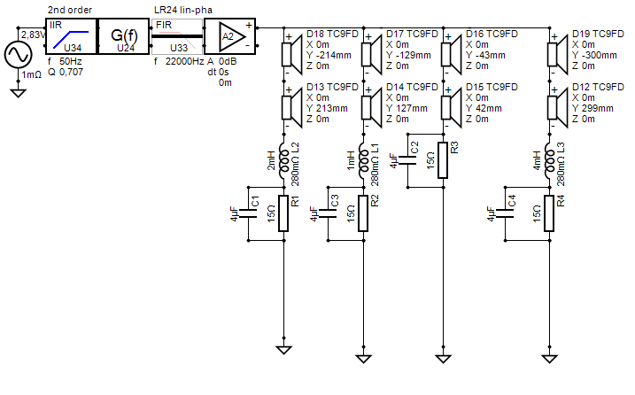

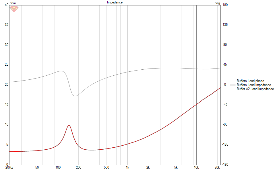

I played a bit with your Vituixcad file and I've noticed that there are two resistors for the three upper and lower speakers. Are those related to the power shading necessary to improve the vertical response? Changing those resistance values have not improved the vertical response in my simulation.
I also tried to add some frequency shading but the situation doesn't improve much...
Is there a way with some frequency and/or frequency shading combination that can improve the vertical response?
Thanks,
Manuele

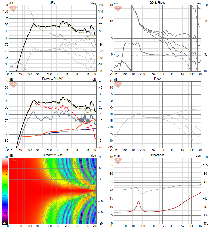

It's supposed to look like this:
And that's what I still see when I download it...

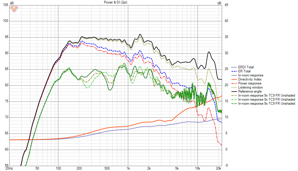

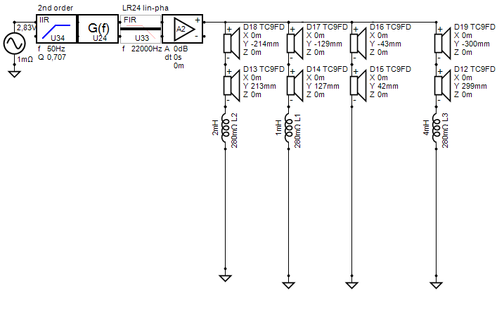

However, I did play briefly with some filtering, more elaborate than using a resistor by itself, but only managed to widen vertical output up to 5 KHz,
unless using a single driver as tweeter up top, which destroys the pattern control completely. So I wasn't successful in what I wanted to try and achieve.
I didn't try delay and shading to mimic a CBT, I don't like using shading that way. I'd say we need as much support for the bottom end as possible.
So what I tried was frequency shading, but it stays too narrow above 5 KHz no matter what I tried.

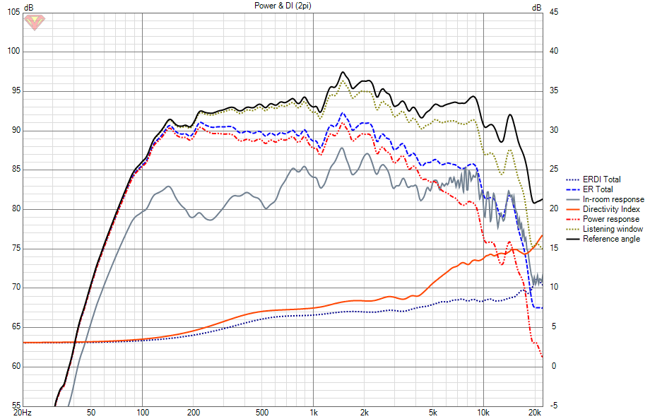

If you look at the unfiltered result:
you see the red line moving up from about 4 KHz, that's the directivity index. I'd want it to continue smoothly up, not with a jump like that.

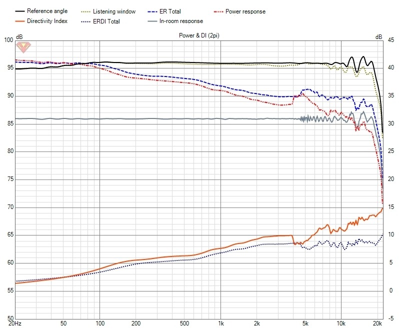

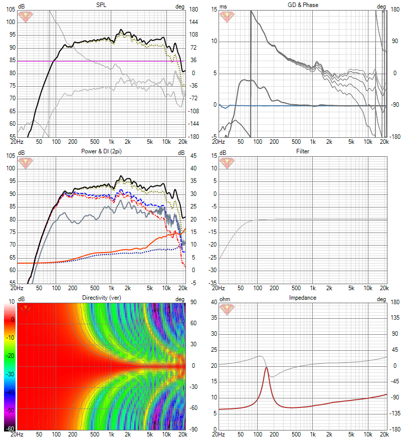

See my own 25 driver array:
While it does jump a bit, it's never more than 1 dB and continues to rise rather smoothly. That jump has to do with
lobing due to the distance between sources.

8 drivers, lifted up so the center two are at listening height. 10 degree beam up to 10 KHz, needs a bit of EQ.
Your measurements showed more of a rising frequency response than was simmed, so this should not need too much lift up top.
Only a few simple filters needed... tweak away!
At listening height and 100 mm above and below it (green traces). Not too bad at all. At 5m listening distance, floor and ceiling set at 6dB absorption.
No side wall reflections!
Compare to a single driver under the same circumstances:
(had to adjust it to the same 5m listening distance)
Which one will sound more clear?

These results look very promising! In this case I could save 2 boxes which can be used as rear speakers for my home theater...
I will run other simulations by changing a few things but still using 9 elements because, at this moment, my amplifier cannot drive such a low impedance speaker and I would like to use the TC9s I have available.
