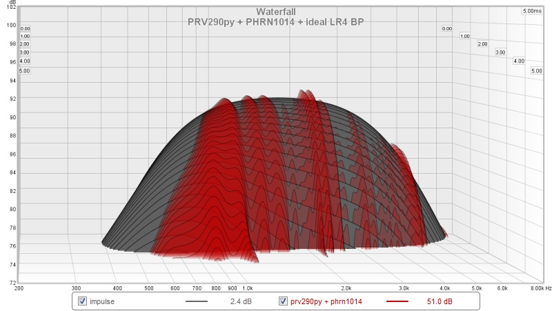

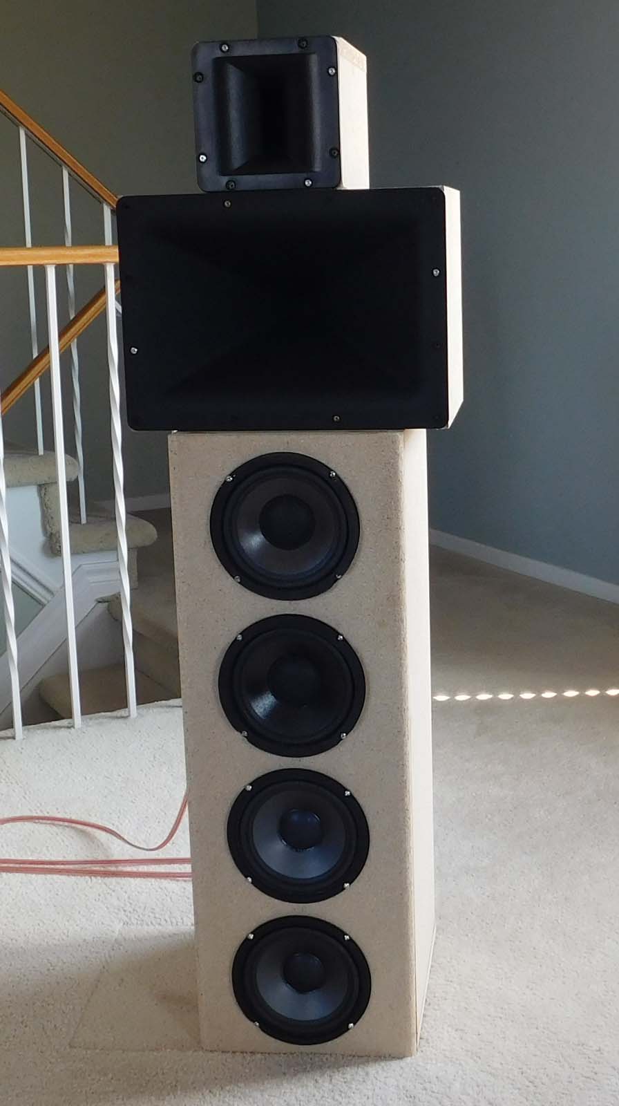

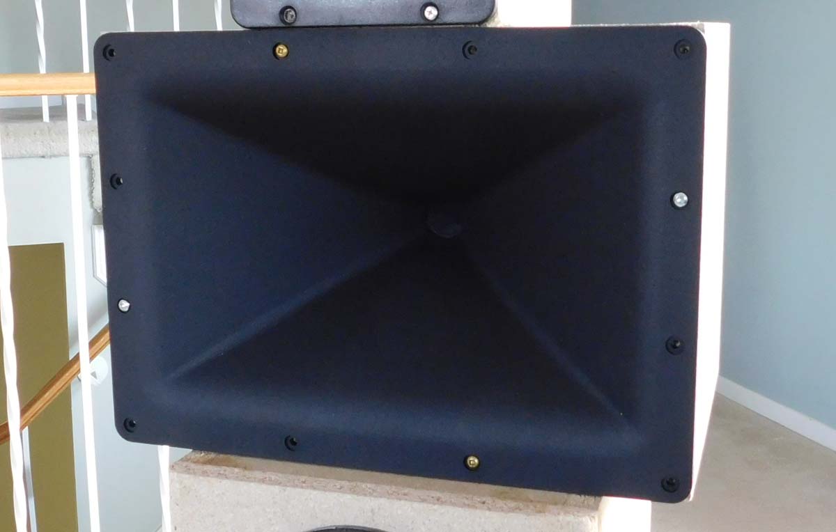

I was wondering if another horn would allow a better fit for my MF BP.

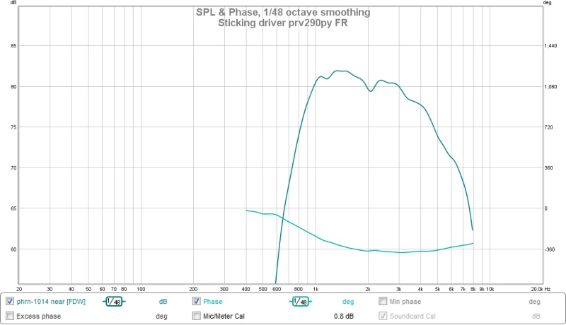

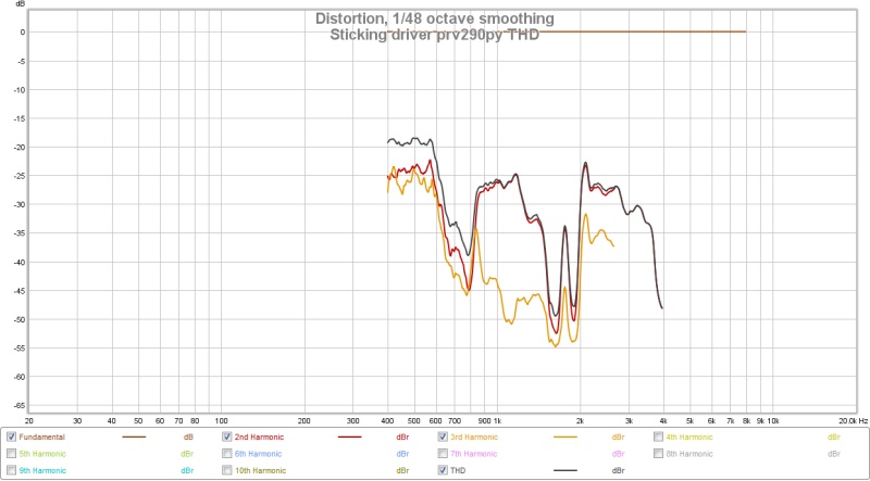

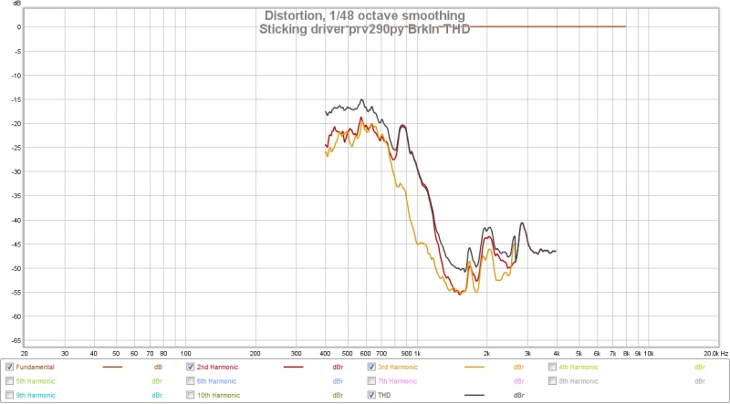

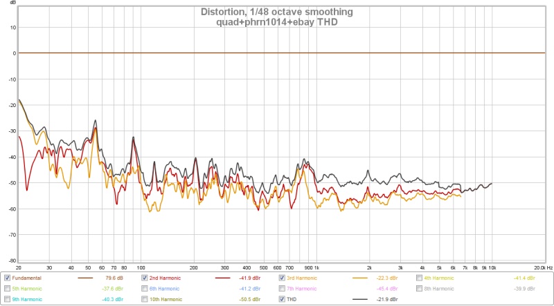

I hooked up another PRV290py to a PHRN1014. The first sweep sounded very wrong with abnormal squelching and chirping. I have had this with other drivers that were "sticking". I don't know how common this is.
The initial FR and THD are shown below. The the 3rd pic is after 5 min of about 1 watt of white noise through the LR4 BP to wear in the driver. It still needs more "break in" but the trend is good and this should eventually be -50dBr like the other driver. Not sure if this is from surface roughness or dust.

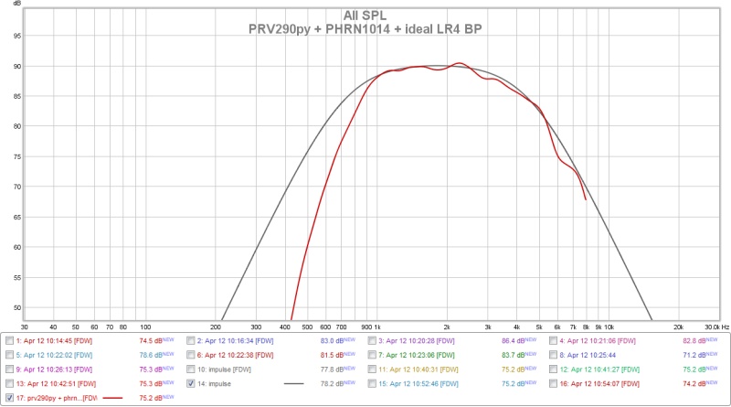

.. another horn for midrange

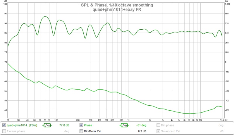

A few measurements after changing the midrange horn to a PHRN1014. I've seen these horns used in 2way EconoWave designs but probably crossed higher than I do. They are suppose to load down to 500Hz. I still have to measure the polars.
The horns where shuffled to time align them and then system EQ'd to get it mostly flat. After running it for another 5 hrs on music, the new driver THD is close to where it should be. The THD is still 5dB higher @850Hz (small bump) but the rest seems to indicate the driver is working properly now. It sounds OK now, even on the sweeps.
It's clear the driver would need several dB more EQ to follow the LR4 low side. This is about the same PRV290py driver limit as seen on the SH402 horn. I actually do EQ at the system level so the woofer picks up the shortfall and it effectively crosses at a slightly higher freq.
Simply just too low xo. I would raise my hands and cross higher, and get nicer slope and lower distortion. But it is up to you to choose between better dispersion vs. lower distortion.
Eventually, that may be the case. If I keep using this compression driver (PRV290py) it would be certainly be happier at XO=900Hz and the woofers would have no problem either. I'm still trying to decide on the midrange dome/cone/horn and for now I can EQ everything flat and keep on listening.

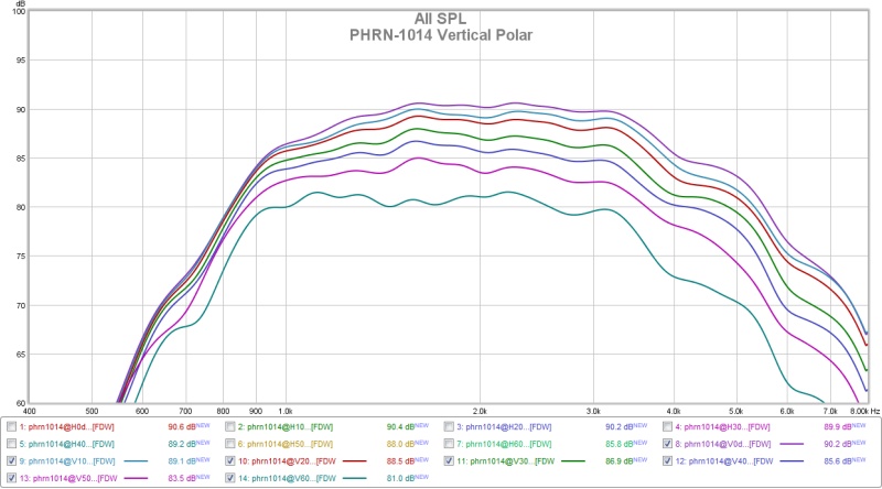

PHRN1014 midrange polars

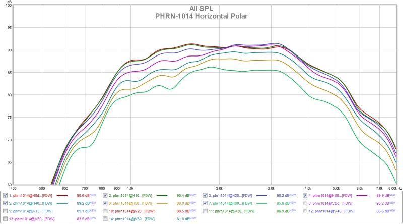

I finally had a chance to measure the polars of these horns. Its driven by a PRV290py with LR4 BP. The system has been EQ'd to make it flattish on axis.
The horn is advertised as "exponential" but it certainly does not look it from the polars. It's suppose to load to 600Hz except I'm limited by the driver. The throat transition, flat walls and graphs remind me of OSWG. It looks fairly constant in the midrange where I'd use it. It sounds good as well.

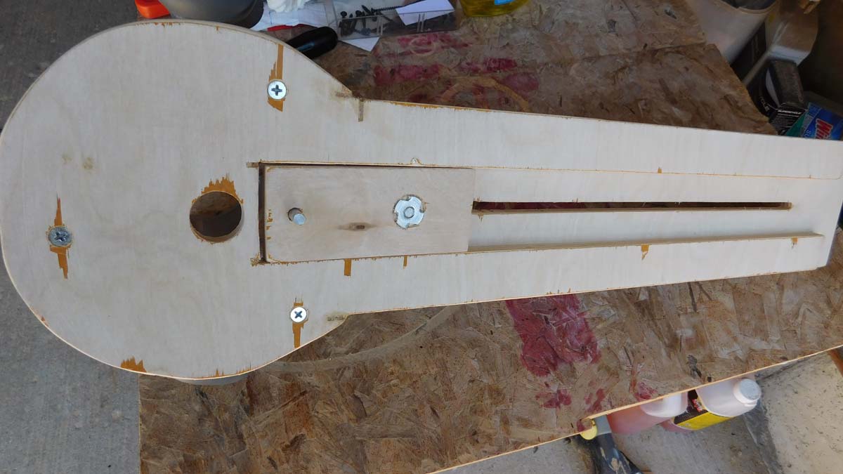

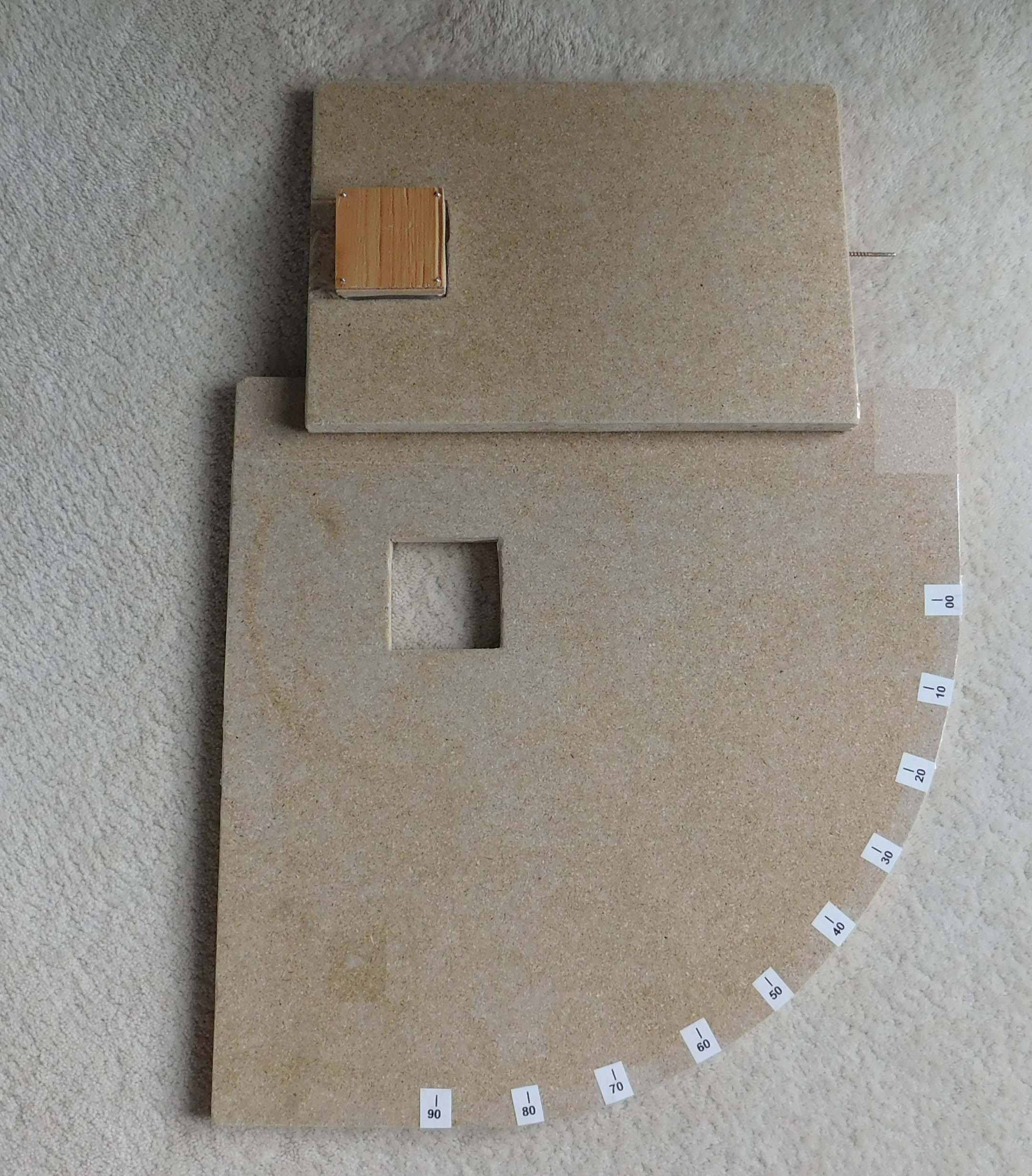

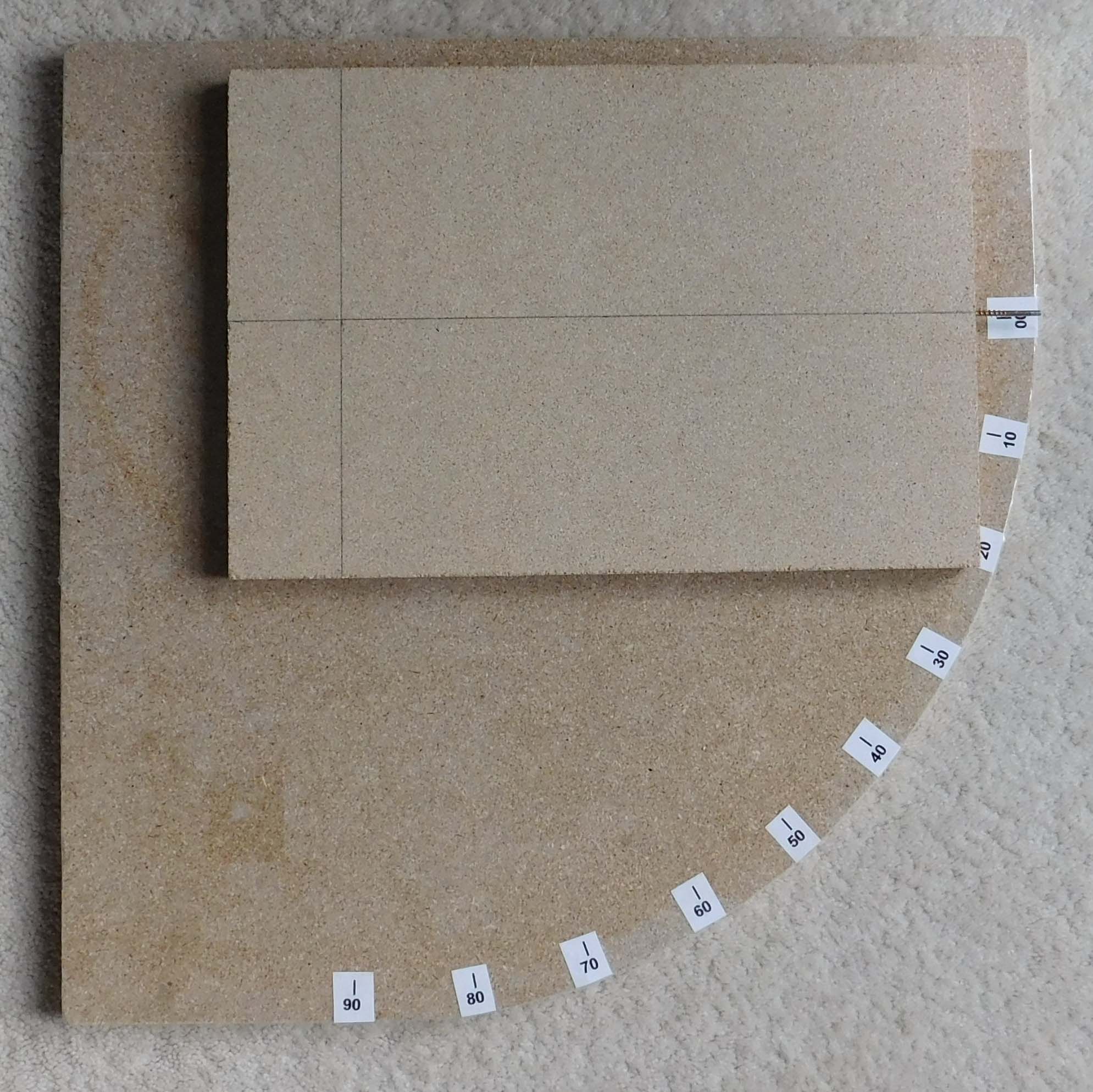

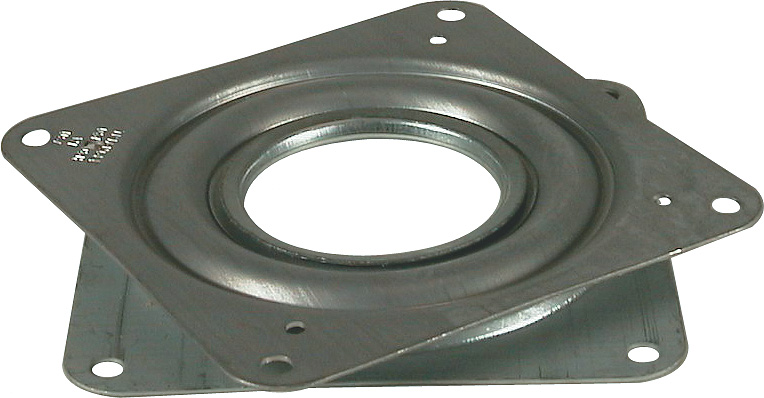

Hardware stores are open and I had a chance to build a simple fixture for horizontal polar measurements. Very easy to make using a turntable bearing fitted to a block that rests in the stationary base.
The speaker pivots about the baffle centerline. I used an adhesive plastic laminate to provide 2 smooth contact surfaces. I might change this to rollers between the surfaces if the remaining friction gets annoying.

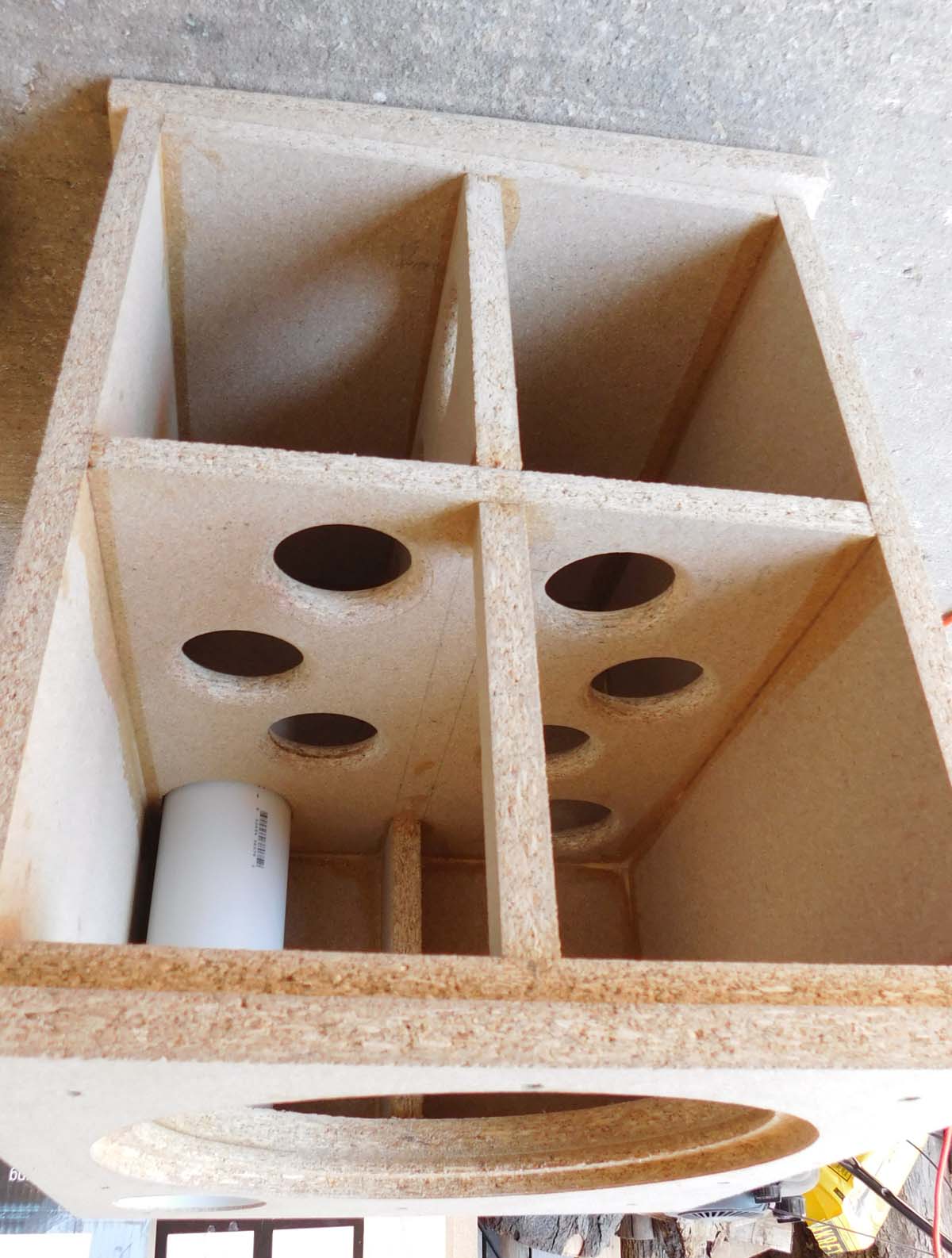

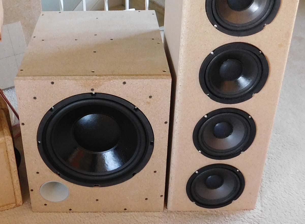

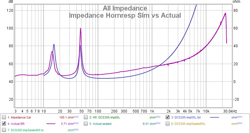

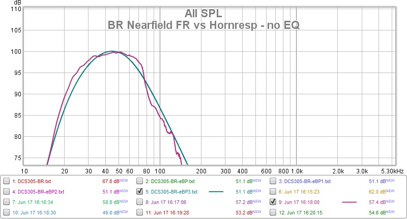

I also refactored my subwoofer to compare it to the BP6 using the same DCS305 driver.
The box volume (55L) lets me try it as either a BR or sealed (Q=0.66). The port pipe exits the front to make room placement easier (only one side radiates).
The sim uses the published T/S and the simple inductance model. The measurements are nearfield.

That horn is definitely a constant directivity device. A copy of the QSC horn that became popular with the diy crowd about a decade ago. One of the best measuring waveguides around if you don't count diagonals.
Not really good below 1khz as you have noticed. Modern 1" drivers aren't really designed to be used that low. Might have decent luck with a BMS 5530.
A 1.4" exit driver would be much more at home below 1khz in a home setting. Something like this would match up nicely.
