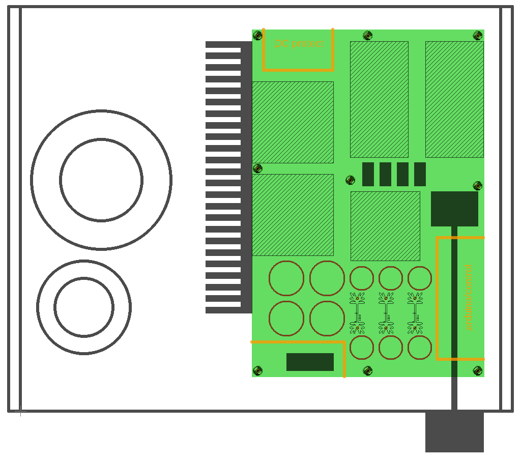

Let's imagine a 200*300mm pcb. At a first sight, we could have the following onboard:
- the main power supply,
- some auxiliary supplies (+/-15v, 5v),
- source selection,
- volume control, with a remote control option,
- an Arduino as optional control center,
- DC offset protection and muting.
And still have place for two removable amplifier modules (70*70mm), two input modules (50*100mm) and one preamp/buffer module (60*60mm). The input modules could be bal to se converters, DACs, phono preamps or even a raspberry pi.
Add two transformers, a big heatsink and some connectors and this would easily fit into a 350mm deep Slimline 2u hifi2000 case.
I confess that a big part of the attraction of this project is a personal itch to learn to use Kicad. But wouldn't this be worth trying ?
Indeed. Such a project would require a lot of attention to practical details.
Here's a rough draft of what it could look like. Not a high power amp, something with rails at about +/-30V, lm3886, symasym, p3a or the like.
A not so trivial question would be what to pick as connectors for the power connections to the amp modules. Common headers strip are at best rated for 2A per pin. That's a lot of pins to get something beefy enough.
Samtec has some nice strong connectors. The pss-fws serie is rated for 11A per pin, the hpf-hpm for 13A. Not cheap though.

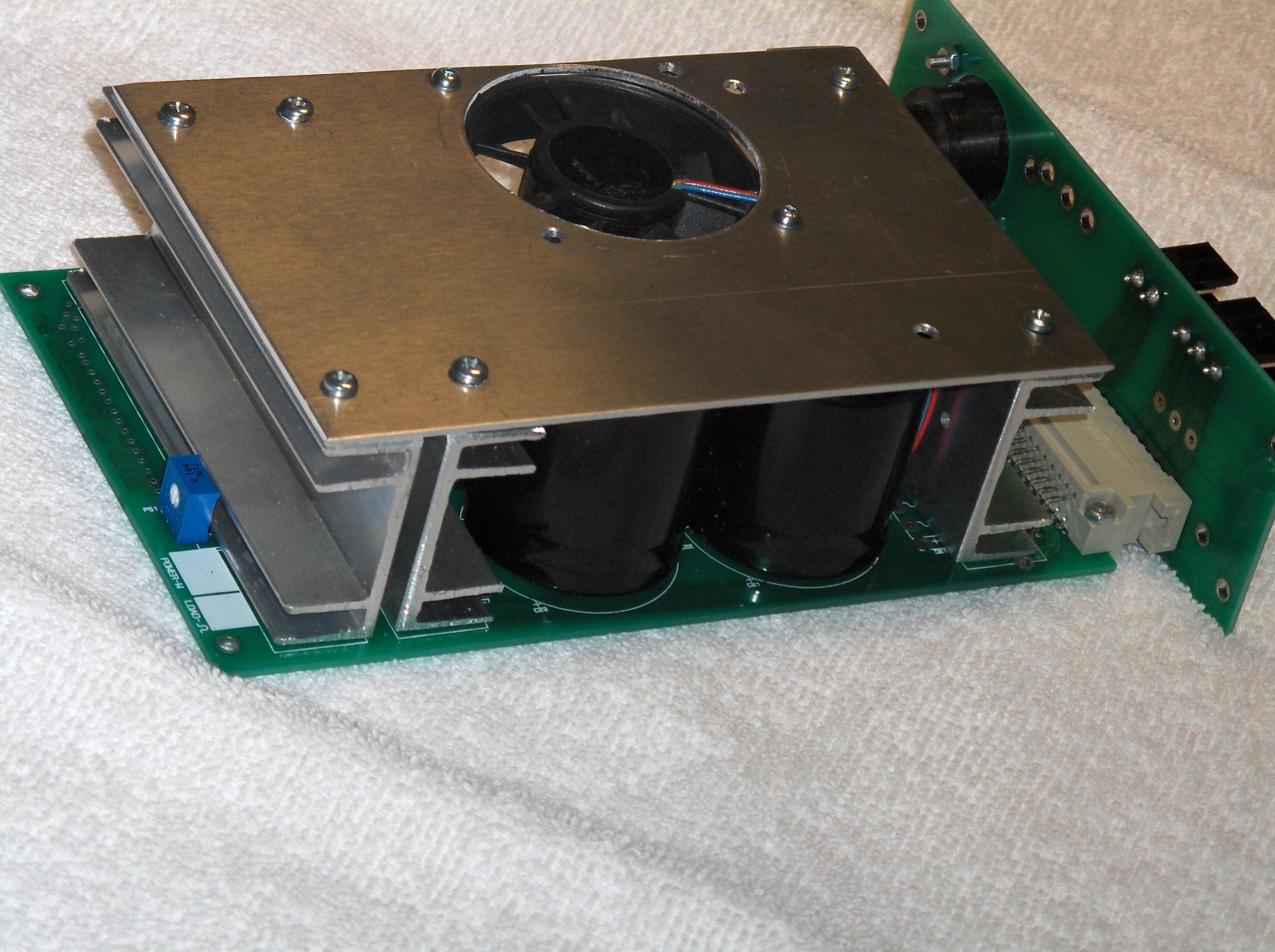

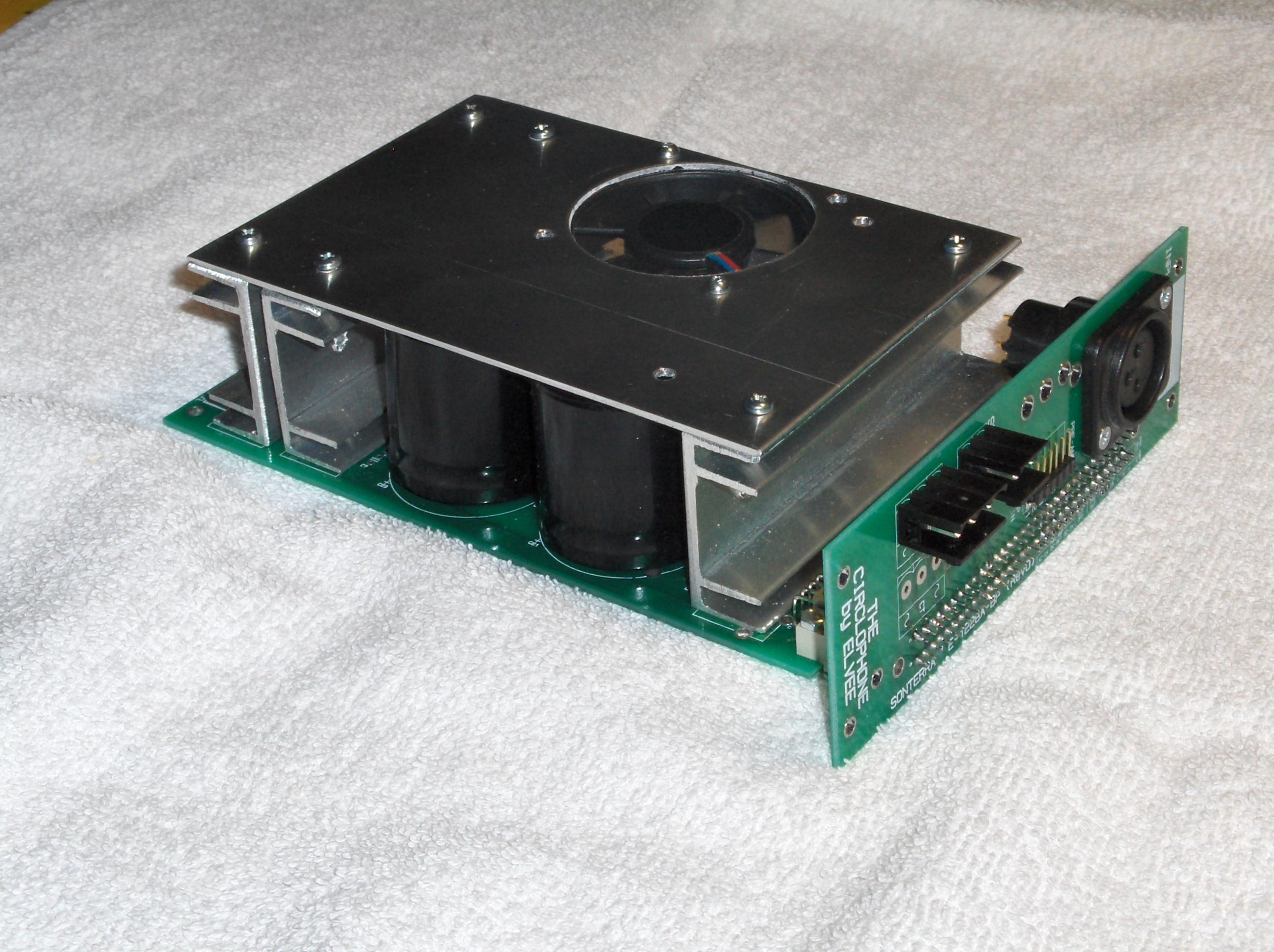

I did a design of Elvee's Circlophone.
I designed the board around the DIN standard 100x160 mm dimensions and a backplane to fit the standardized 3U high 19" rack unit (IEC 297 standard).
You could easily fit 8x50Wat amplifiers with the power supply into this 19" chassis.
The nice thing is you can get proto-boards the right size with fitting pads for the back-plane connector.
Picture attached.E

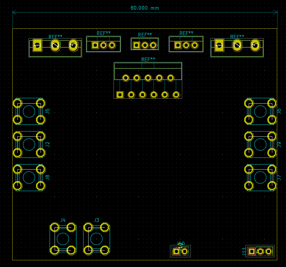

I started fooling around in Kicad. Here's a possible implementation of the amp module. It's 80*70mm. Transistors/lm3886 footprints are there to give an idea of the available space. Quite a few simple designs would fit.
Power would come either from left or right connectors (or both) depending on layout. Simple pin headers would provide input and aux power if needed. A concern with the screw terminals is insulation. Some solution would have to be found to prevent accccidental shorts.
