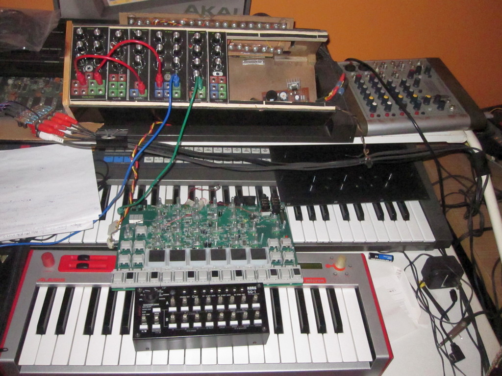

I may have uploaded the picture below elsewhere but as it looks right now:
5 VCOs (Yusynth + Thomas Henry XR2206)
3 VCFs (MFOS 24dB, Yusynth diode ladder, Polivoks)
2 (3) VCAs (Thomas Henry and CGS tube VCA)
2 (3) ADSRs (trouble getting the one I have working OK - Yusynth)
3 LFOs (MFOS dual LFO, CGS Psych-LFO, Digisound-80 4xLFO)
1 Noise + 1 Noise & S/H (CGS digital noise, Yusynth)
1 Echo/Reverb (Scott Barnardi PT2399)
1 Ring Modulator (MFOS)
1 Kbd Controller (MFOS)
1 Quantizer (Barton)
1 Arpeggiator (Barton)
1 Analog Shift Register (CGS)
1 Infinite Melody (like the turing machine) (CGS)
1 16 step sequencer (Thomas Henry)
1 Joystick (mee own)
1 USB-MIDI to VC + gate (Mutable Instruments)
1 Clock module for stuff that runs on clocks (mee own)

At the top: DIY Analogue Modular, with custom case, Low-Noise Linear Reg PSU and custom Power Distribution. Space for more and this is a Eurorack compatible format for which a small power adapter must be made to incorporate commercial ones (just wires).
On its bottom left, what you can see is a custom interface to a Korg DW-8000 it is resting upon.
Below these is a Roland JX-8P restored to its former glory on which is an Akai Tom Cat Analogue Drum Machine with custom mods (ongoing).
Below that is the Korg SQ-1, a nifty affordable CV and MIDI Sequencer. It can also double up as a MIDI-to-CV converter.
Bottom: restored Alesis Micron.
Not shown: Roland JX-3P, restored and already heavily modified for better sound and added functionality, Korg Polysix: restored once, modified, now needs some more work. Got tired working on this - great sound though, Soundcraft Delta 8 Mixer & PSU: modified, Lexicon LXP-15: restored, mods planned (PSU + custom analogue controls for an add-on circuit).

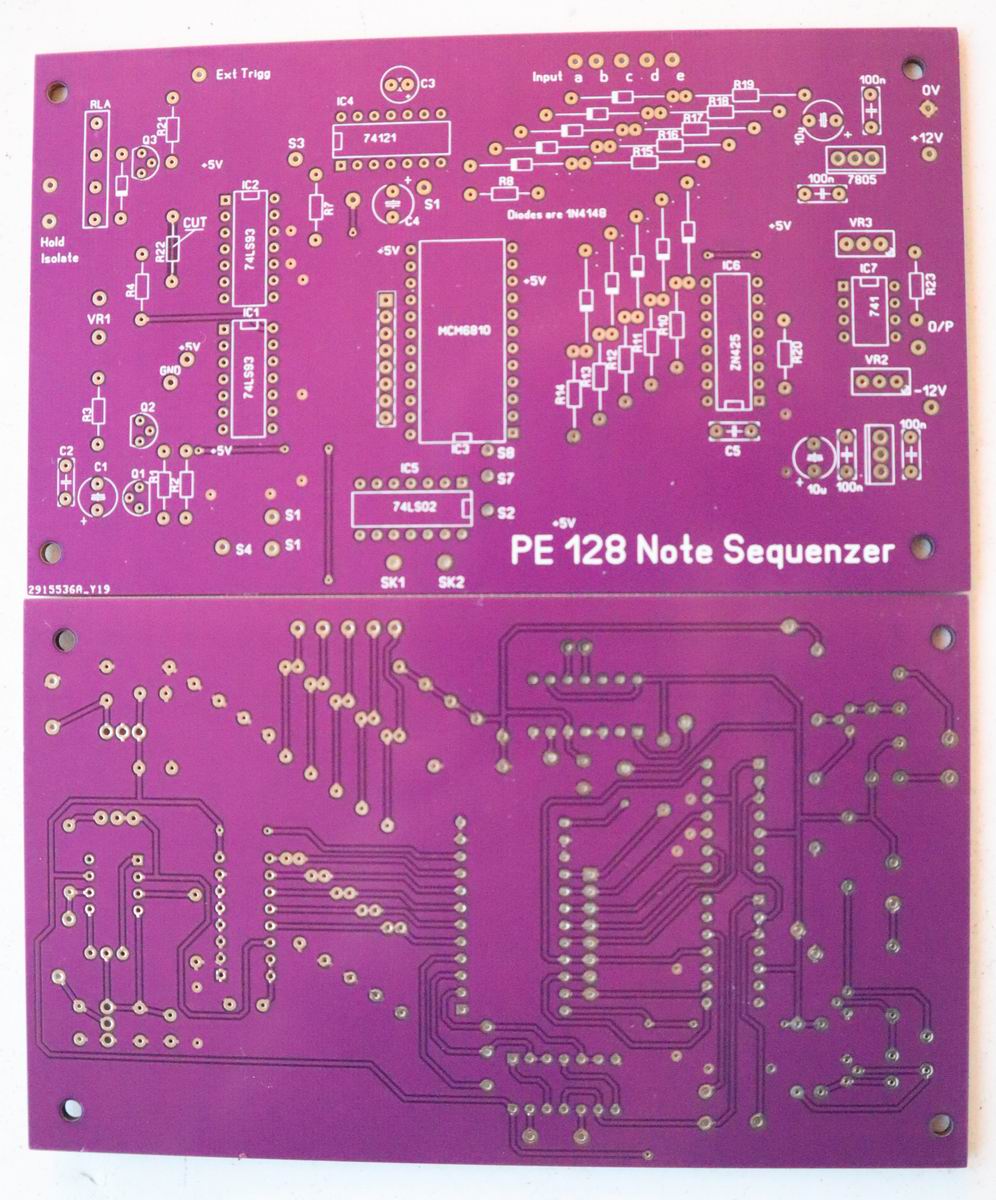

Btw, I got the PCBs for the Practical Electronics 128 note sequencer. It was messed up but the switching arrangement and only made for 2 octaves. The sequences are stored in a 128x8 RAM, but only 5 bits are used for CV, the other are used for trigg and end signals.

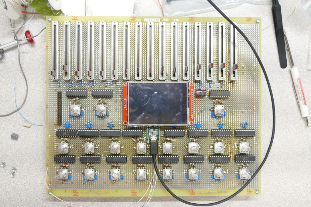

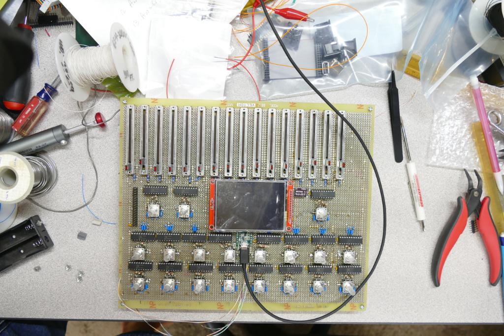

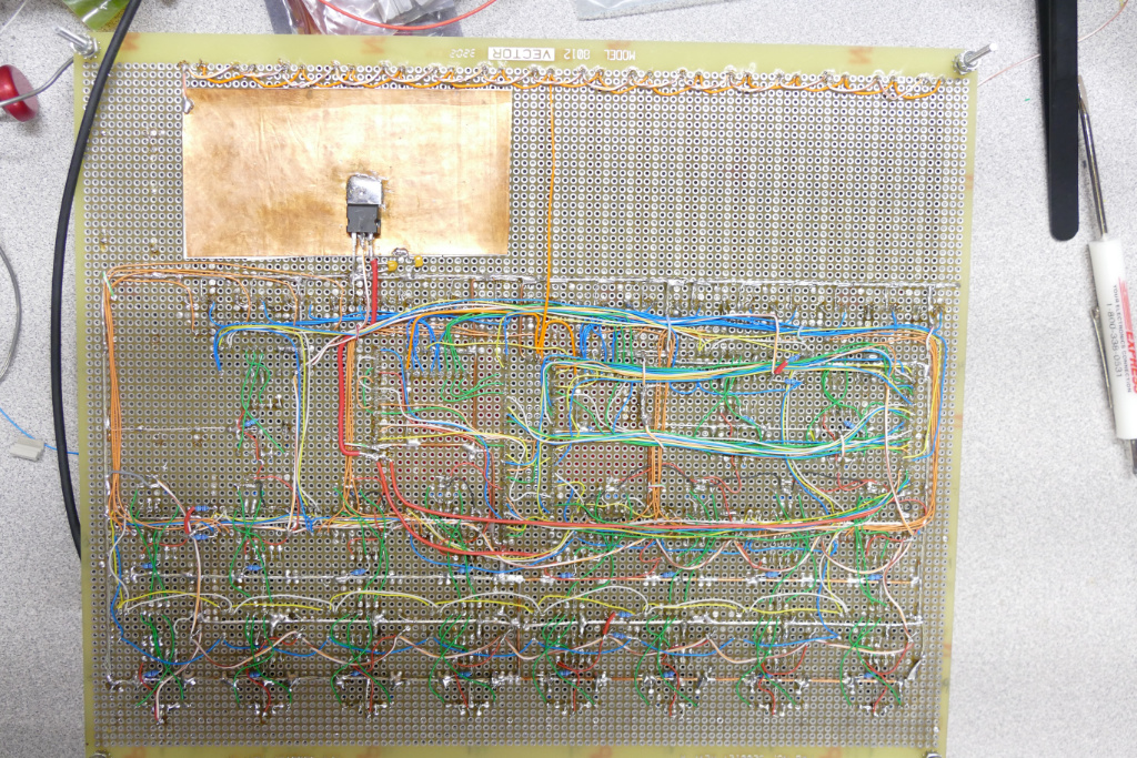

I am quietly working on a stand alone "music box" with multi level sequencing capability as well as several sound generation circuits, both analog and digital. It will be totally stand alone, portable, and battery powered for use far away from the DAW. The pictures show the "controller" breadboard. It is working well enough for the code writing part of the build, not my favorite part. The sound generation breadboard will be the same size and incorporate circuitry from my existing DIY synths.
The controller features 19 RGB LED illuminated rotary encoders, a touch screen, and 16 slide pots.
