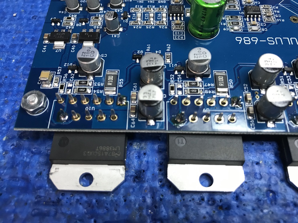

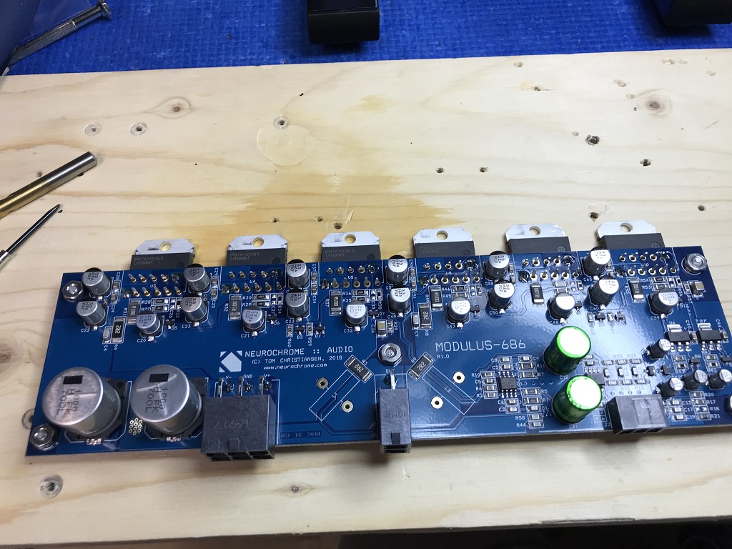

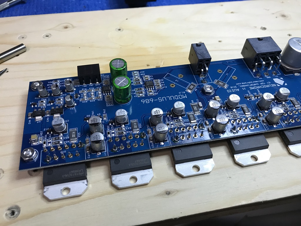

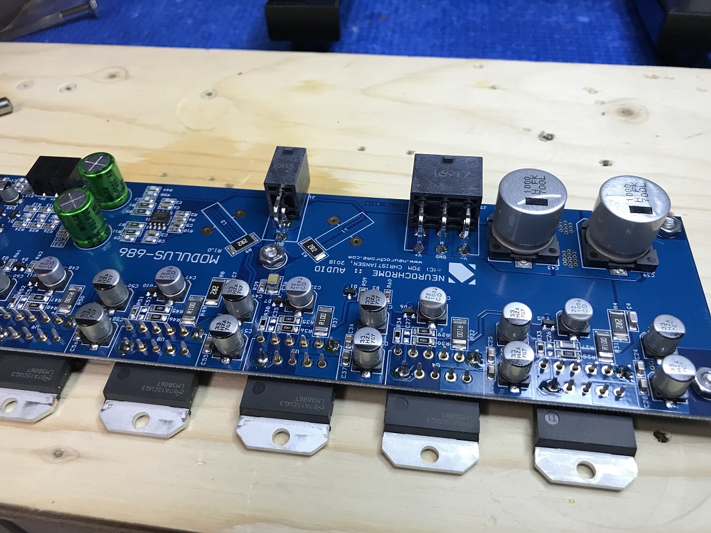

I've decided to do a non-standard build of the Modulus-686 that will be powering my Sagwee LT V3 speakers. For this, I've decided to install the LM-3886 chips in a 90 degrees bend to provide more room in my chassis. I've also decided to use 0.5mm alumina/ceramic pads for the LM-3886 as they provide amazing heat dissipation.
Here's some pics of the modules.

As per poseidonsvoice, it is for making more room inside the chassis. I'm trying dual SMPS in the build and if for some odd reasons I don't like it with SMPS, I'll have plenty of room for big old dual toroids and PSUs.

I do like this idea a lot, you really going to save a lot of space in the case .
Where did you order the ceramic pads from?
Thanks! Yes for saving space and really not hard to do.

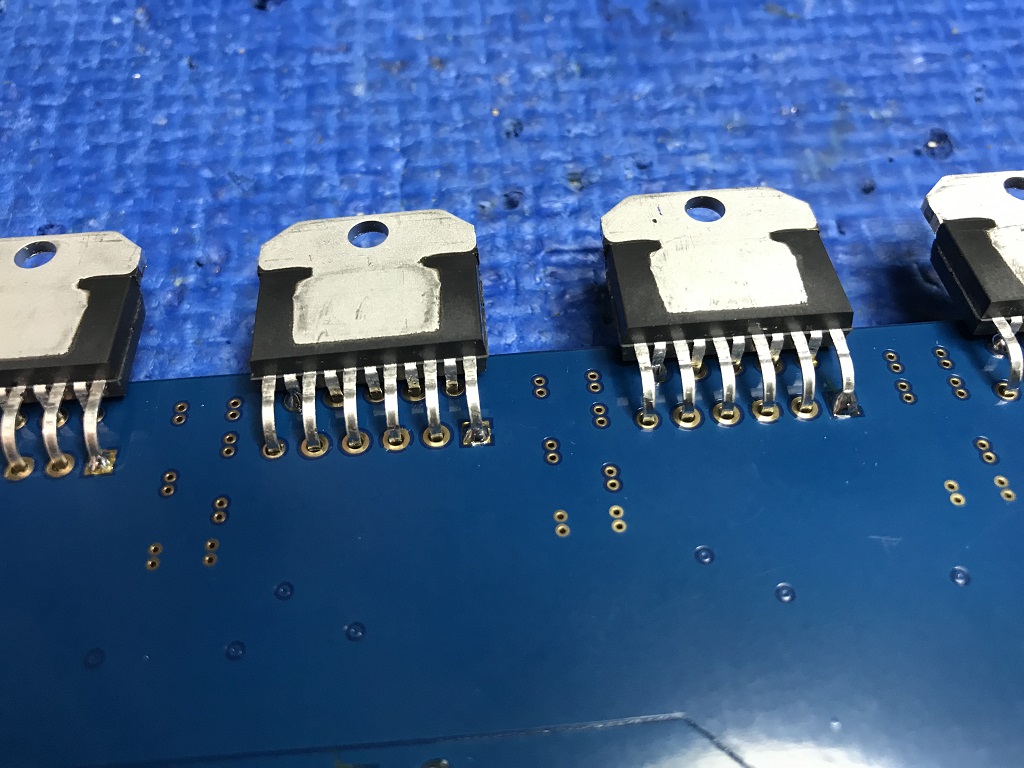

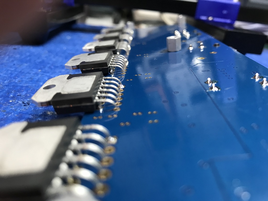

Hey would you mind sharing close ups on the LM chips from top, side and bottom? I’d love to see how the legs are bent. Really interested in this approach, but I thought it was not possible (by 3mm or so). Thank you so muchHello everyone!
Here's some pics you requested. Hope they're useful for those who wants to install it this way. I used a drill bit parallel to the chip to do the round bend of the second row.

Thank you sooooo much for the pics, Do! Really helpful.Here's some pics you requested. Hope they're useful for those who wants to install it this way. I used a drill bit parallel to the chip to do the round bend of the second row.
That's a really good business (and life) resolution indeed, and it really shows in your daily messages as well. One can easily tell the passion you put into it by the way you interact with your clients (or leads), all of which gives a great peace of mind to the casual, untrained builder.I'd rather under-promise and over-deliver than the opposite and need vendors who can support me in this. That's all.
That's a pretty neat trick. One could entertain the thought of doing the same for the first row of leads to get the bend a little further away from the IC package. There isn't a whole lot of lead length to work with, though.
