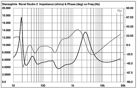

The impedance graph of those Philharmonics looks almost exactly the same as the graphs for the Revel floorstanders. Not surprising as the driver layout is similar too. Mod-686 power should be a good match, I'm getting really interested in trying a similar approach as your system.

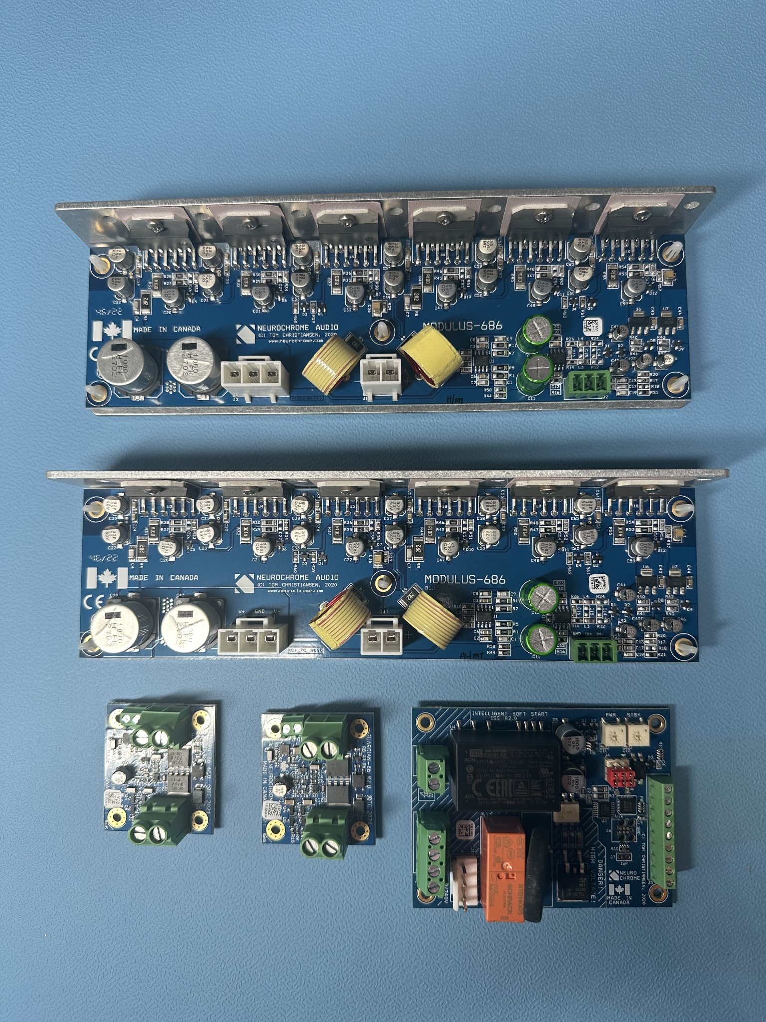

My main Mod-686 parts arrived last week, thanks Tom! Such a nice package to receive, it's like delayed Christmas.
This will be a stereo build for my living room. Tom set the Mod-686 boards to 20 dB gain for me. I'm drawing a design based on a Modushop Dissipante 5U 400mm for the chassis. Quite a beast, but still within reasonable cost and dimensions, looking for the best thermal performance I can buy off the shelf.
Interesting PSU discussion. I haven't decided yet, but I'm considering the Micro Audio COBRA-S2. It offers 1200 watt of "music power" but I don't know with which crest factor. It also has a good bunch of capacitance at the output built in, just like you'd do with a linear supply. All in all looks like a nice product and it's dual rail so a single one could do the trick.
I also need to build a dummy load rig. When I tested a Mod-86 at 50 watt on my 8 ohm 100 watt resistor I almost melted my desk. I'm gonna get 8x 4 ohm 200 watt resistors, and put them in a Makerbeam rig with some PC fans on it. I'll add a whole bunch of banana sockets so I can easily make different combinations with the resistors using banana cables.
All this will take a while, but I'm looking to test a stereo Mod-686 with a signal generator. Two channels at once to see what the PSU does, and the Mod-686 of course.

Nominal should be around 6 ohm, but parts of the graph are near or even below 4 ohm, including low frequencies. These speakers are known to be real power hungry if you want to drive them properly. It's hard to find accurate information though, and most of the discussion is about the big brother (Salon2) which is 4-way so would have extra crossover loss.
Most discussion I've found talks about people using even more power than the Mod-686 can deliver at 4 ohm. I'm hoping the Mod-686 will be enough. My room is not small, but not super large either, so I probably have some room gain. Calculations for listening at 80-90 dB say I can easily drive the speakers (sensitivity 87.7 dB SPL with 2.83 V @ 1m). But I'm afraid I'll lose dynamic range if I'm "short" on power. Hard to imagine but all the discussion about insane amps for Revel Ultima speakers has me worrying a bit. Official word on the speakers is "500 watt".
Worst case I could bi-amp with another stereo Mod-686.
