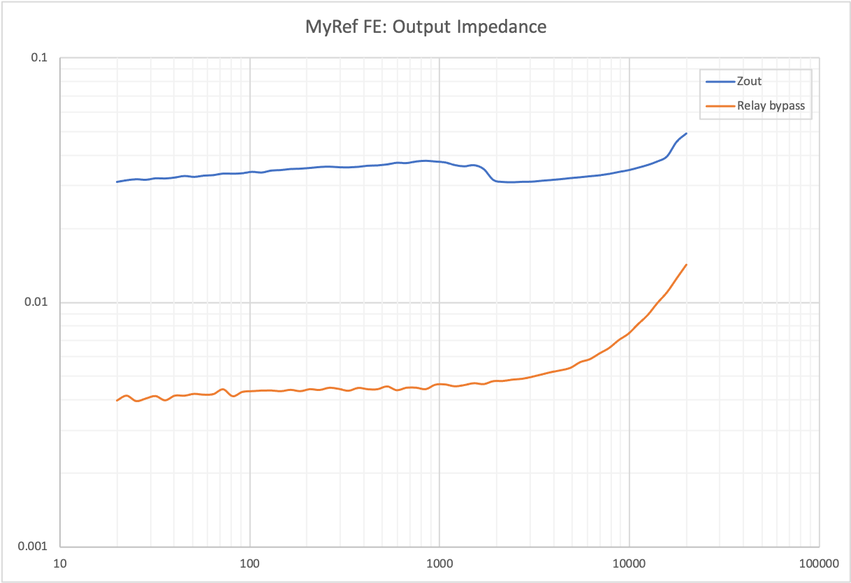

The wobble in the output impedance is caused by the output relay.
The blue trace in attached graph is the output impedance as measured at the output of the amplifier (i.e. after the speaker protection relay).
The orange trace is the same measurement performed with the connection to the audio analyzer made on the 'inside' of the relay (i.e. the ground connection on the relay as the speaker protection relay in the MyRef FE switches the ground connection to the speaker).

Tom...
I imagine You could already see this coming..
Looking at Your last test.. It jumps out that the output impedance curve of the FE amp had gone down almost an order of magnitude..
And in fact, it is now directly comparable with that of Mod86. Do I see well that they run almost precisely together? FE still a bit higher.
If yes, that brings a series of humble doubts.. Is it possible that not only the output impedance, but also the last bits in the distorsion spectra could have been affected by this mishap?
You have mentioned and I do agree that the output impedance curve is like a fingerprint: it is composed of output stage impedance and loop gain evolution..
For me the FE (new) impedance curve tells a story of a high, comparable loop gain at disposal. (to the Mod86)

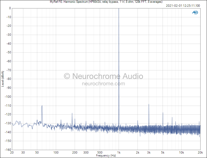

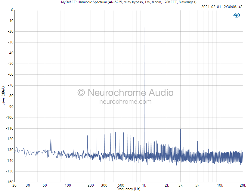

Sure. And the measurement of the Modulus-86 tells the same story. They're both composite amps with a large amount of loop gain. No surprises there.
The difference in THD+N between the MyRef FE powered by a lab supply and the MyRef FE powered by a transformer is due to the PCB layout and not the output relay. I've provided a suggestion for how to address this in my review. You can also read here: Taming the LM3886 Chip Amplifier: Grounding – Neurochrome
I have remeasured and attached the harmonic spectra of the MyRef FE providing 1 W into 8 Ω. I bypassed the speaker protection relay by attaching the BNC connector for the connection to the audio analyzer on the 'inside' of the relay.
Looks like you have some homework to do.

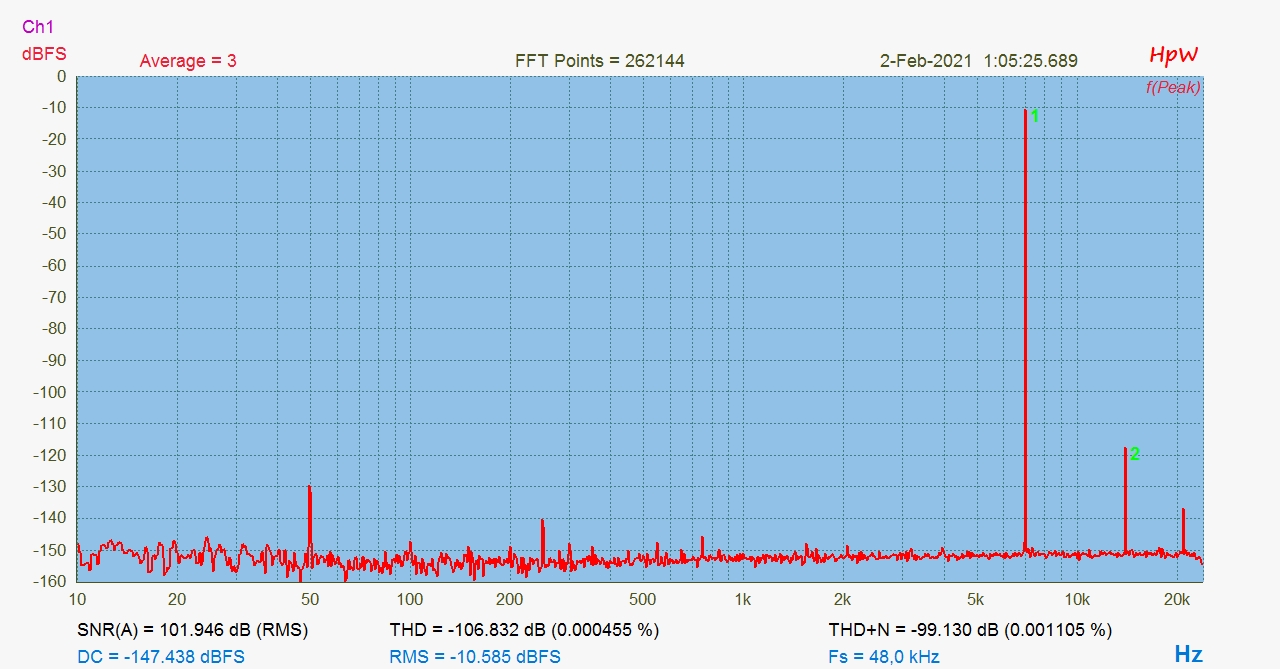

Tom

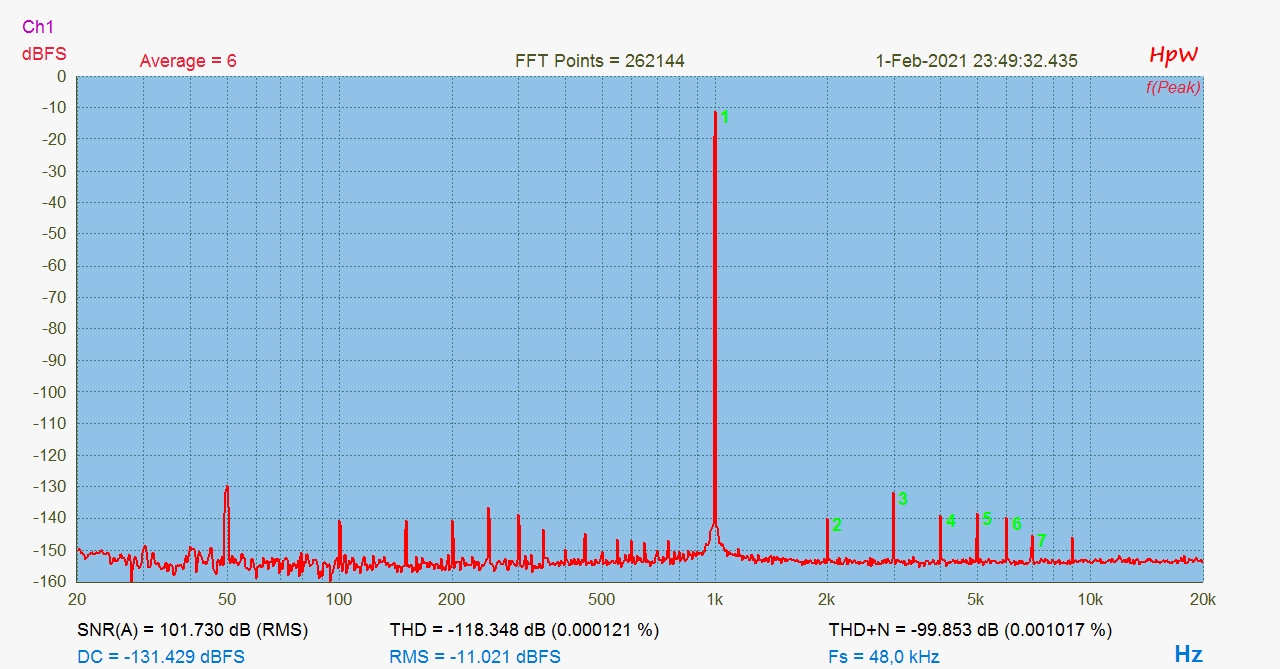

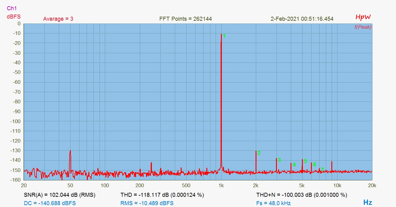

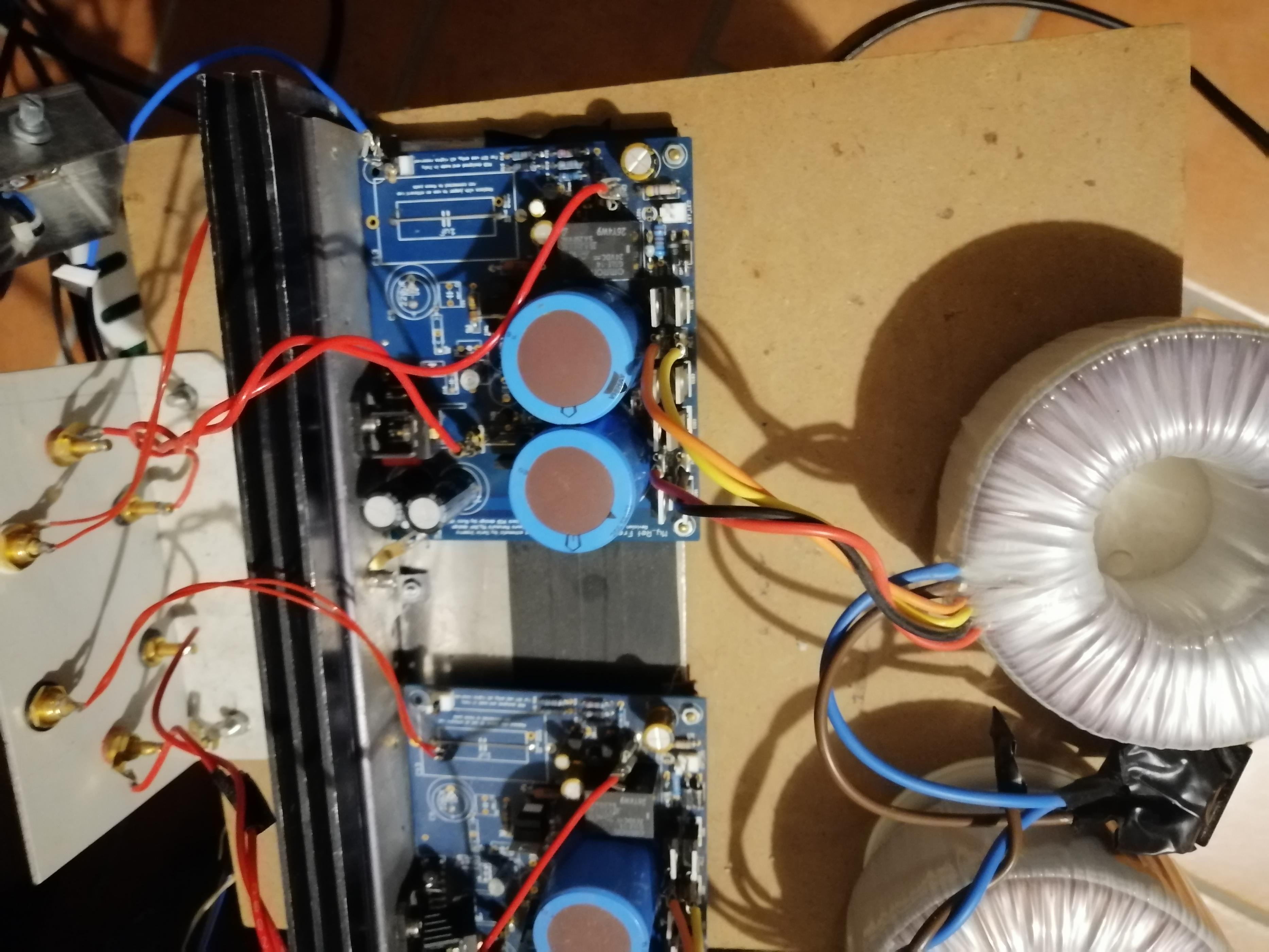

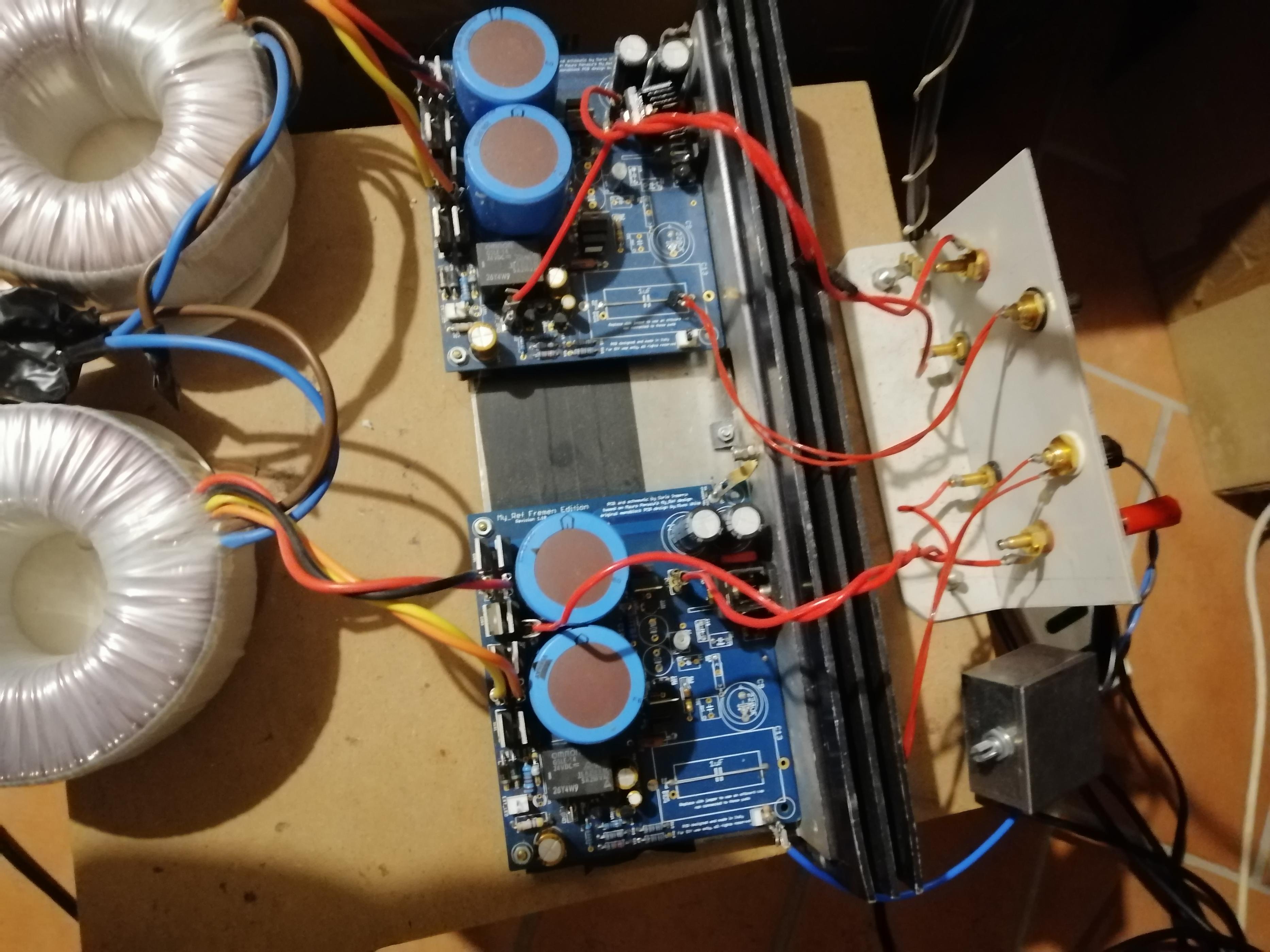

So. I did some homework.
After many time I have digged out and reassembled my faithful old EMU1616m. Because the old measurements I have been doing with this card. It's heavily modified, not at all performing like original. The feedback control gave 0,000065% at - 10dBFS signal.
But it's not this aspect what I wish to show. Look at the power supply harmonics. I don't see the effect what Tom has seen. If it had been a PS injection effect into ground, it should not be possible to 'clean up' with 'simple' tight signal cabling, ground loop minimization.. (what I had to do carefully, obviously. It's a single ended test, with ironed in ground loops..)
I have only done a test with my everyday, dual 300VA Talema trafo supplied MyrefFE, the amp & test leads is in the photo. OPA828, sorry..
Test signal is 5W (6,4Vrms on 7ohm load), 1KHz.
I am very open to discuss..!

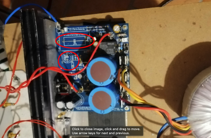

George: Your board is missing several components, including the input capacitor. I've circled some of the missing parts in the attached screen shot. Do you think that could be the root cause of the difference you measure? After all, the input capacitor is a known hum injection point in the MyRef FE (says Dario). What about the other components?
You also mentioned that you're using the OPA828. Is that the case for the measurements/boards you show? Could that make a difference?
On Dario's recommendation, I did try to short out the input cap, but that didn't change anything in my measurements. I did not take it out of the circuit like you have.

Tom,
The pickup by the caps: it could be, and could be both.. (I have observed not nice noise pickup with large body electrolytic bypass/ filter caps on more occasions..)
I will try to see.
