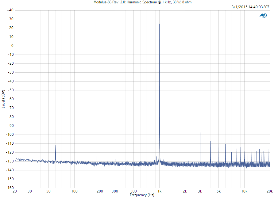

Here's the Modulus-86 Rev. 2.0 for comparison. Here's the FFT directly from the APx525 (click on the image for larger view):
The THD works out to 0.00012 % (38 W, 8 Ω).

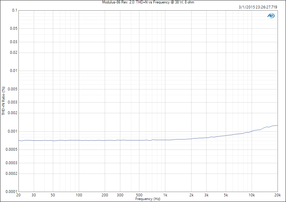

More importantly for sound quality (my subjective experience), the THD+N is nearly flat versus frequency. In my subjective experience, flat THD+N will result in an open and natural sound. The plot below shows the THD+N for 38 W, 8 Ω.

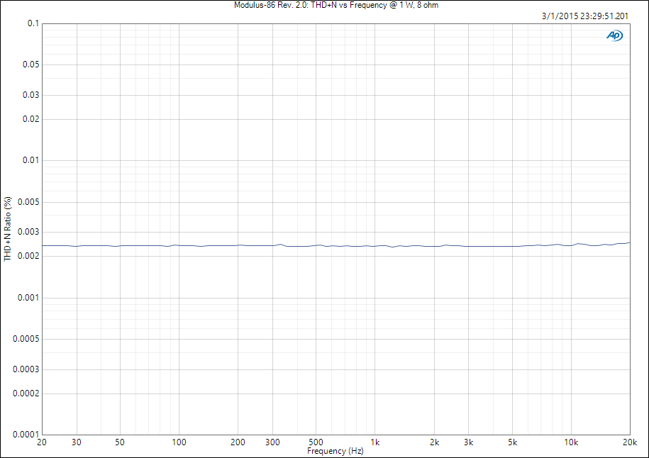

It gets even flatter at 1 W output power:

![Modulus-86 Rev. 2.0_ Harmonic Spectrum @ 1 kHz, 38 W, 8 ohm.png Modulus-86 Rev. 2.0_ Harmonic Spectrum @ 1 kHz, 38 W, 8 ohm.png](https://www.diyaudio.com/community/data/attachments/448/448917-5d1e0a98d4bb92041671870c1f96b90e.jpg)
![Modulus-86 Rev. 2.0_ THD+N vs Frequency @ 38 W, 8 ohm.png Modulus-86 Rev. 2.0_ THD+N vs Frequency @ 38 W, 8 ohm.png](https://www.diyaudio.com/community/data/attachments/448/448931-c97f2e3206951ec681def381c563a81c.jpg)
![Modulus-86 Rev. 2.0_ THD+N vs Frequency @ 1 W, 8 ohm.png Modulus-86 Rev. 2.0_ THD+N vs Frequency @ 1 W, 8 ohm.png](https://www.diyaudio.com/community/data/attachments/448/448962-88f52bad9555e40a53f80cdad37d8be7.jpg)

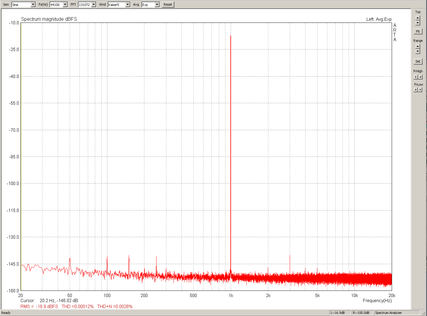

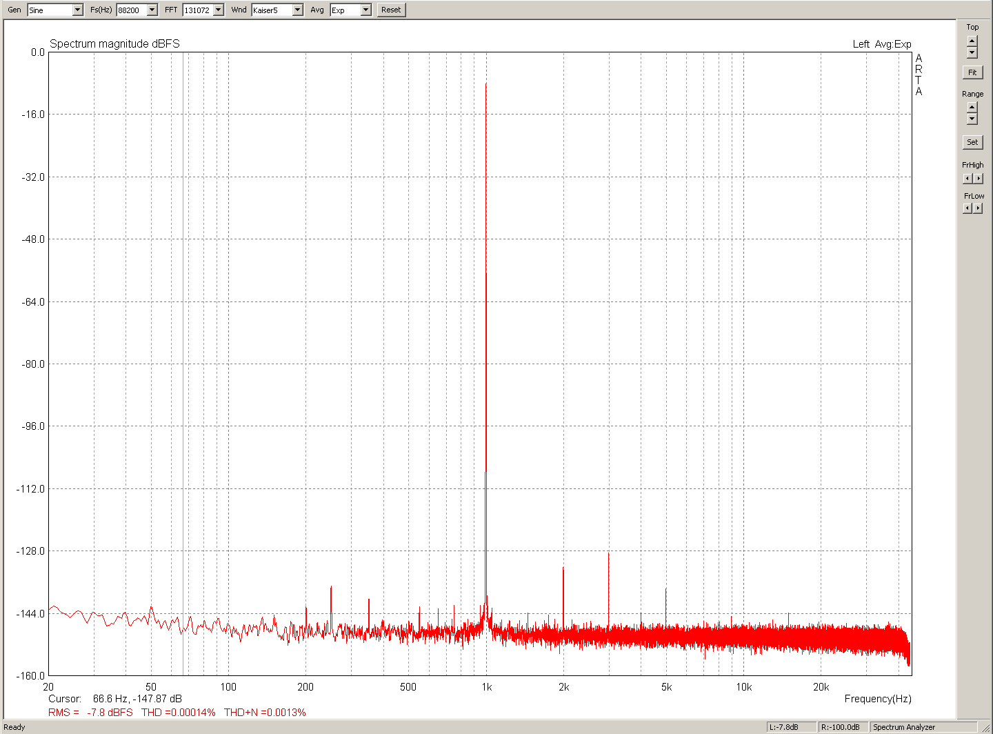

Just so as to jump in this stupid game of numbers..
I have shown only recently the measured distortion values of Mauro's MyEvolution amplifier. Which is an expandable design to "two barrels" much like the power 86, is equipped by a proper dc-servo, and exhibits very very good Measured. Low. Distortion. values, which I would like to report also here, just to make some counter-balance to Tom's 'data'.
As it is shown in the Arta spectra, distortion is
0.00012% at 1kHz/1W/7ohm,
0.00014% at 1kHz/14W/7ohm,
and
0.00022% at 1kHz/25W/7ohm
All these values are including the self-distortion of the measurement setup itself, so all of them are to be jugded like 'better than'.
Indeed I had to fight to keep the signal constantly in the sweet spot zone of the card itself, because the contribution of the amplifier is so low.
The original post with measurements is here:
http://www.diyaudio.com/forums/chip...on-build-thread-tutorial-216.html#post4407354
You can find more graphs there, which show the very notable behaviour also at high frequencies.
@Joseph: Can I just confirm the interpretation I should put on some of your words
"proper dc-servo": Are you implying someone has an improper one?
"Tom's 'data'" : The use of 'data' in quotes suggests you have a problem with his measurements?
"stupid game of numbers": as you have taken a lot of trouble in your measurements do I assume you enjoy the game?
I haven't managed to convert your scales to match in my head but those results look pretty good for a PC based measurement setup. What were you using as a source?
I should note that I don't believe anyone would be able to tell any of these 3 amps apart with only their ears. It is good that people are chasing perfect performance.

I underlined the dc-servo because it was earlier shown like an advantage to the Mod-86. The original Evo design also has it.
Tom's data is very respectable, result of a very nice and expensive setup. Does it have any importance with respect to my own listening experience in my setup at home? Does my measurements tell me which of the parallel tweaked and 'listened to' Evo modules would sound better? They do not sound at all similar, while measure very close. Yes, the sound changes with tweaks, things like that do happen?
I'm using a tweaked by me EMU1616m sound card, it's baseline results were shown at different places of the relative discussions. I think it does go reasonably close to an AP, without any pretending that it could reach it.
