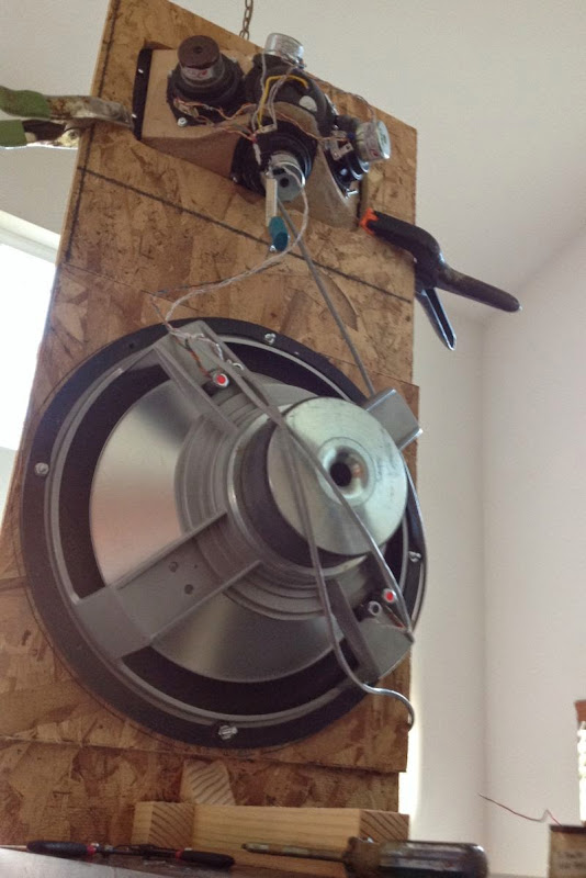

Here's some more measurements of a woofer with a coupling chamber in front of it.
This type of arrangement is handy if you're trying to cram the output of a 12" woofer through a 6" hole. For instance, if you have a 12" woofer in you're trunk, and you're hanging the woofer off of the rear deck and firing through the stock speaker hole.
In the world of horns we call this a "coupling chamber."
But you can use a coupling chamber with anything. A sealed box, a vented box, etc.
Basically the coupling chamber acts like an inductor, it rolls off the highs. The cool thing is that it's way WAY cheaper than an inductor, it reduces harmonic distortion, and it allows you to squeeze a lot of output through a small gap.
First off, here's a pic of what the speaker looked like before I added a coupling chamber. It's the speaker in the center, sporting a Diyma12, flanked by my Vandersteens and my Summas.
Here's the speaker with the coupling chamber in place. The coupling chamber crams the output of a cone that's about 11" in diameter through four holes that have a combined size of about 5". (It's actually four 2.5" holes, which is equivalent to ONE 5" hole.)
This is similar to what the prosound company "Nexo" uses in their loudspeaker arrays.
Here's the measured response. I did this in my living room, so there's going to be some reflections in the mix. IE, response won't be as smooth as you'd get with an outdoors measurement.
The red line is the DIYMA12 response with no coupling chamber.
Green line is with the coupling chamber.
The blue line is with the coupling chamber, and some fiberglass insulation inside the chamber.
Some observations:
1) The response of the DIYMA12 without a coupling chamber has a hell of a dip at 400hz. That dip limits it's usable upper limit to about 200hz, despite the fact that it has output out to 2khz. The dip is likely due to resonance in the cone or in the inverted dustcap. Basically, the cone is ringing.
2) The coupling chamber fills in the dip and rolls off the highs. But it also exaggerates the output at 600hz, by six dB.
3) The best solution, in this scenario, is to shove some fiberglass insulation into the coupling chamber. We lose a tiny bit of low frequency efficiency, about one decibel. But we smooth out the response in a HUGE way now.
I have an inductor in series with the Diyma in these measurements. If you tweaked the size of the inductor, and adjusted the fiberglass batting a bit, you could probably run the Diyma12 all the way to 1khz!
And THAT is why low inductance subwoofers rule!

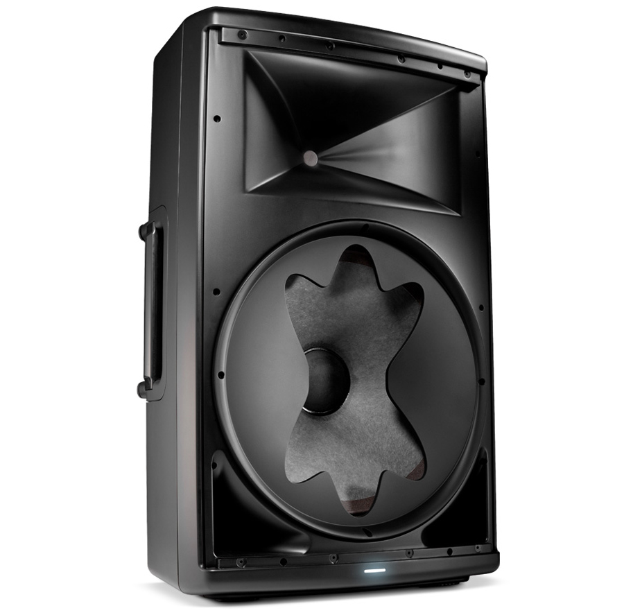

I see that mask as a way to widen horizontal response in the high end of the woofer. I guess that effect on spl and distortion is minimal.
More info http://www.jblpro.com/ProductAttachments/EON615_Datasheet_082014_CMYK.pdf
So, matching a 15" or 12" to a horn comes easier. Who will copy this first to diy?
It's not due to the SIZE of the waveguide, it's due to the SHAPE of the waveguide.
For instance, a 12" woofer will have symmetric polars at the xover. (This is because the cone is symmetrical.)
But a JBL PT waveguide won't. It's wider horizontally than it is vertically.
So the aperture widens the beamwidth of the woofer in the JBL EON, by changing it's acoustic size. It basically takes a 15" radiator and makes it behave like it measures about 7.5" wide.

Looks to me JBL turned a BR enclosure into a BP6 enclosure. Too bad they don't show the frequency response of the woofer by itself.
![thering-14.jpg](https://lh4.googleusercontent.com/-Of9hi4Cm2Uk/VH6TXuXXXEI/AAAAAAAAJwc/2q478VFjiIw/s800/thering-14.jpg)
From page 13, here's the response of my woofer with no chamber, with a chamber, and with a chamber stuffed with fiberglass insulation.
I can see why JBL used a strange shape; when I used a simple circular hole I got a big ol' peak in the response. I nuked that peak with fiberglass but it cost me some output. Since the peak is caused by geometry, the irregular shape that they used makes sense.
If you model the woofer chamber and port CSA you will see that the peak is a function of the area and chamber volume. The smaller the CSA the higher the peak. You can reduce peak with smaller chamber by placing a shaped volume filler plug. The JBL shape probably has more to do with it acting as a diffractive acoustic lens to change the directivity to match the horn than it does to get the peak to be smaller. The CSA on the JBL port is so big there is probably no resonance peak.
