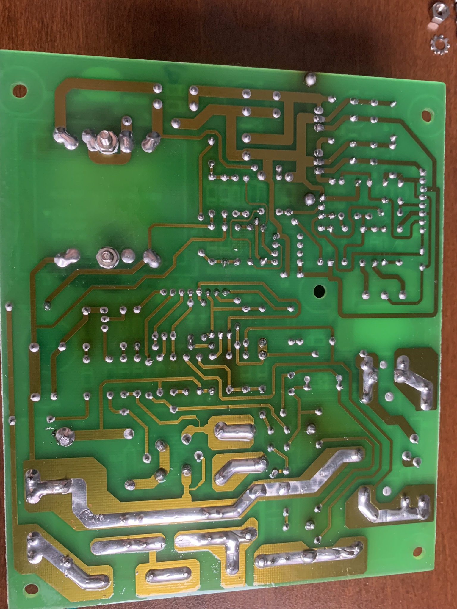

It died the other day. No idea why.
EDIT:

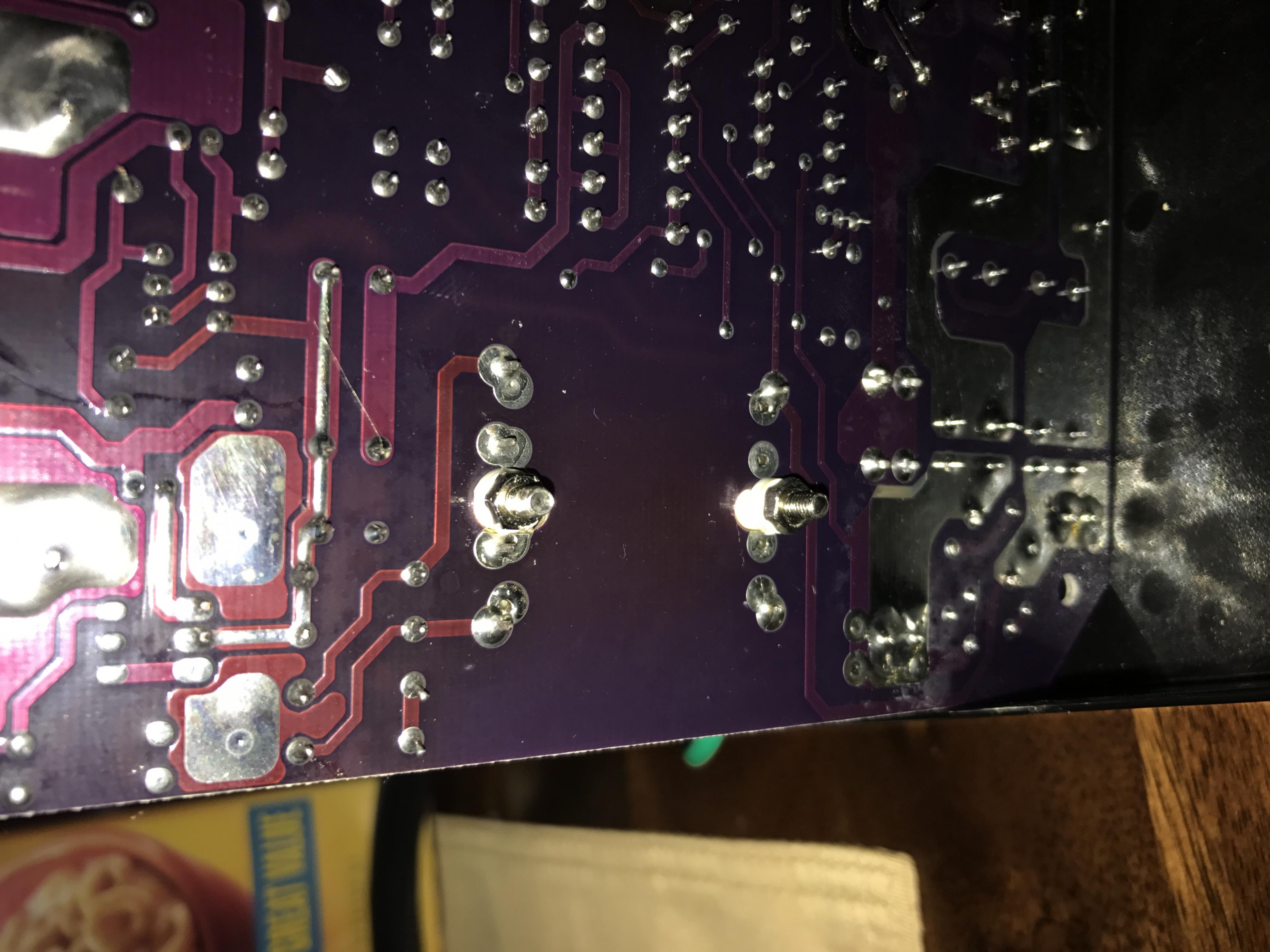

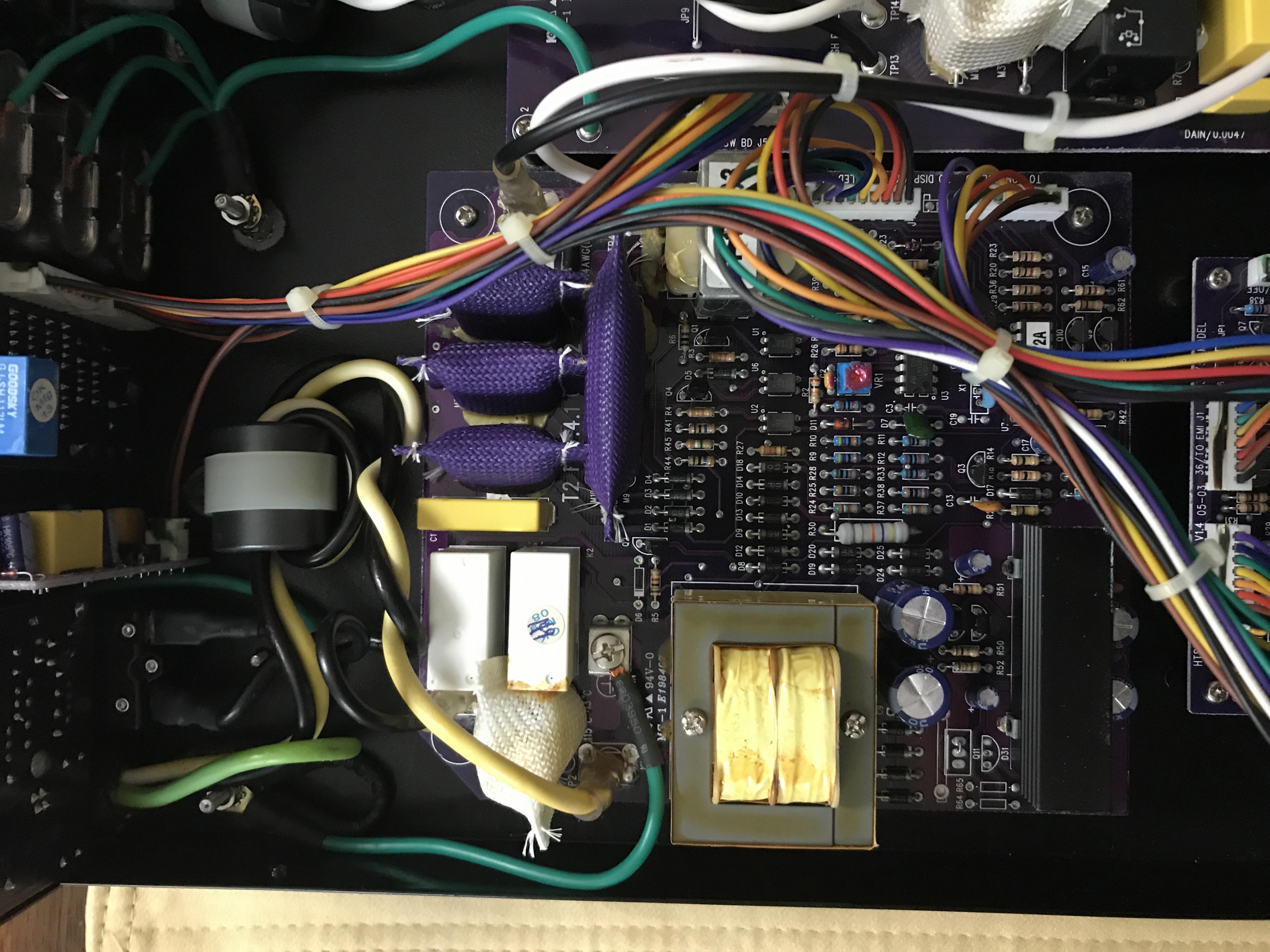

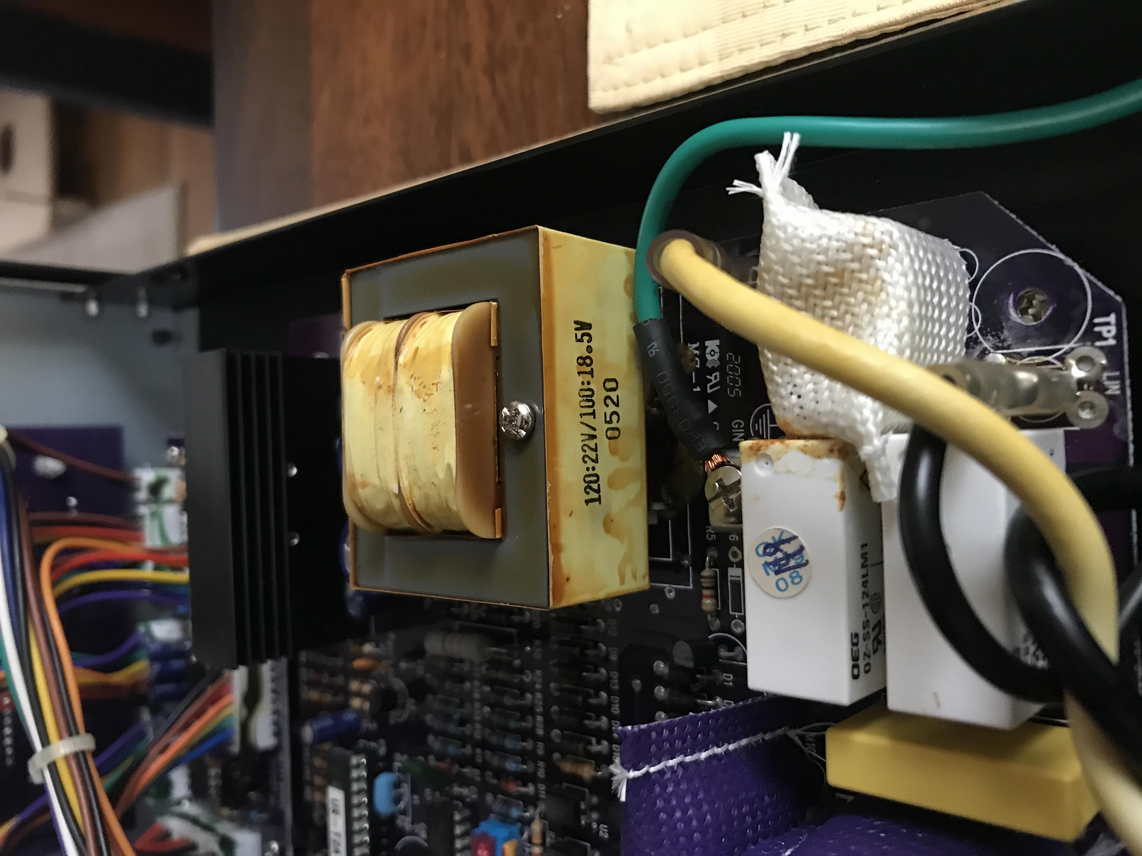

It was a bad transformer on the power board.
Had done some testing on it based on a repair video I came across for another 5100. There was no proper voltage at the secondaries.
Once I got it off the board I confirmed the primary had no resistance at all and must've failed internally.

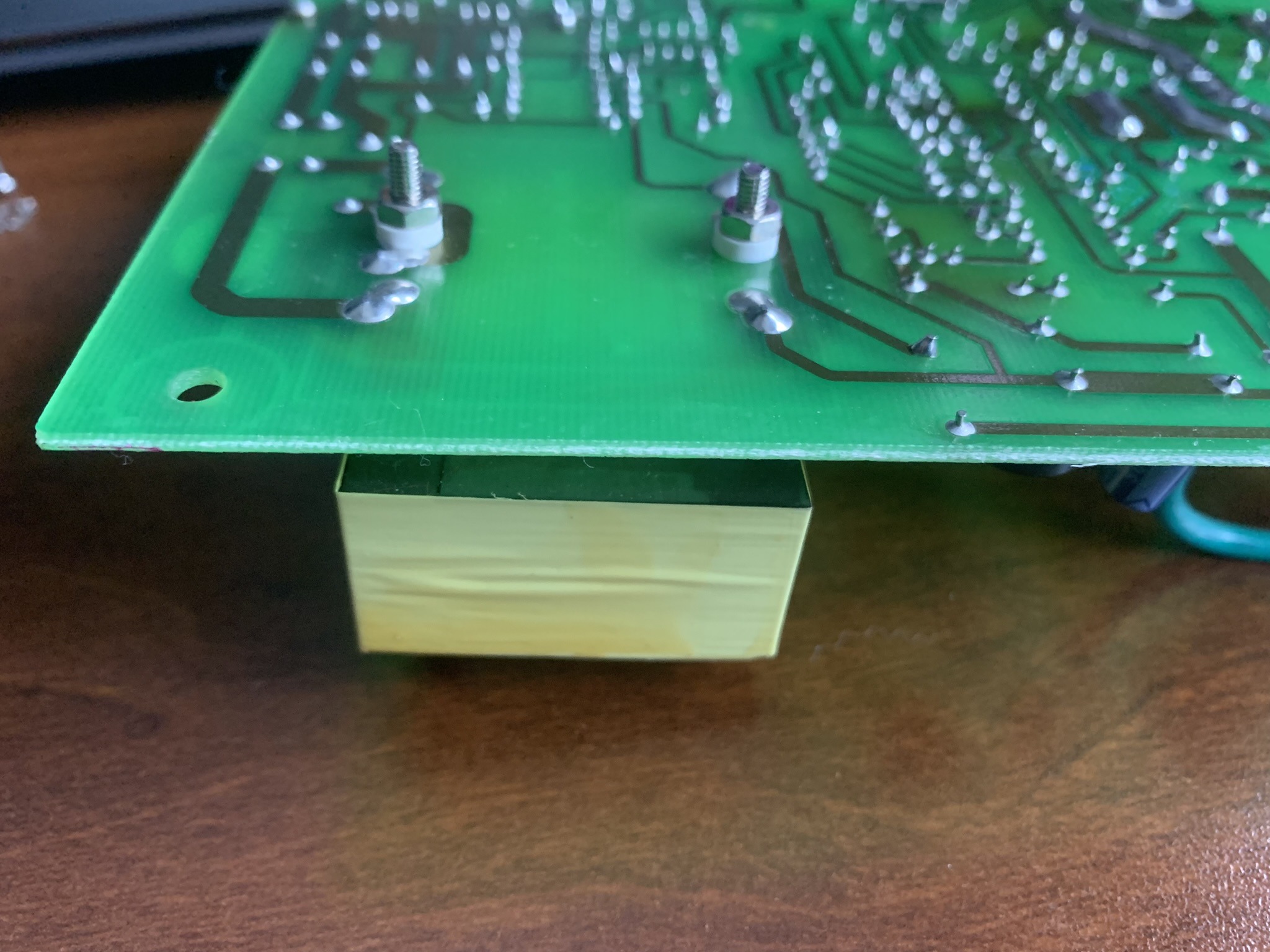

I replaced it with the smallest torroid I had lying around (120/2X15 80VA) that measured just short of 18V on the secondaries when I powered it up on the bench.
I hooked it up to the board mains inlet and wired the secondaries in parallel for a test. It fired right up.
I had to get creative and jack the board up with more stand offs so I could tuck the bigger tranny in underneath. Good to go.

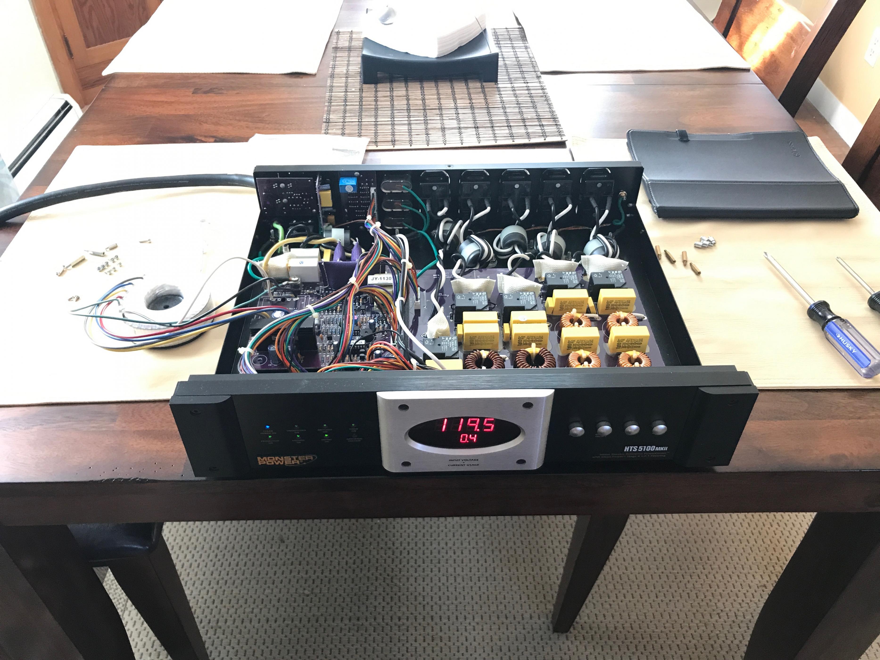

Pics
Rebooted phone and uploaded one pic at a time. Thanks.

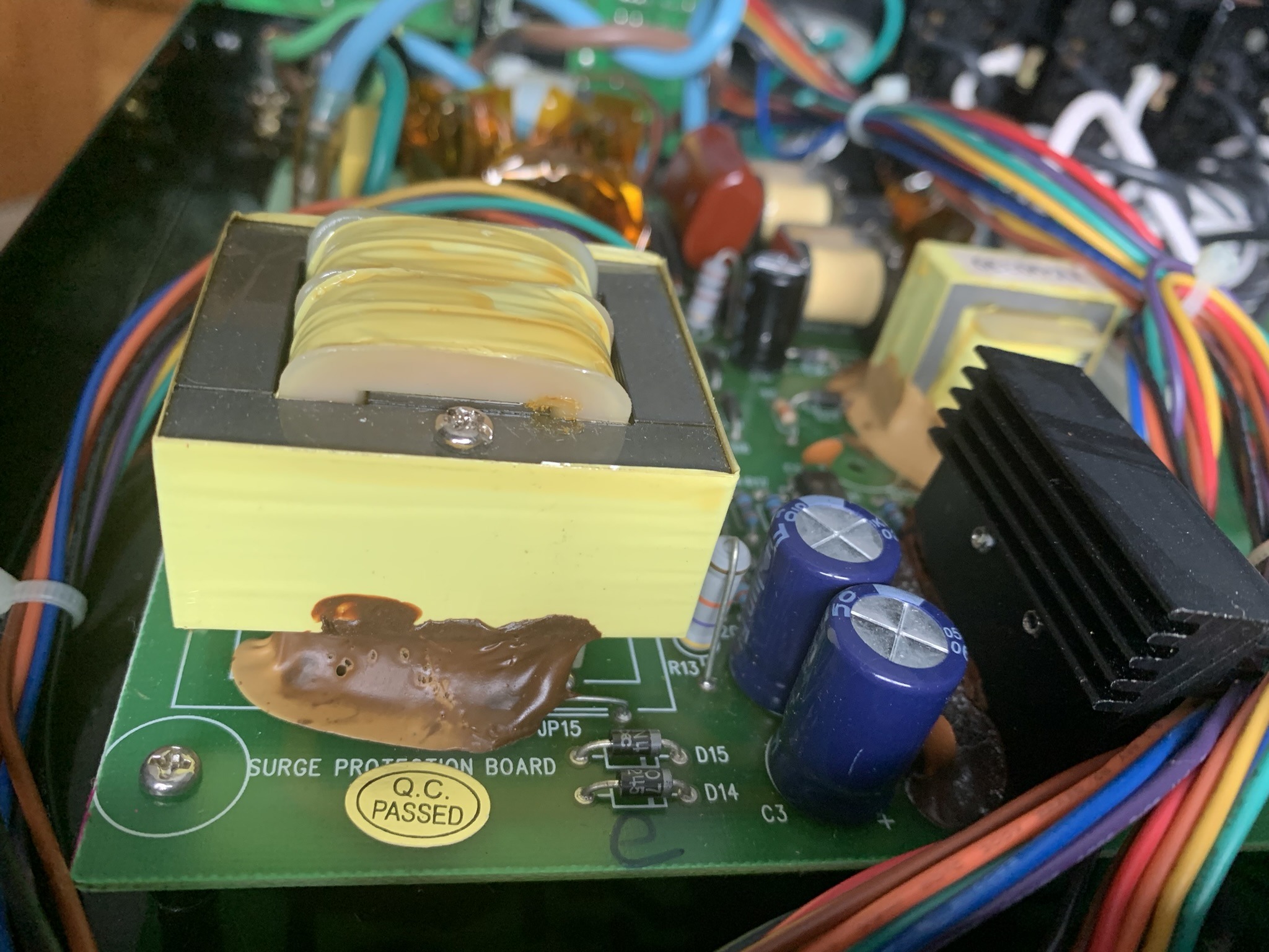

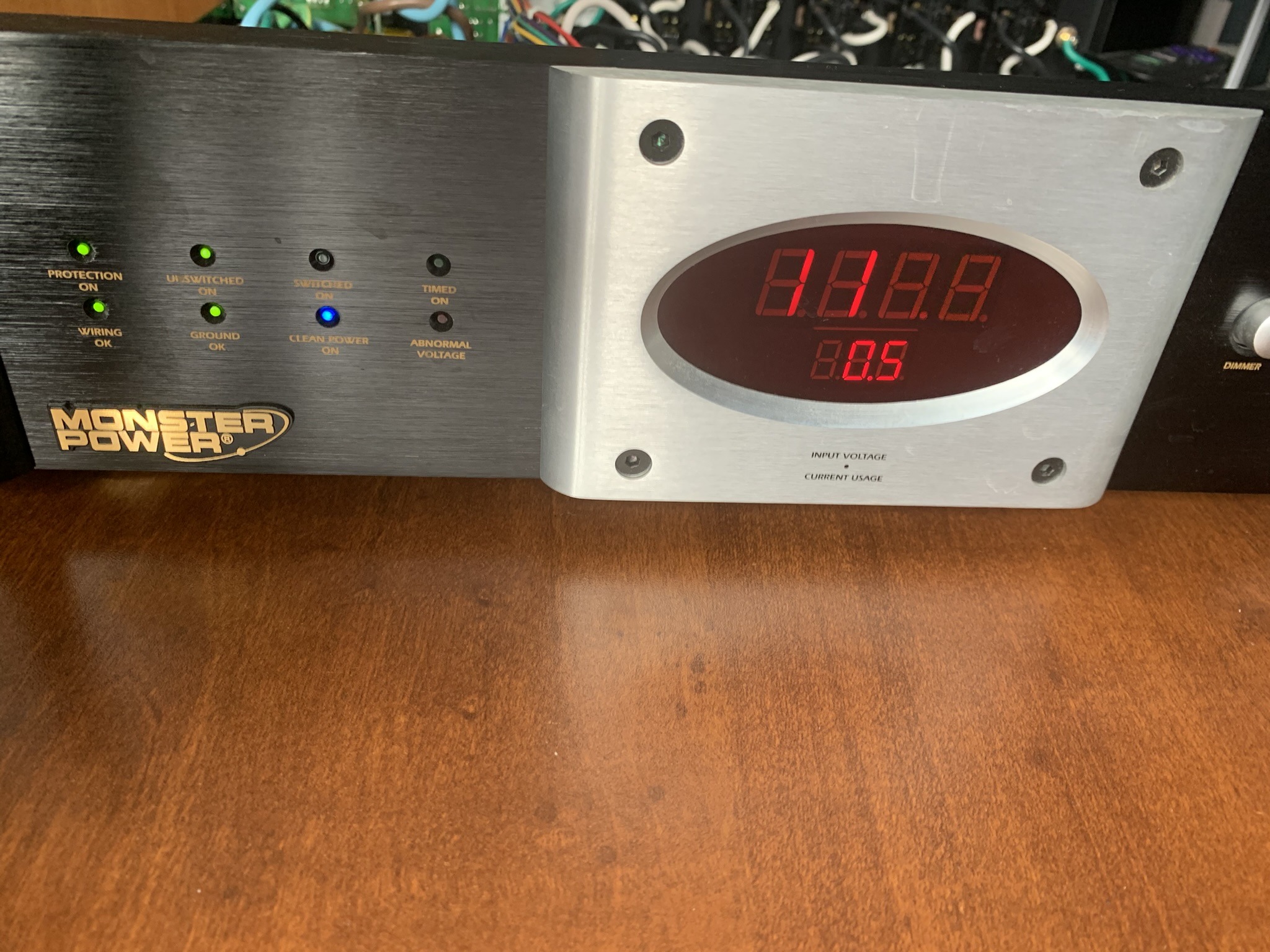

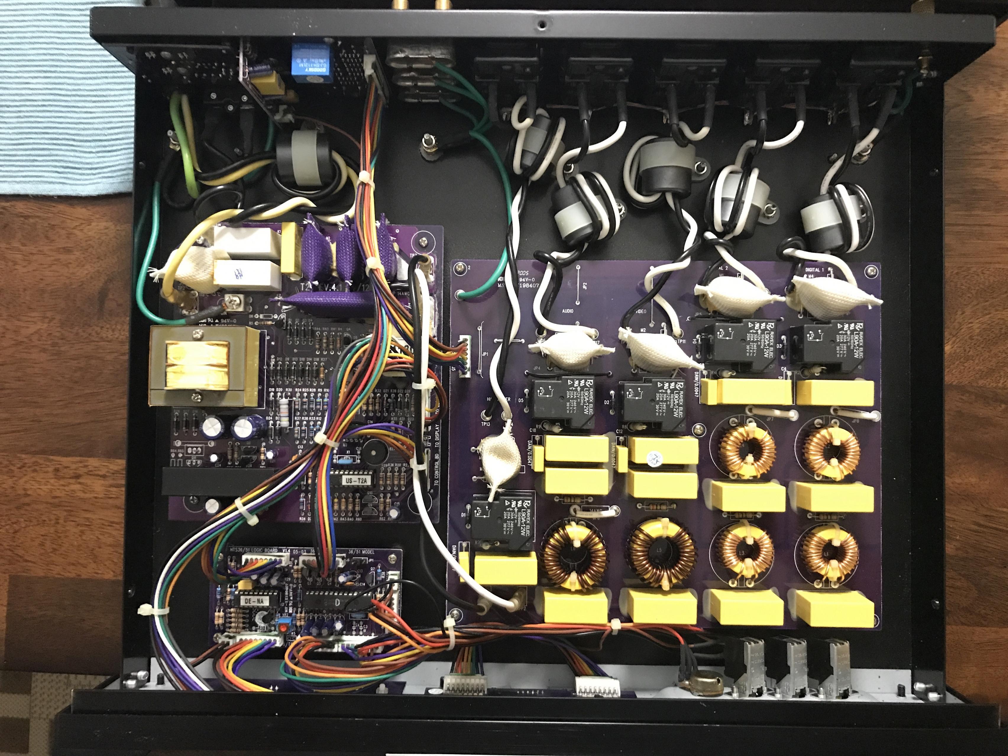

New to the forum, and long Shot here, but my HTS 5100 died over the weekend. The Front Panel still works and shows input Voltage and current draw, but nothing is being outputted for power. I tried resetting the 15a breaker on the back, which in the past did the trick, but this time it didn't do anything. I have only reset it 3 times in almost 18 years. The fact that this thing has last that long is pretty amazing. It looks like "Chromenuts" (poster above) replaced the large transformer in a unit, Wondering if his still had front display information with the bad transformer. Like I said, I'm new to the forums so I don't know how to directly contact him. The display does show 119-120v, My camera must have caught the flicker or change in digits. It looks like a the transfer is leaking, but I believe that is just a glue product as it's also on many of the other components. Any help would be greatly appreciated

Thanks! I did watch that Video and I will attempt to run that same test. Been awhile since I pulled out a transformer. I'm assuming I would have to remove it to test it?
I believe I had to pull it in order to measure across the primary.
Either way, you have to remove the board its mounted on in order to do anything.
You could try initially just flipping it out of the case to see where the line voltage connects to the primary do a visual inspection and take a quick measurement.
Checking the power coming off the first board with the transformer, to the primary board, it's outputting 120v to the 2nd board. Checking the power to each output, it's only at 8.2v-6.7v. So I'm assuming it's something on the send board causing the issue. Any ideas what to test?
You would be following the traces from your line voltage neutral and line input connections on the top of the board to the transformer and measuring impedance across where they connect to the transformer.
An open reading across those connections to the transformer would indicate a damaged primary winding as indicated in the video.
That was the issue I was lucky enough to have and solve by replacing my transformer.

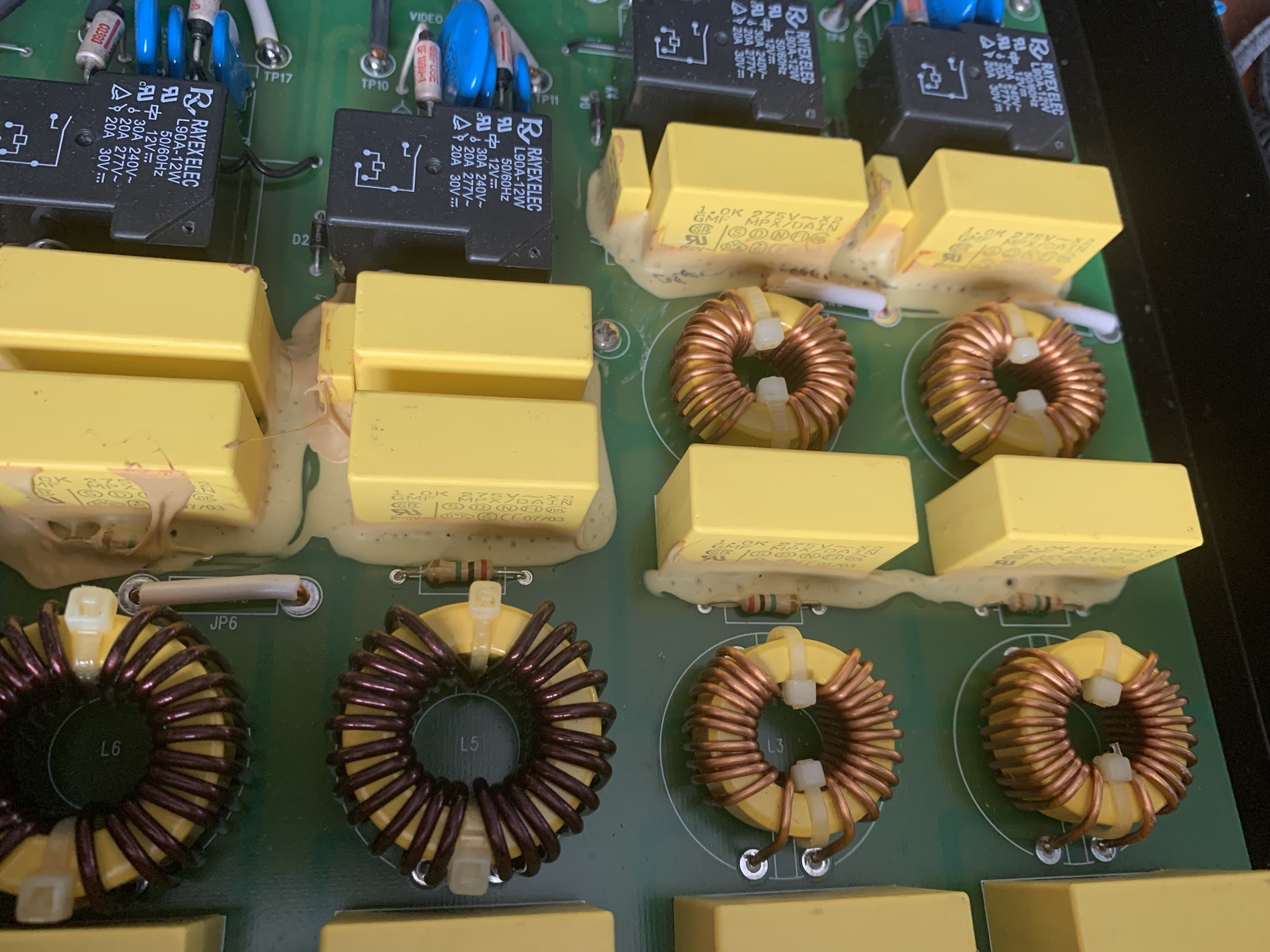

Well it looks like the transformer fix bought me another 5 years…my unit stopped working properly again today.
It powers up properly and after time delay it sends power to the outlets.
Shortly afterwards I hear the relay click again and power output is cut to all my devices.
Not sure how to trouble shoot this one.
Not even sure how old this thing is at this point.
Wondering if its a relay that’s the issue and how to test the theory.
