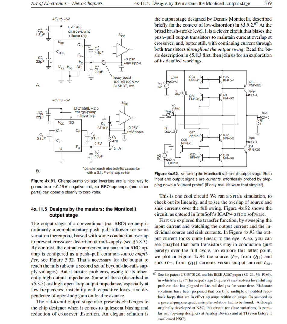

A while back I looked at Monticelli outputs to improve the efficiency of an audio power amp.
It's a common emitter circuit so it doesn't waste all the Vbe drops of the usual emitter followers.
This complicates the bias so the result is a little more complex.
The extra complexity is a reasonable trade off in low power op-amps and it's widely used there.
Probably not worth the pain in a conventional audio amp, where the few volts saved are a small fraction of the ~50 to ~70 volt rails.
Instead I looked to improve the efficiency with outputs that are floated by a switch mode power supply.
A kind of switch mode Class H, and it simulates very nicely.
But now the outputs only see ~5 to ~10 V, just like a modern, low rail V op amp.
So we are back in Monticelli territory.
If you can save 3 Vbe on each rail then they can drop from say, 7 V to 5 V, plus and minus.
The conventional circuit is ~40% worse power consumption, at the same bias.
And maybe the quiescent bias can be reduced too, for further improvement.
Which is the question for this post.
Anyone understand what limits the quiescent bias of a Monticelli output?
For the conventional emitter follower we have the Oliver criterion, 26 mV across the emitter resistors (more or less).
But for Monticelli there's no emitter resistors (more power saved!), and it's not clear to me how it's optimised.
Anyone have any ideas so I know what to try in Spice?
I have included the patent sketches to start the discussion, pretty obvious really
Bonus points for the sharp eyed who spot an anomaly.

Damn, almost 200 views and no one understands the circuit?

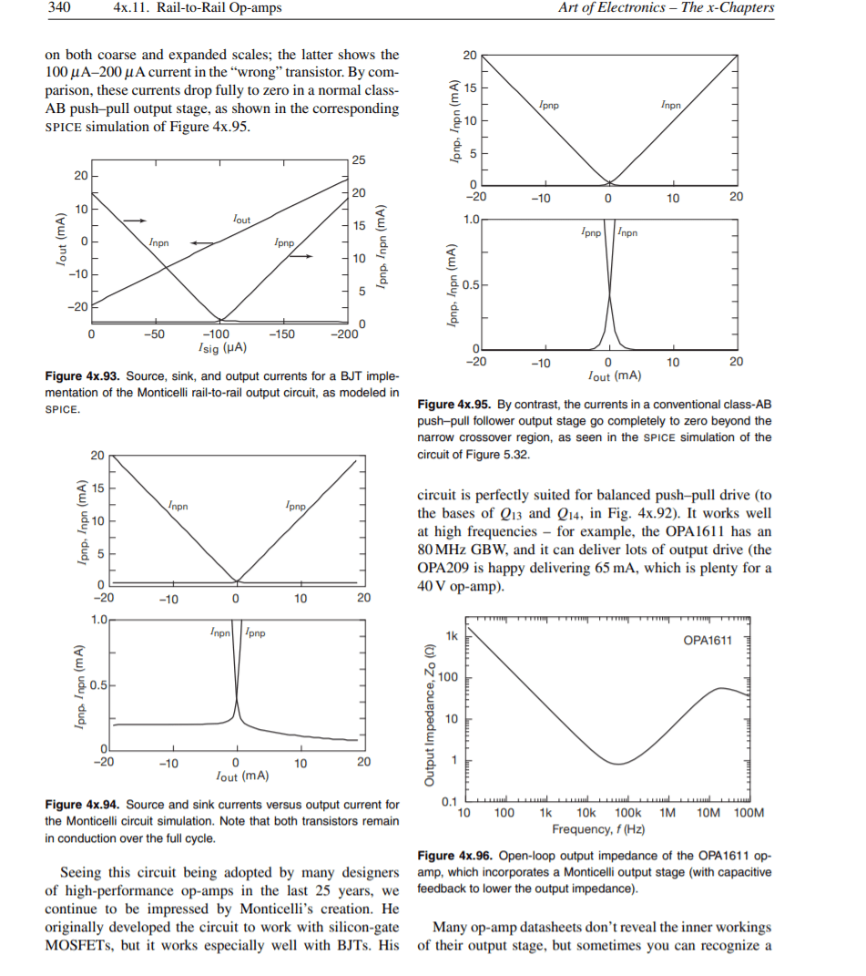

So here's a pic. from the OPA1611 spec. sheet, maybe makes it clearer.
Sub PPM distortion and runs at half the rail volts of an AD797. (also half the quiescent current, but that is at least partly to do with the low noise inputs)

Attached is a Thesis with analysis of the Monticelli OPS by LAKSHMINARASIMHAN KRISHNAN p46-51.
Cheers, IanH

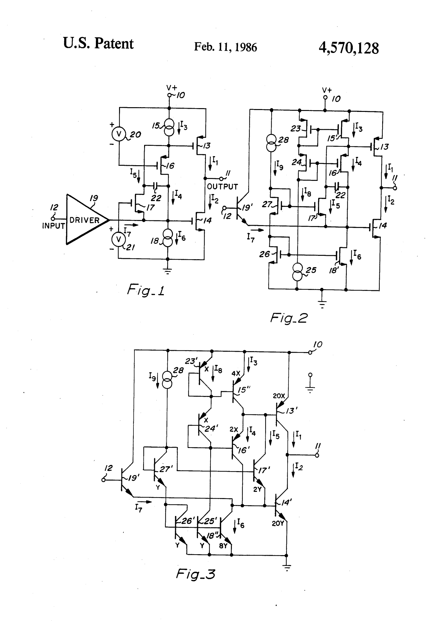

3 shows current mirrors. The currents are set by I9 and the ratios of device sizes (X, 2X, 4X, 20X for PNPs and Y, 2Y, 8Y, and 20Y for NPNs). That won't work with discrete transistors.
Hi Ed
The first picture shows the basic concept without any current mirrors, just current sources and bias potentials.
Current mirrors are a convenient implementation, especially in an IC but not essential, I think.
In any case, I don't think a currrent mirror implementation necessarily won't work with discrete transistors, there are plenty of audio amps with discrete current mirrors.
Not as well matched as an IC but perfectly usable.
Or it could be done with monolithic dual and quad transistors.
The outputs can't be done this way in a practical implementation, but it's similar to the bias spreader in a conventional amp, dissimilar transistors can be thermally coupled and work pretty well.
Do you see any specific problems?

Discrete transistor current mirrors are stabilized with emitter degeneration resistors and are often inside the global feedback loop. The circuit has multiple transistors that need to track. You can try to make it work, but I think that other approaches are more suitable for discrete transistors.

It's a nuisance that the quiescent current depends on more than one mirror ratio. You could make some ratios adjustable, as is done in conventional complementary emitter follower circuits, but then you need to adjust several trimming potmeters to adjust the quiescent current.
Maybe something for transistor arrays and ThermalTrak output transistors?
Discrete transistor current mirrors are stabilized with...The circuit has multiple transistors that need to track. You can try to make it work, but I think that other approaches are more suitable for discrete transistors.
Ed
I don't think this will be a problem, the current mirrors are not an essential part of the circuit, the first patent pic. shows the basic idea and there are no current mirrors.
The apparent current mirrors are just a convient way to implement current sources to set up the quiescent.
This realization came to me after I looked closely at the AoE X Chapters, the authors themselves have published it on-line so here's a copy to refer to as I try to explain.
Notice that the complementary transistors are scaled to match, so the NPN and PNP outputs (Q14 & Q13) are X20, the level shifters (Q3 & Q17) are X2, and so on.
EXCEPT the current sources Q15 & Q18...!
What's that about?
If you look at the patent (3rd circuit in my first post) it shows a similar mismatch and AoE have faithfully copied it.
But the reason it exists is to adjust for the emitter current of the driver transistor shown in the patent.
And the AoE circuit doesn't model that (just has a current source), so it's mismatched by a factor of 2 (X4 versus X8).
But it still works fine! A mismatch is detectable on plot 4x.94 below but the output 4x.93 looks excellent.
It is notable the way the 3rd patent circuit is done, with the bias chains in the top and bottom halves both set from the same source, with a real current mirror (25').
Whereas in the 1st, basic concept explanation, there are two independent sources.
Probably just an implementation example, for the reasons in the above post I don't think this is a problem, the ratios don't have to track perfectly.
