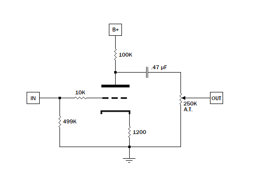

This ultra-simple circuit is what I've been experimenting with, and have had decent luck. Its designer has mentioned an optional cathode bypass cap, but I could find no exact value for it.Yes , 150V would be ok , but you need to chose right the schematic , operating point and components if you want something serious hi-fi not just a toy like the people who would run them at 12V![]()

Seems ok in principle , not very sure about the operating point , you should measure the plate and cathode voltages .This ultra-simple circuit is what I've been experimenting with, and have had decent luck. Its designer has mentioned an optional cathode bypass cap, but I could find no exact value for it.
Cathode bypass cap will increase the gain from let's say 10 to abut 13 . The value could be 100uF

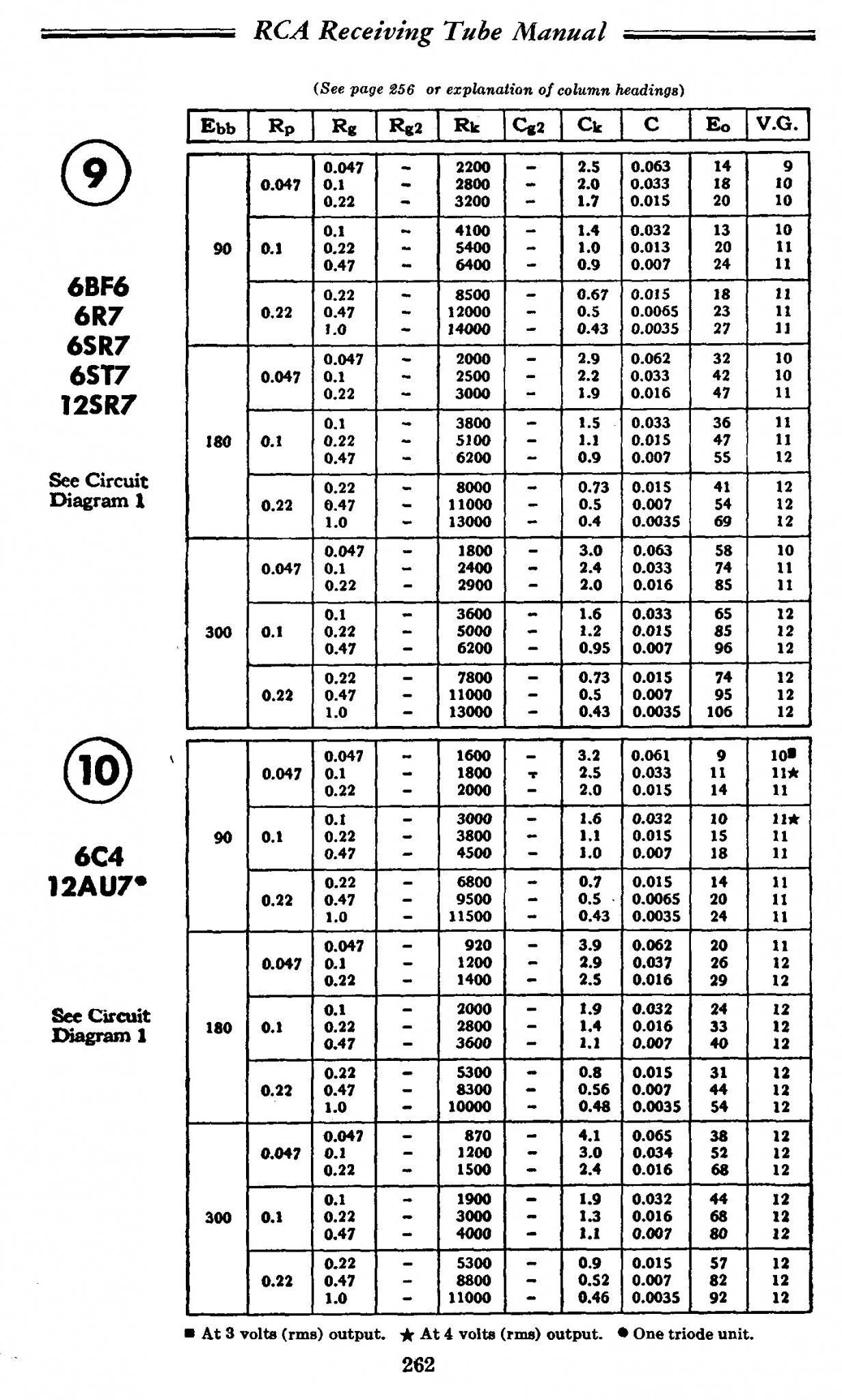

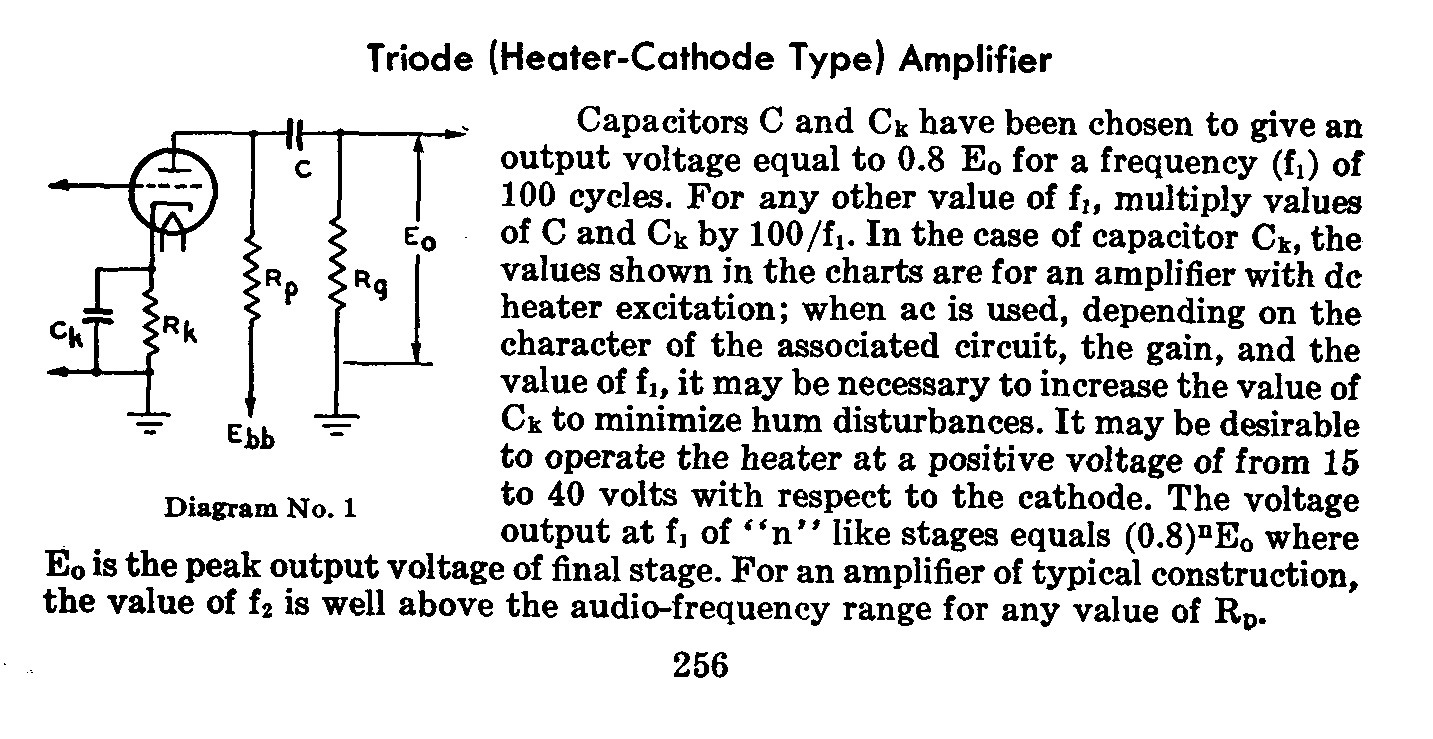

About the value of the cathode resistor in combination with the 100K plate resistor (see the schematic in post #4): Both RCA and Philips advise a higher value. I would think 2K2 or 2K7 is a better choice.
Oh good, a wealth of info there. Thanks.About the value of the cathode resistor in combination with the 100K plate resistor (see the schematic in post #4): Both RCA and Philips advise a higher value. I would think 2K2 or 2K7 is a better choice.
