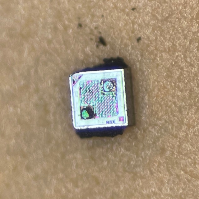

I recently purchased two lots of BF862 off of Ebay, from different sellers, and both were fakes.
Clearly visible under the microscope were the striations and gloss of the sanded & painted tops in place of the usual pebbled texture consistent with the other package surfaces, complete with sharp shoulders instead of the expected slight radius around the four edges. Laser markings were more inconsistent in alignment from part to part than they should have been - another subtle tell.
A few seconds under the flame of a butane torch, and the tiny die is easily liberated to the telling eye of the same microscope... the die look nothing like the genuine die photos posted elsewhere online:

I took another part out of the packaging today to photograph, so that people can see what a counterfeit / re-marked salvage part looks like.
The photos and details are posted on the other related thread here: Bf862 purchased on ebay - labeled as 2AW2?
Yes, I cross-posted to a second thread on this topic, hoping to increase exposure of this issue. It is a sad situation, but I think it's important to raise awareness and help prevent more people getting burned.
