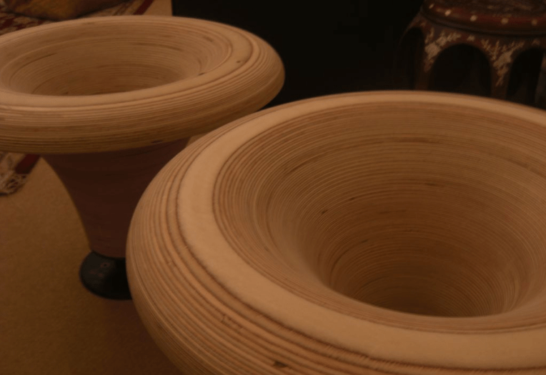

I don't think there is a better solution than a ~150hz exponential horn married to a Large format top shelf compression driver. The most potent factor of SQ I have found is directivity. The room messes up SQ more so, than the average well used mid range. The best way to combat the room is to increase directivity. A large horn has dimension on its side to bring directivity into a lower spectrum, and the wall angles to increase directivity. It has high sensitivity/efficiency lowering heat and excursion in the motor. In combo with a large format, high quality compression driver using a light but rigid diaphragm of low coloring, I'd bet there is no equal.

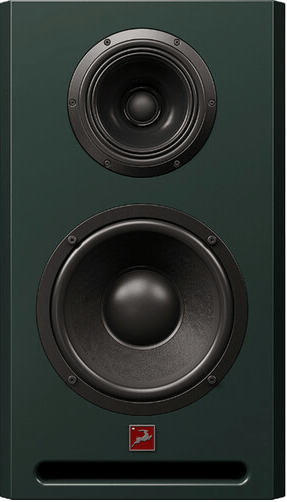

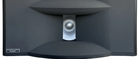

If there were an equal, I'd bet it look like this

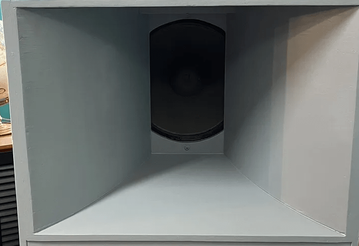

or this

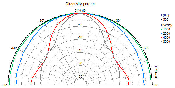

a woofer within a waveguide...

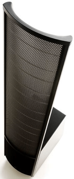

The ESL has to be mentioned because I see it turn up in so many peoples list of top best speaker ever heard.

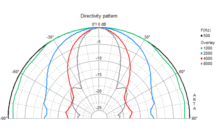

And the 3" dome in a 6" waveguide has to be mentioned due to its reputation
The only thing that mess me with the horn but their compexity to get rigth, is it needs to know your prefered listening distance to choose your mouth overture degrees.
The farer the distance the less overture to avoid reflexion ? How you knnow you need 60°, 90° or 110° ?
The ESL are ultimatly clear but people complains about dynamic lack. Many Martin Logan to avoid huge surfaces had XO around 500 hz with a normal woofer (and DSP now to get better seamlessy mariage).

Reducing the radius of the waveguide would lower SQ. A 6" radius can mate with a 1" with a 2-KAreducing the radius to met a tweeter
People used to like a lot bi-radial with 110 to 120° horizontal at home, because they said the 90° lacked a little of air and soundstage. But I really dunno.

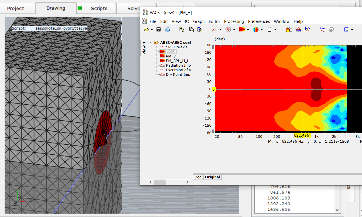

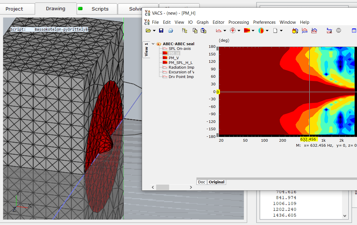

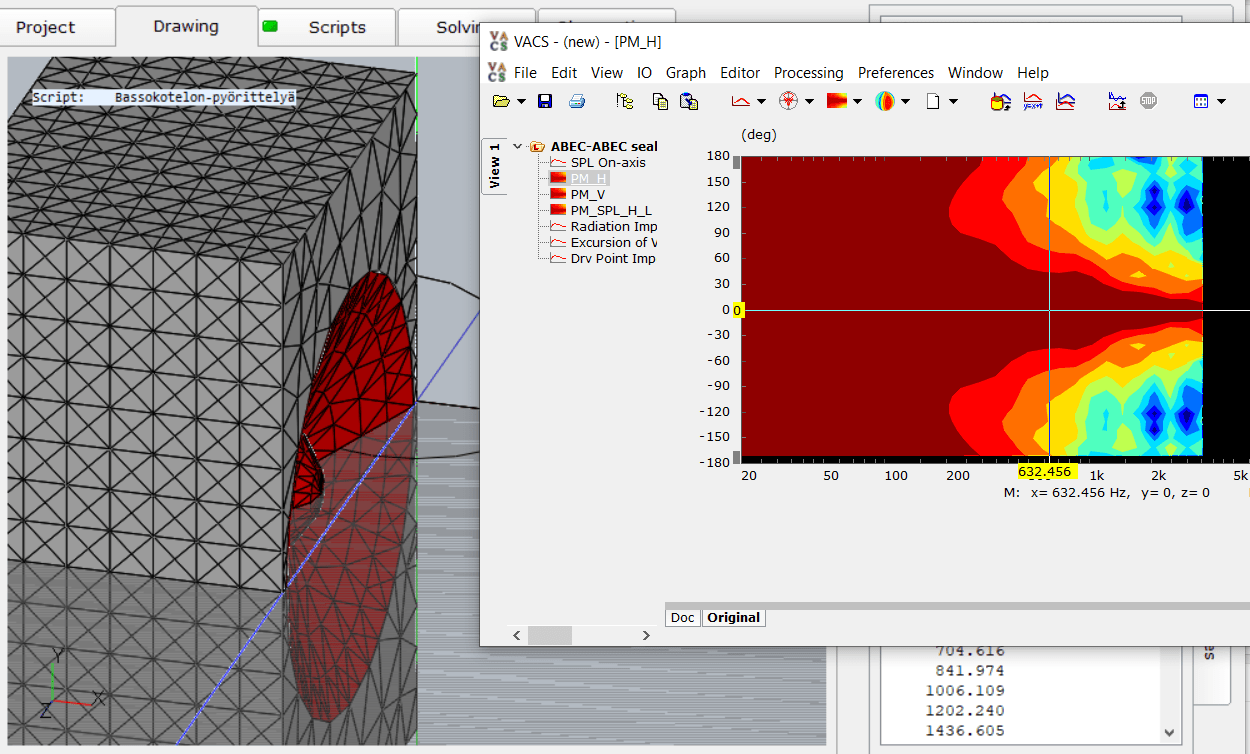

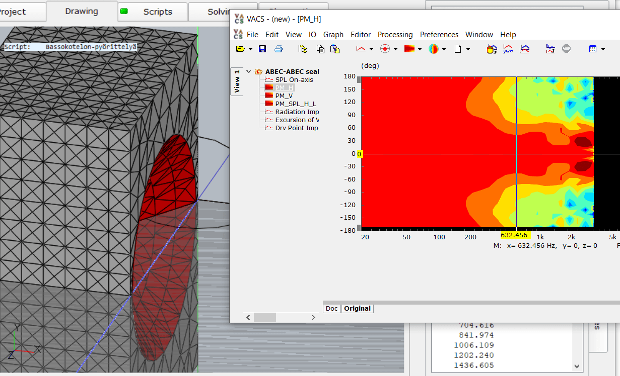

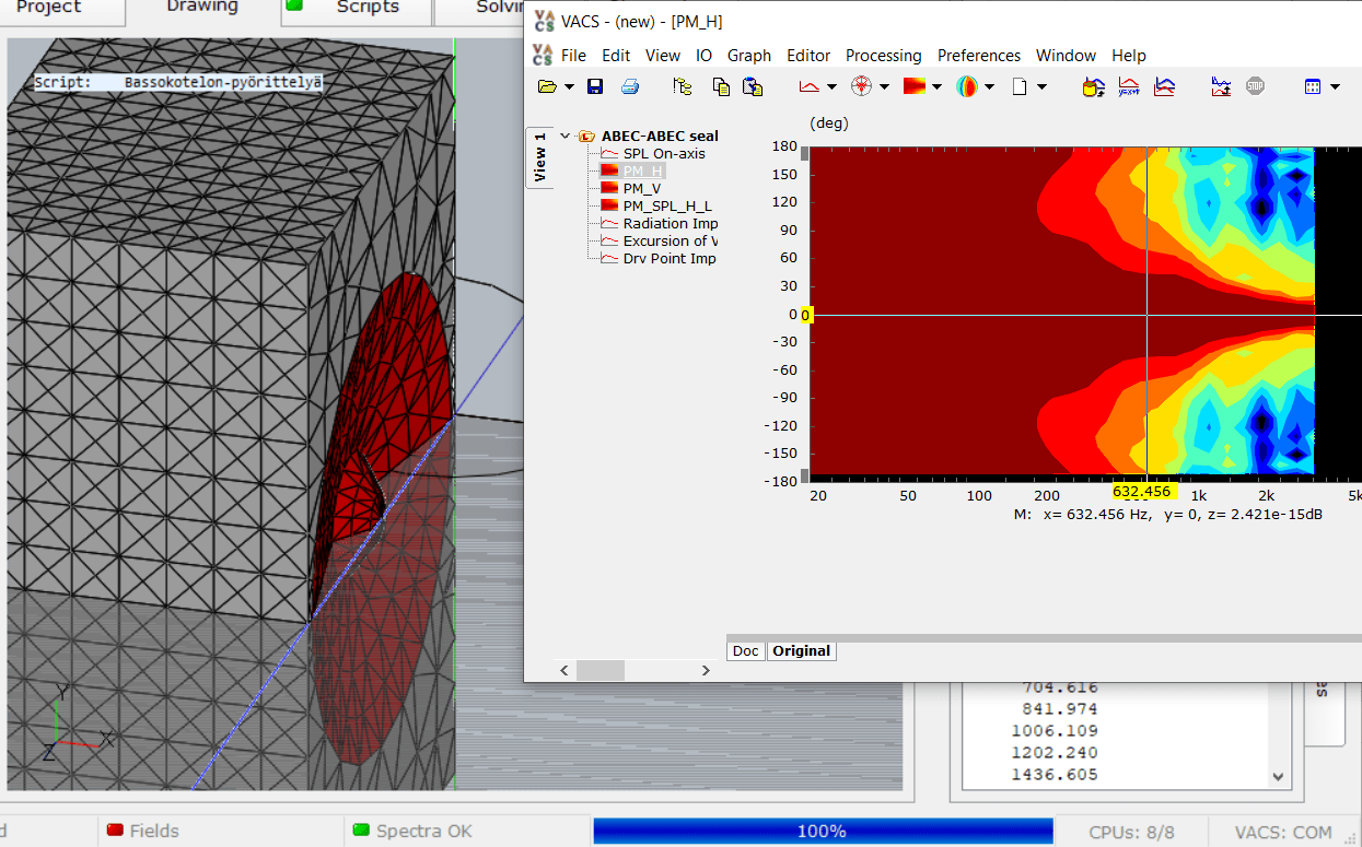

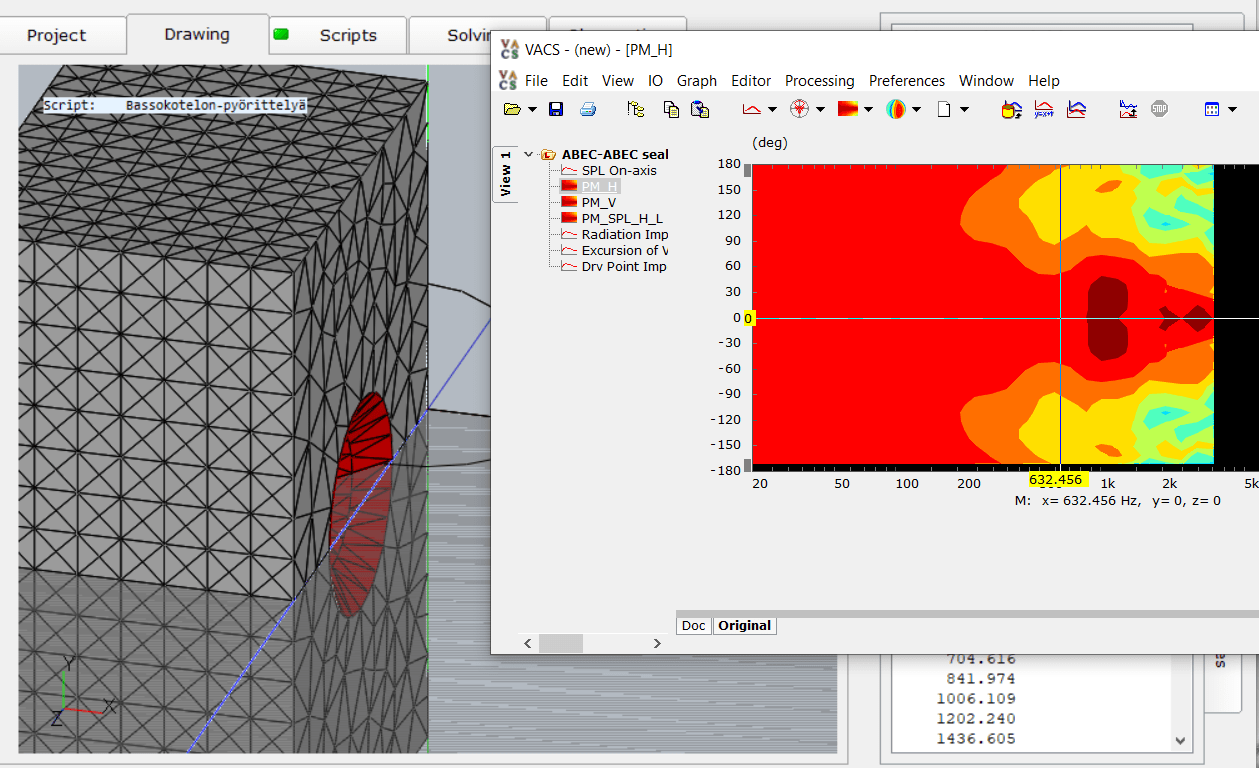

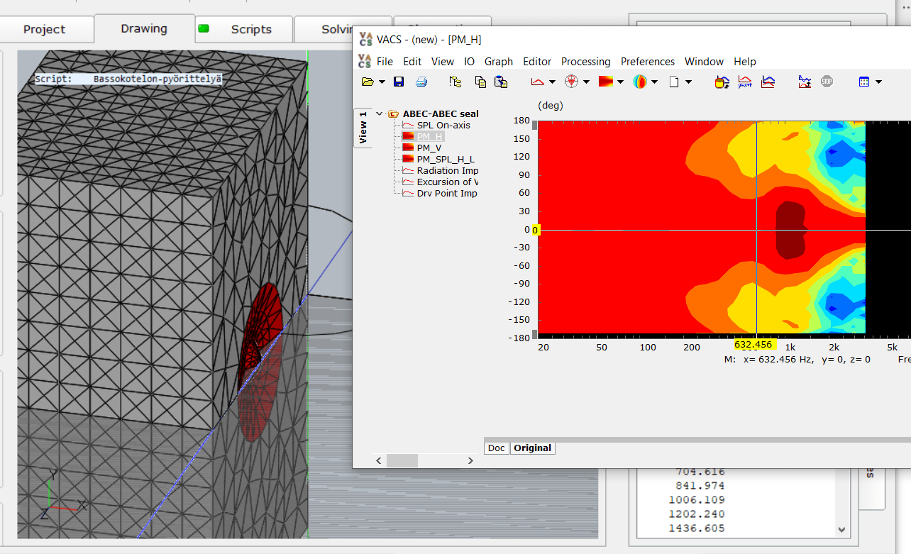

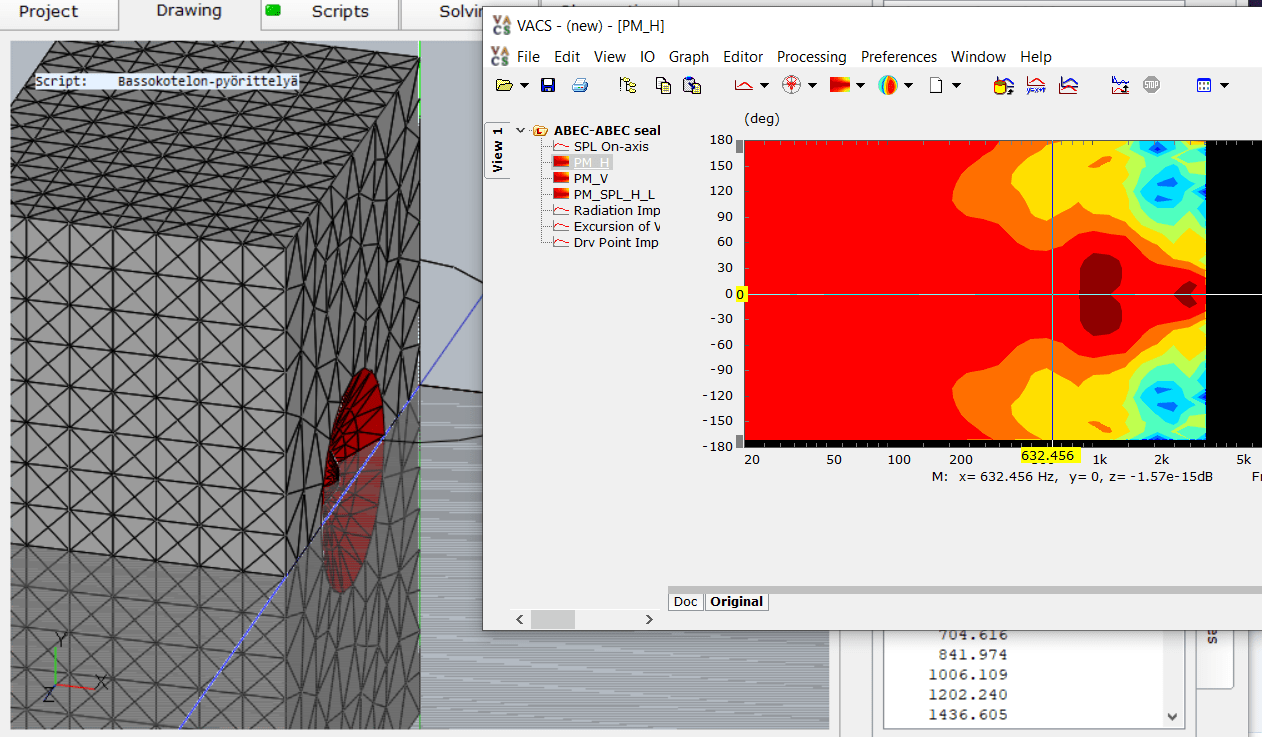

Here some simple simulations to illustrate effect of cone depth. It's deducible that the deeper the cone, the more there is "widening" at some frequency related to the dimensions.
~15" ideal woofer on a box, depth of cone varies. 380mm diameter, dustcap diameter 100mm, dustcap height 25mm:
![cone-0mm-deep.png cone-0mm-deep.png](https://www.diyaudio.com/community/data/attachments/1150/1150254-0e46e6d35af9e0d494cb3d0006ec09f9.jpg)
![cone-25mm-deep.png cone-25mm-deep.png](https://www.diyaudio.com/community/data/attachments/1150/1150253-146ea045c65974ca87fb153593365854.jpg)
![cone-50mm-deep.png cone-50mm-deep.png](https://www.diyaudio.com/community/data/attachments/1150/1150255-6a826700ca0053fd76166af97746871b.jpg)
![cone-100mm-deep.png cone-100mm-deep.png](https://www.diyaudio.com/community/data/attachments/1150/1150252-1447e0204717d85ec199ea6dd686fb7e.jpg)

As you see on the smaller driver, the effect of various cone depth is quite high frequency, where the driver perhaps already beams. If curvature of the cone was changed, the effect would be less as the change in physical size/shape is less. Breakups and such would also lay down some effects, these are also usually somewhere shorter than cone diameter wavelengths. Also, as the baffle size stayed the same, features in lower frequencies stay the same. Simplified, big physical size features make effect to low frequency, and smaller affect higher frequencies. As driver diameter is physically larger than features on the cone, it makes more difference than features on the cone. It would also define (set the stage for) beaming frequency, while shape off the cone adds ripple to it, which could be good or bad for DI around probable crossover point.
Buying few different drivers and then measuring them would show if there is much difference between in reality, and which one works better for measurement and which one sounds better for ear.
ps. Looking these graphs, it looks like good number for beaming could be just driver diameter. The 15" example, 380mm, is about 1kHz wavelength. 190mm of the smaller cone is roughly 2kHz. Both have significantly less sound going behind the box (so toward the edges) for example, which could be called beaming.

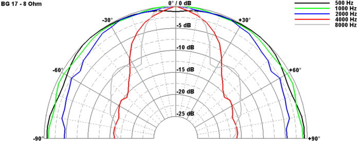

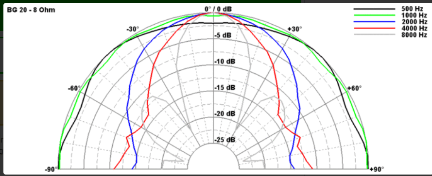

ps. I tried to find some datasheets with some directivity data, not too many have any directivity plots available but here is some from Visaton. Their b200 and BG20 drivers, both 8", and have very different DI on high frequencies. Cones are roughly 2kHz in diameter, and seem to have relatively similar DI at 2kHz, whilethere is quite a lot of difference at 4kHz and even more at 8k.
Here is visaton BG17 and 13, which are ~6" and 5" versions of the same lineup I think, for comparison.
![8inch-manufacturer-plot-3.png 8inch-manufacturer-plot-3.png](https://www.diyaudio.com/community/data/attachments/1150/1150272-e6a59d25cc525ff6d4fa75ce8ef97fb2.jpg)
![8inch-manufacturer-plot-3-2.png 8inch-manufacturer-plot-3-2.png](https://www.diyaudio.com/community/data/attachments/1150/1150271-f679b9102ebb980fdf1dd864edfe33c5.jpg)
![BG_17-8.gif BG_17-8.gif](https://www.diyaudio.com/community/data/attachments/1150/1150277-d99e90406609225d6875f8e7c7cb78fc.jpg)
