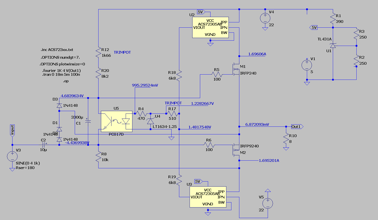

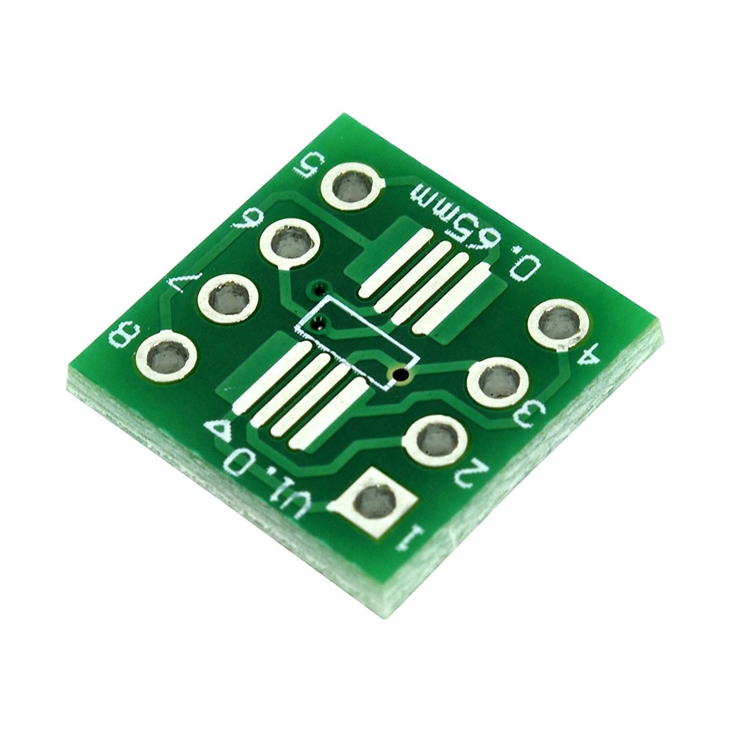

tnx to imdra , we came to (it seems) glorious idea of Iq sensing , with handy Hall effect IC
it is ACS723 family of chips

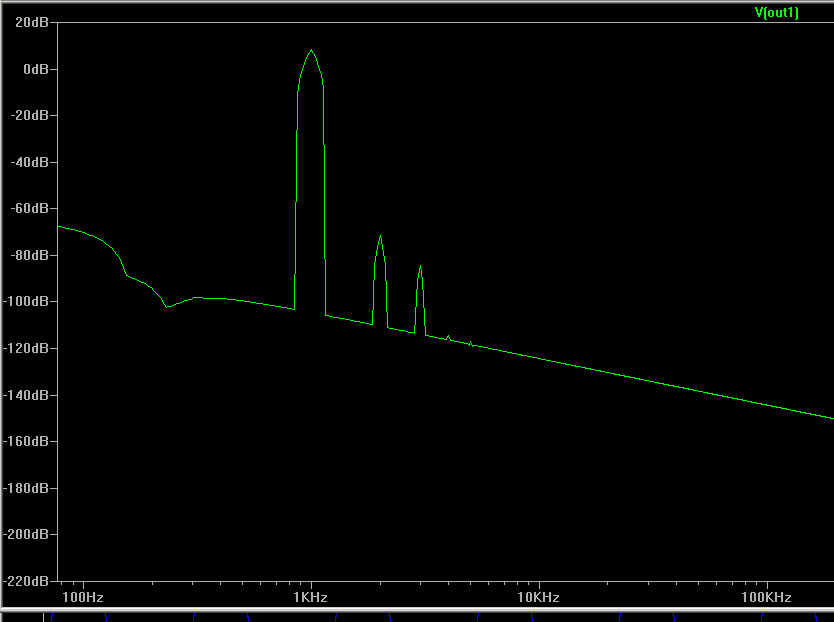

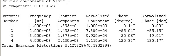

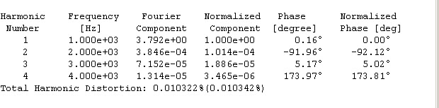

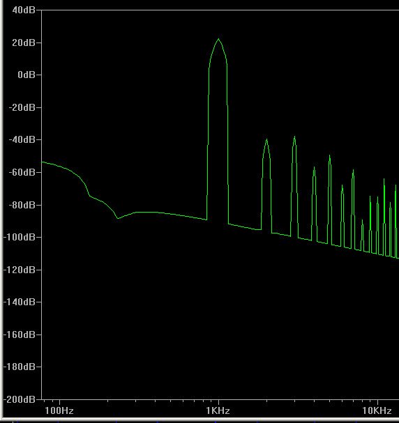

last few nights I was playing with sims and came to few conclusions :
-Babelfishing XA25 - swell , can't talk ;
-M2 iteration , called by Mighty Moi M25 .... :
-8Vpp/8R - better THD than M2
-38Vpp/8R - even more better than M2
-40Vpp/8R - wakoo more better than M2
-in heavier loads ( 4R, 2R) difference even greater in favor of M25
.......... now , none of Poor Greedy Boy DEFiSIT substitutions* is not having any benefit of using Hall IC, simply because I needed source resistor in best position , as tool of shaping THD spectra ..... so nothing easier than to implement direct optocoupler biasing scheme
*means LuDEF amp, SEF amp ; now I realized that I didn't check thoroughly SJDP DEF amp and 2SK180 DEFiSIT
will do that later .....

though ..... I meant to ask indra - did he found some bigger cased buggers , with same characteristics .........
preparing one short list of special parts , to order ...... none of them being in regular stock of my usual vendors
as soon I finish that list , with ACS buggers too , I can start count 2 or 3 weeks to delivery

no 2SK180 DEF , no SJDP DEF, with ACS chips
btw ....... made sanity (sim) check of 2SK180 based DEFiSIT , made with ACS chips
nada - not big enough (voltage) window between gates of 2SK180 and IRFP9xxx to keep current in sane bracket
same case with SJDP
so , conclusion - in this very moment , ACS chips are extremely interesting for wakoo XA25 approach - pair of mosfets sans source resistors , be it oldies or pucks
I really hope reality will follow simulation
same case with SJDP
